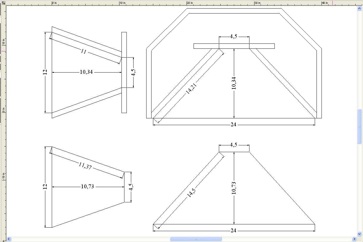

Hi Wayne.
I wanted to make a cad drawing of the midhorn, to get the angles on the sides.
Just bought a new tablesaw, and want to try to minimize the sanding a bit, by cutting the angles on the saw.
But when I make the sides 14.5" long, the top and bottom becomes 11.37" long. And when I make the top and bottom 11" long, the sides become 14.21" long.
Which one is correct, can you tell me the exact depth of the horn, that way I can draw it up using depth instead.
I have included a picture of the two drawings.
Regards
Kim
