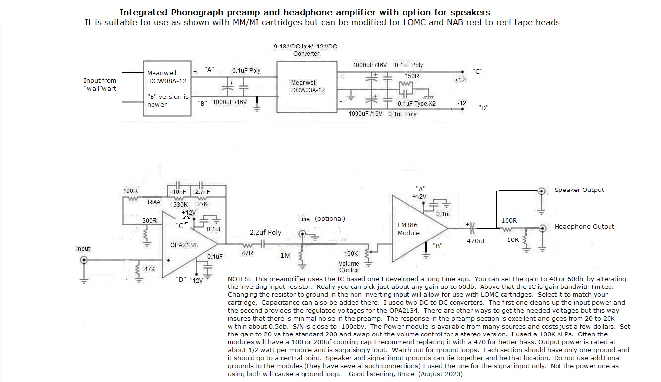

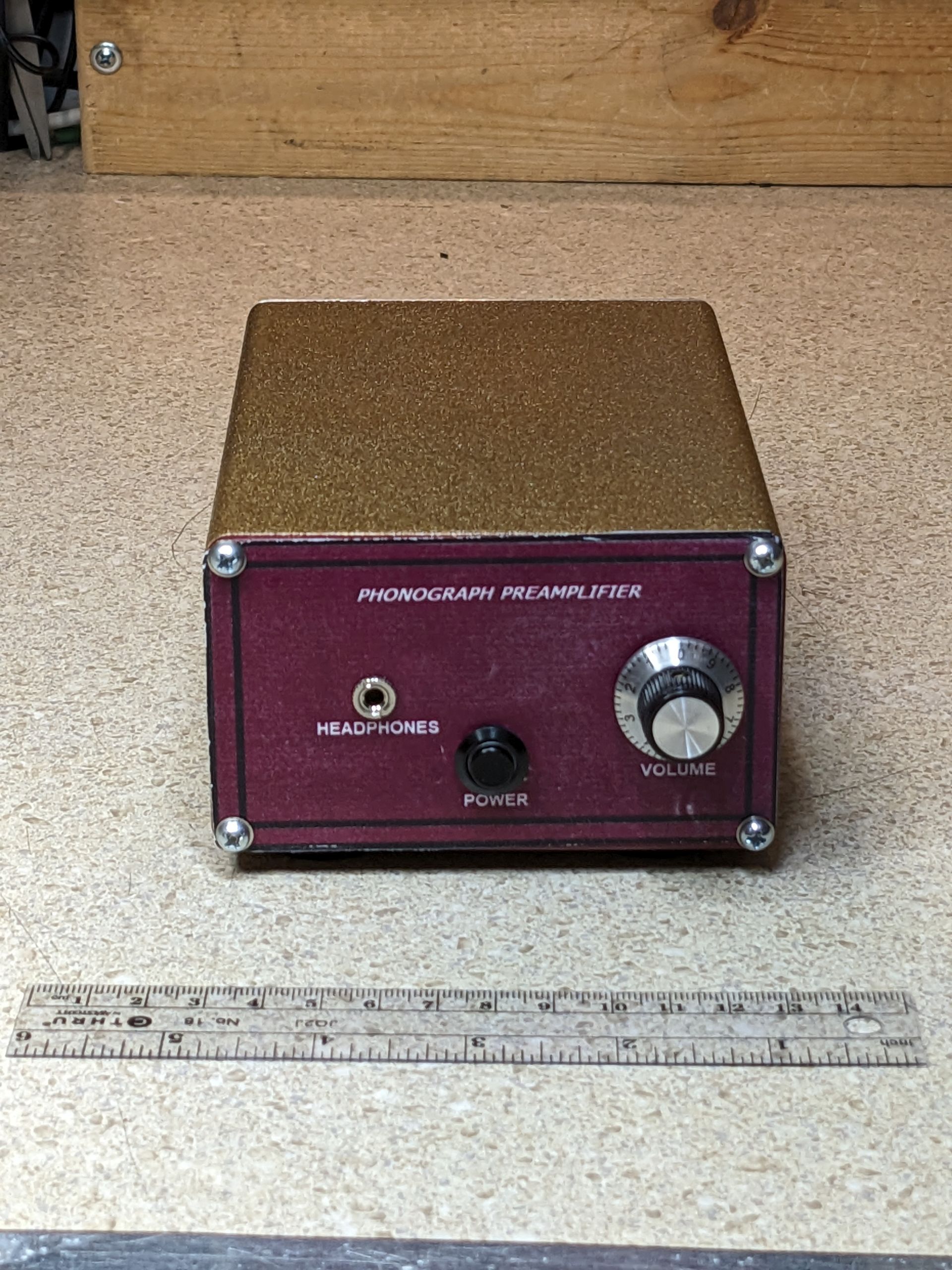

I really didn't need this so it is just a fun project. Very clean phono preamp paired with some small amps. It is somewhat modular as the amps and power supply are modular. The power supply is overkill for sure...but with phones any hum is really bad news. It can drive speakers as well and is rather loud. About 1/2-1 watt per channel. Cheap to build as well.
