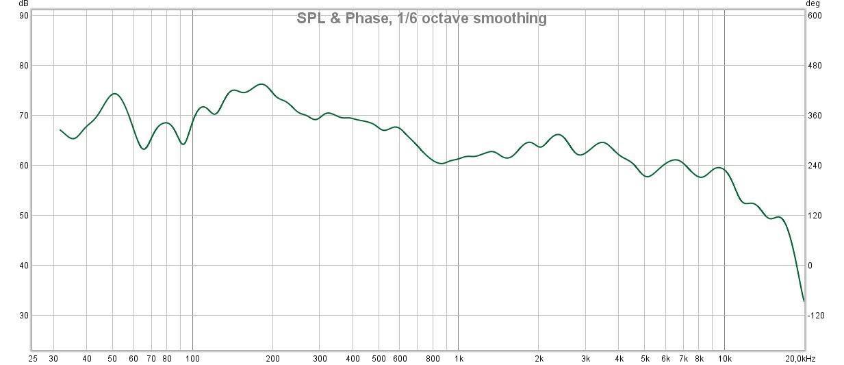

With REW software, I measured the differences (from listening position). Red is before EQ, green is after EQ:
/forum/index.php?t=getfile&id=2269&private=0
You can clearly see the differences. You can also see that some signal is lost in the 60-100hz area. I could tweak it with the audyssey app, but I didn't purchase it yet. But overall, it just sounds better.
