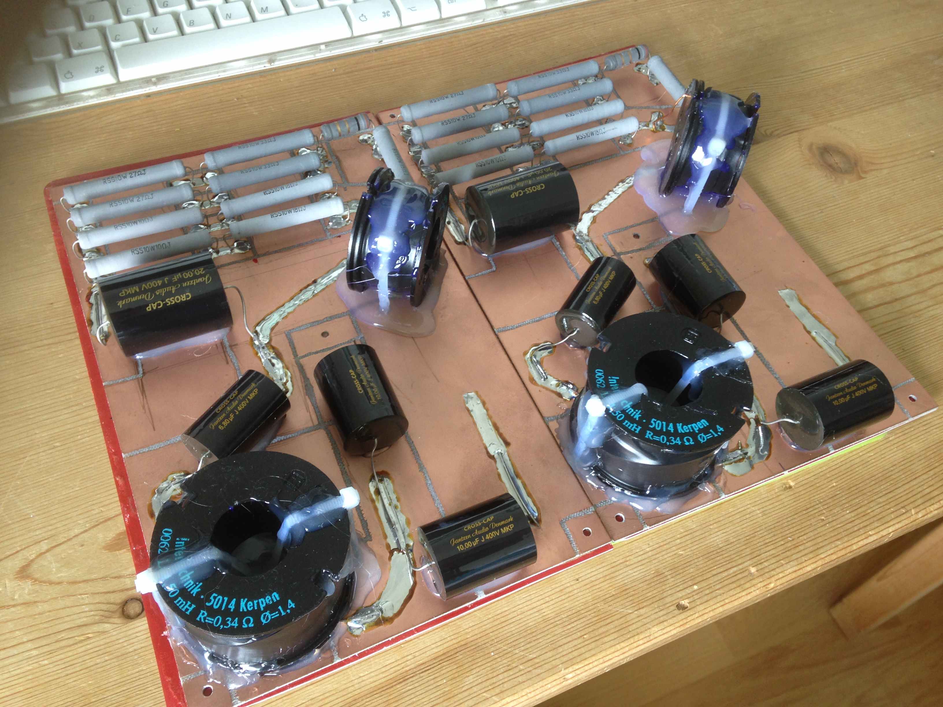

So I finally got some time and spare money to start collecting parts for 3Pi speakers... crossover is made with left-over PCB's I had with good/standard/whatever quality parts I could find for reasonable price: Jantzen Cross-Cap's and Bigger gauge coil for the woofer (1,4mm wire) and Metal-film non-inductive 10Watt resistors. I'm still waiting on delivery for 100Watt 8 Ohm dummy load resistors to be mounted off-board as per drawing.
For the speaker components I wanted to start with all-standard Eminence - but I got lucky and found a good deal on summer fire-sale and got myself B&C DE250 for just 25.- Euro more than PSD2002 per piece.
For the woofer I wanted to jump right on the upgraded part but it's price in Europe is just silly high (300,- Euro per piece) so I settle down for stock part Delta 12LFA.
Now that the funds are exhausted, I have to wait till next month to start working on the box itself, I will surely post many pictures of the build...
