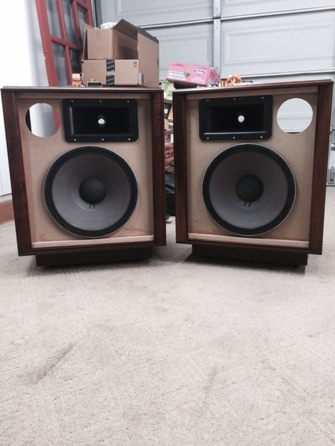

Thought I would share my 4pi build. Although I am using the 4pi crossover & recommended drivers I am using some vintage Barzilay cabinets. Stuffed the cabinets come in at 4 cubic feet.
I started by cutting the baffle which is 3/4" mdf.
index.php?t=getfile&id=1692&private=0
You may notice a frame around the baffle. This was needed to install speaker cloth.
index.php?t=getfile&id=1693&private=0
Making a stereo pair I chose to build them mirrored.
index.php?t=getfile&id=1694&private=0
I tried to keep my build as close as possible to to Wayne's 4pi. The bracing and port placement are based on the 4pi instructions.
index.php?t=getfile&id=1695&private=0

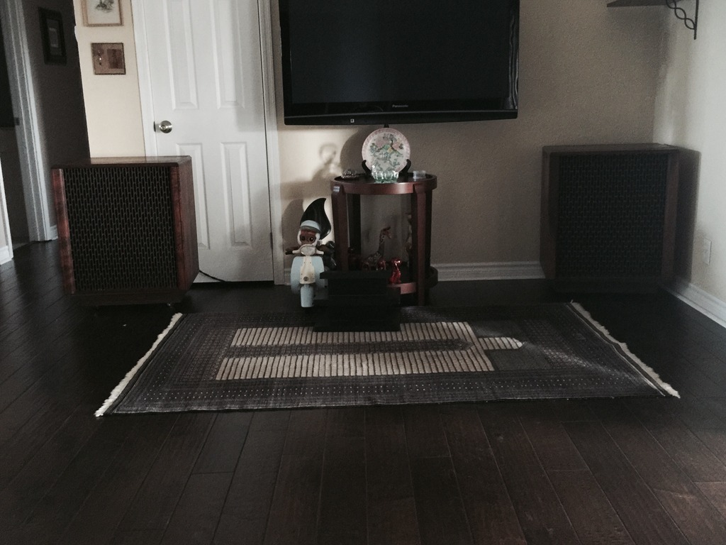

Even though they are not finished I have them set up, playing music. Sound great! If they improve once finished all the better!
index.php?t=getfile&id=1697&private=0
