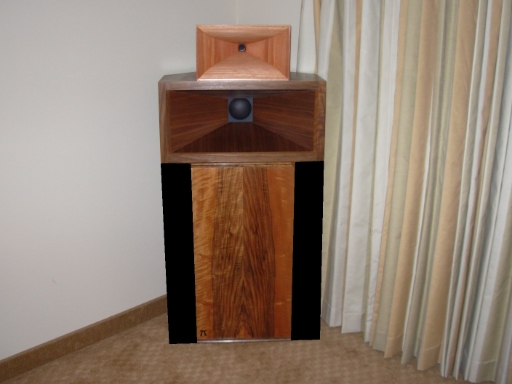

Another thing that's helping me lean towards the 7PI is an idea I posted a couple of months back for changing its physical appearance slightly. This doctored photo shows where filler wings would be added (in black) to the sides of the bass bin.
index.php?t=getfile&id=1202&private=0
The wings would consist of a simple L-shaped wood frame wrapped in fabric. It would fill-in underneath the front of the mid-horn and also extend down the sides of the mid-horn until the first 45deg corner. This change probably makes the 7PI look more like an 8PI which some may not like, but I like a more conventional look which also helps with WAF.
