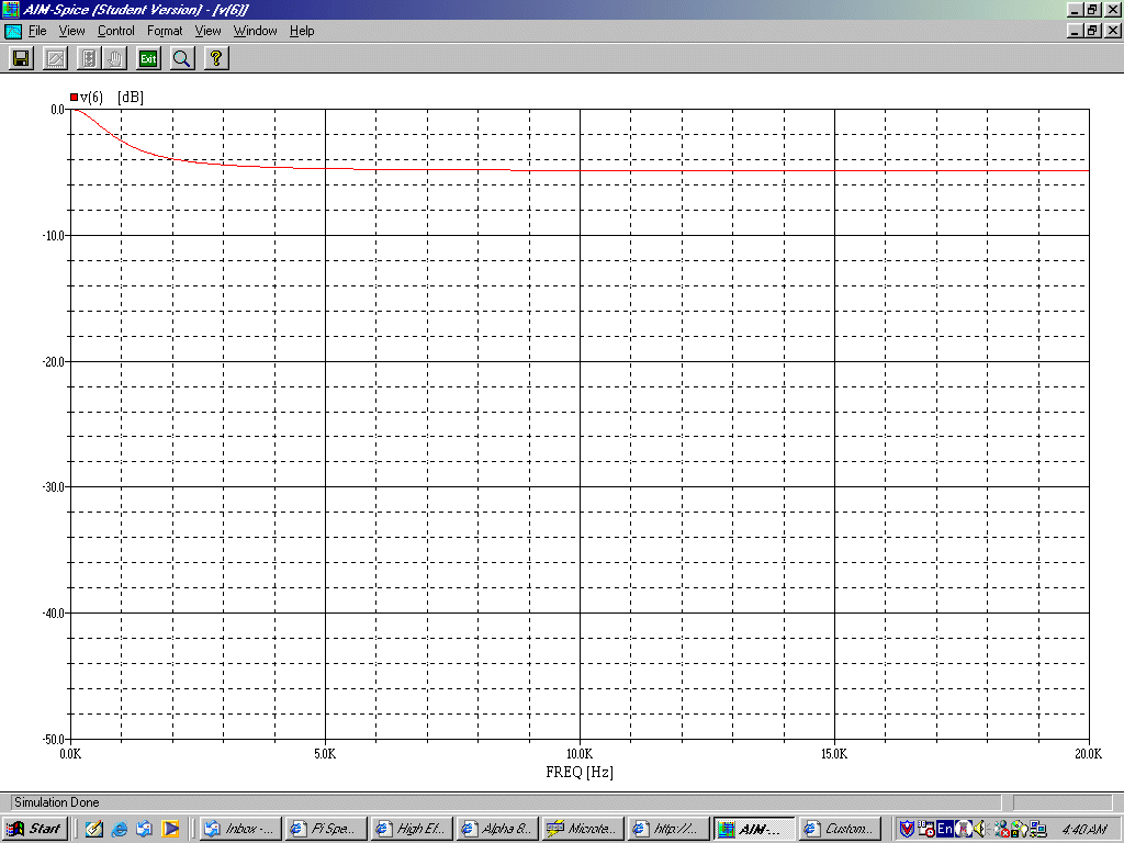

Eminence has changed the Alpha 10 and some of its other drivers recently. They've changed the voice coil to make them handle more power and while they've kept electro-mechanical specs pretty similar, there have been some minor changes. In the case of the Alpha 10, power handling and ultimately maximum output has been increased but there is a rise in the upper midrange as a result.
The way we're addressing this is to include a 0.5mH coil as a pseudo-first-order filter to create a shelf of reduced energy between 1kHz and 4kHz. The response curve you can expect from a 0.5mH coil in series with an Alpha 10 is shown below.

The coil is now included with kits, so nothing else is needed. If you're doing your own, just install a 0.5mH coil in series with the woofer. Cut one of the wires going to the woofer and splice the coil in, covering the leads with heat shrink tubing.
The coil should use 20 guage or larger wire, which will result in less than 0.5 ohms DC resistance. A suitable part is the 260-723.This part has 0.5 ohms DC resistance, so the woofer's Qes is only raised by 0.03. The difference in overall system Q is small, so it works pretty well.
