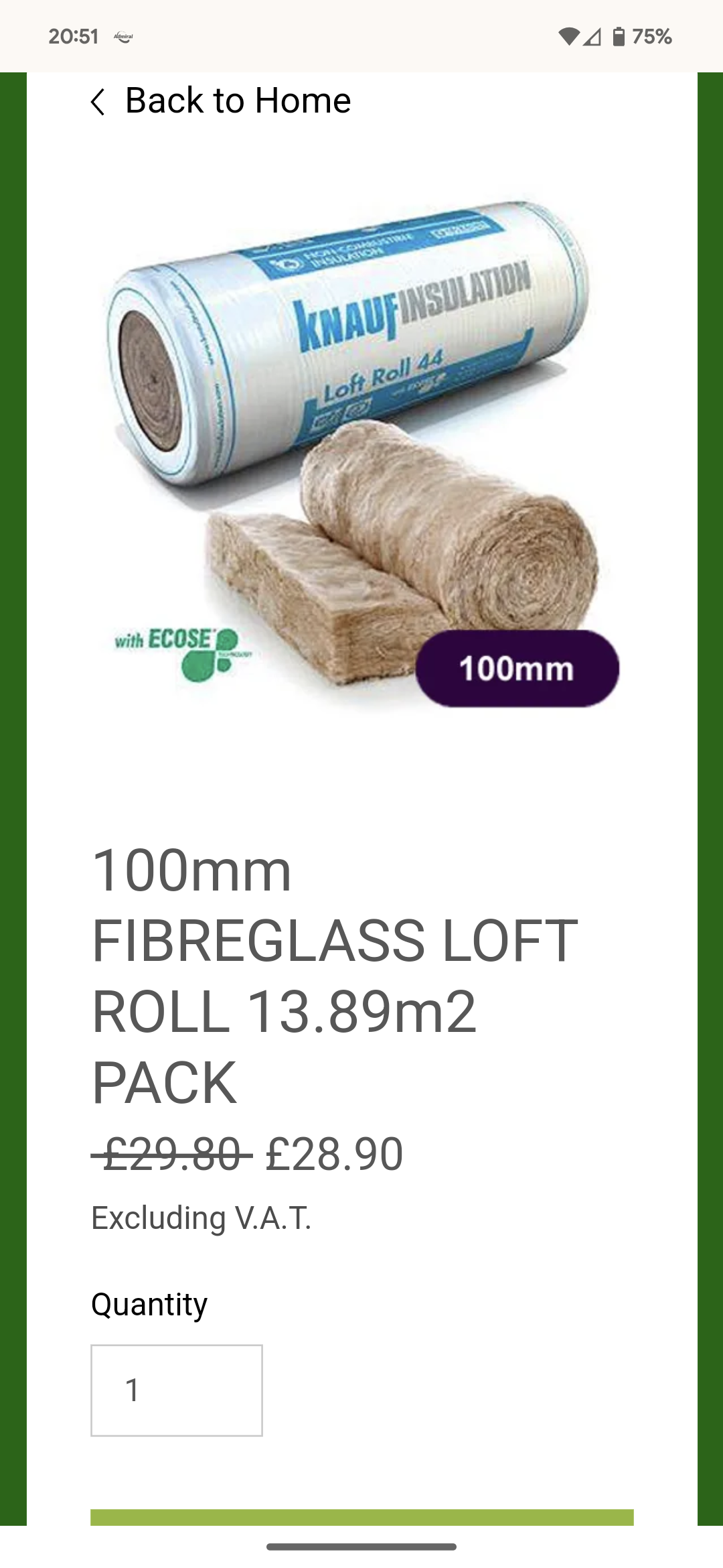

Is this the stuff Wayne?
/forum/index.php?t=getfile&id=3491&private=0
Re: 3 Pi build [message #98246 is a reply to message #98245] Fri, 10 January 2025 16:01 Go to previous messageGo to next message
Messages: 19078
Yes, that's it!
