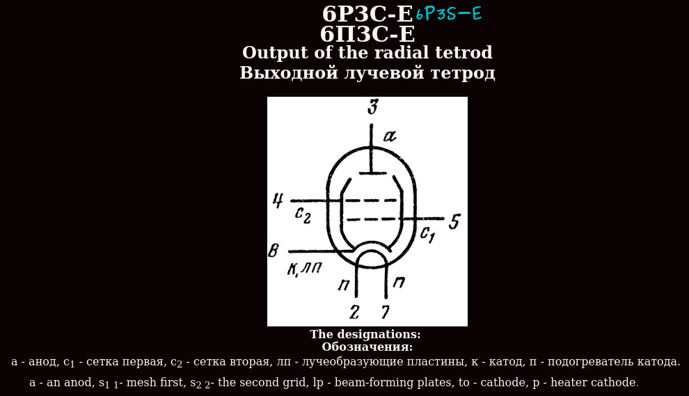

Here's a straight browser translation of the pinout if it helps any on the datasheet.
/forum/index.php?t=getfile&id=3415&private=0
