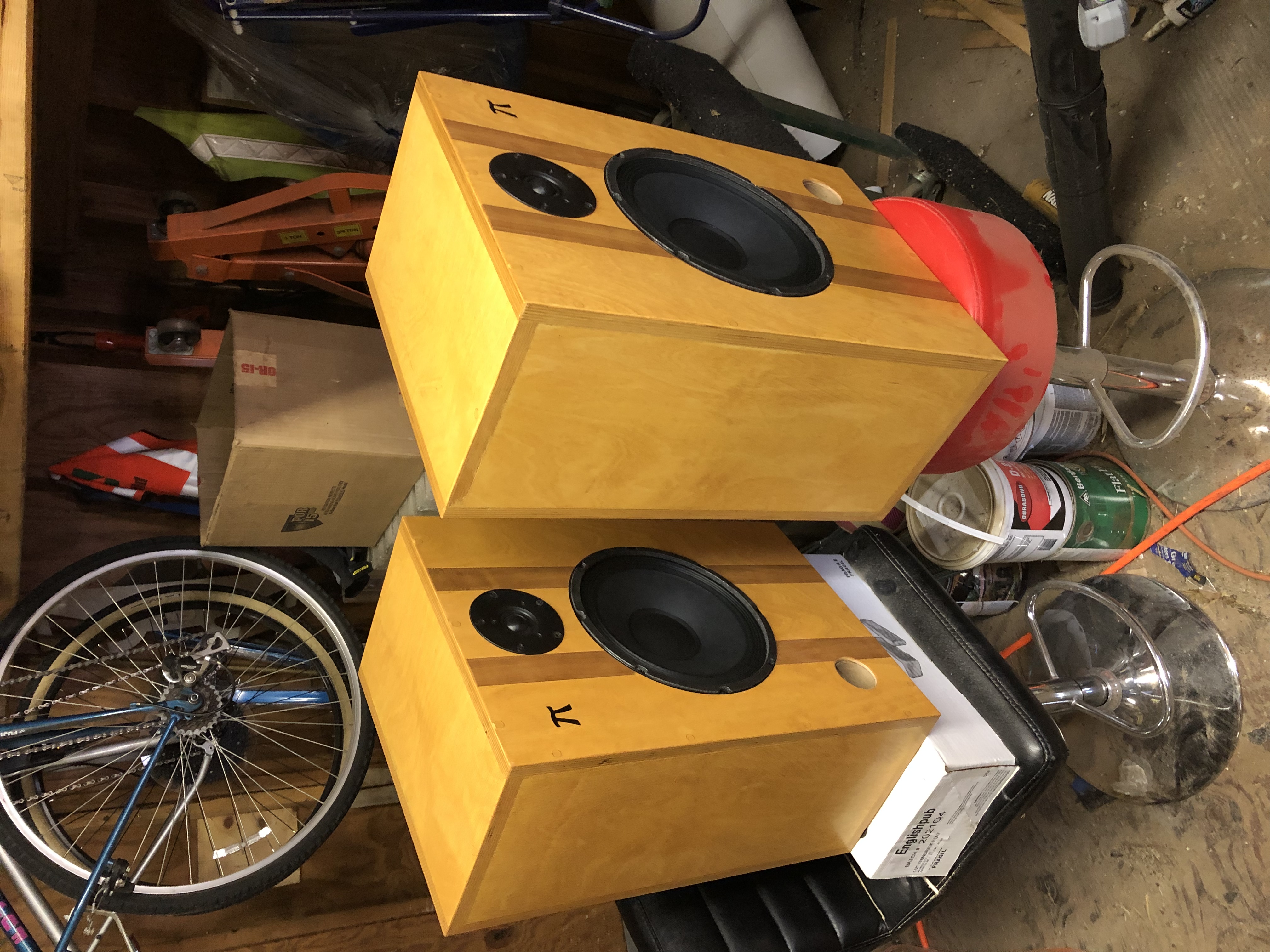

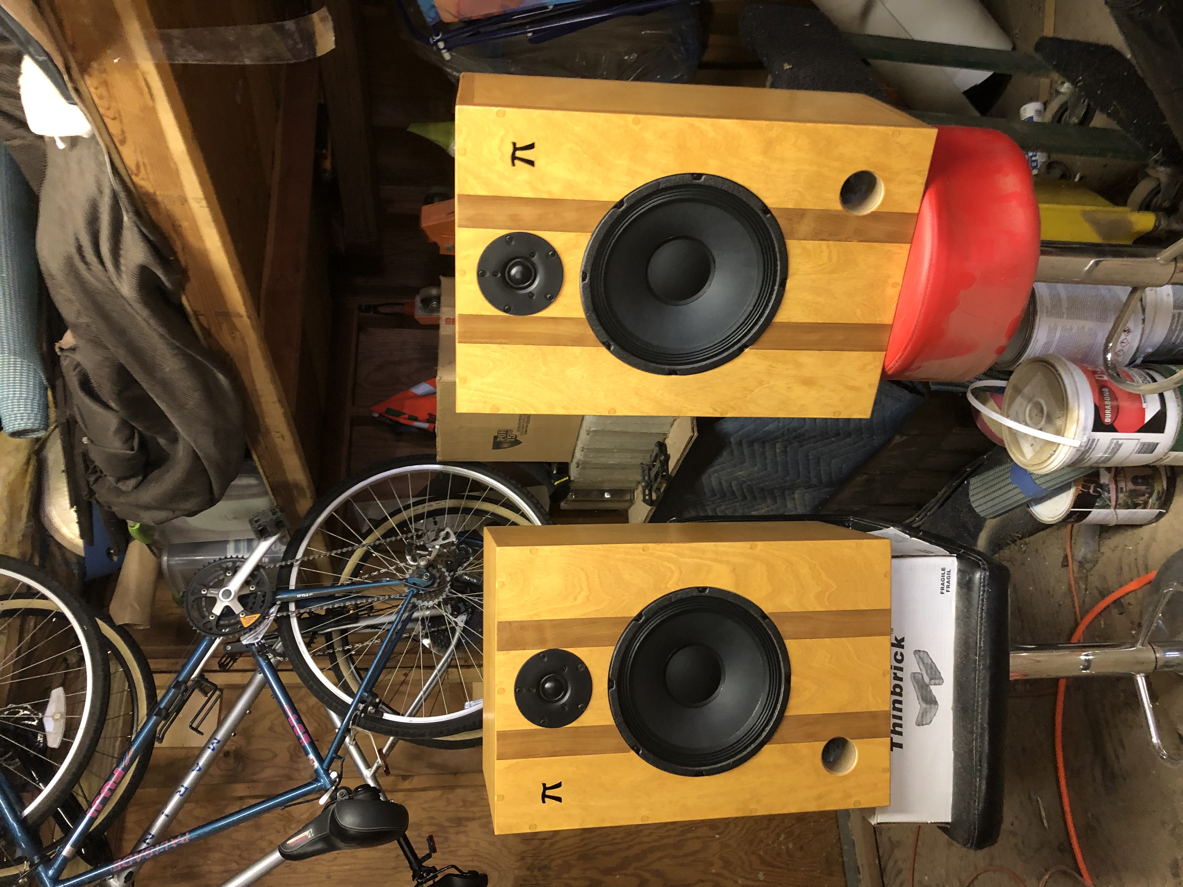

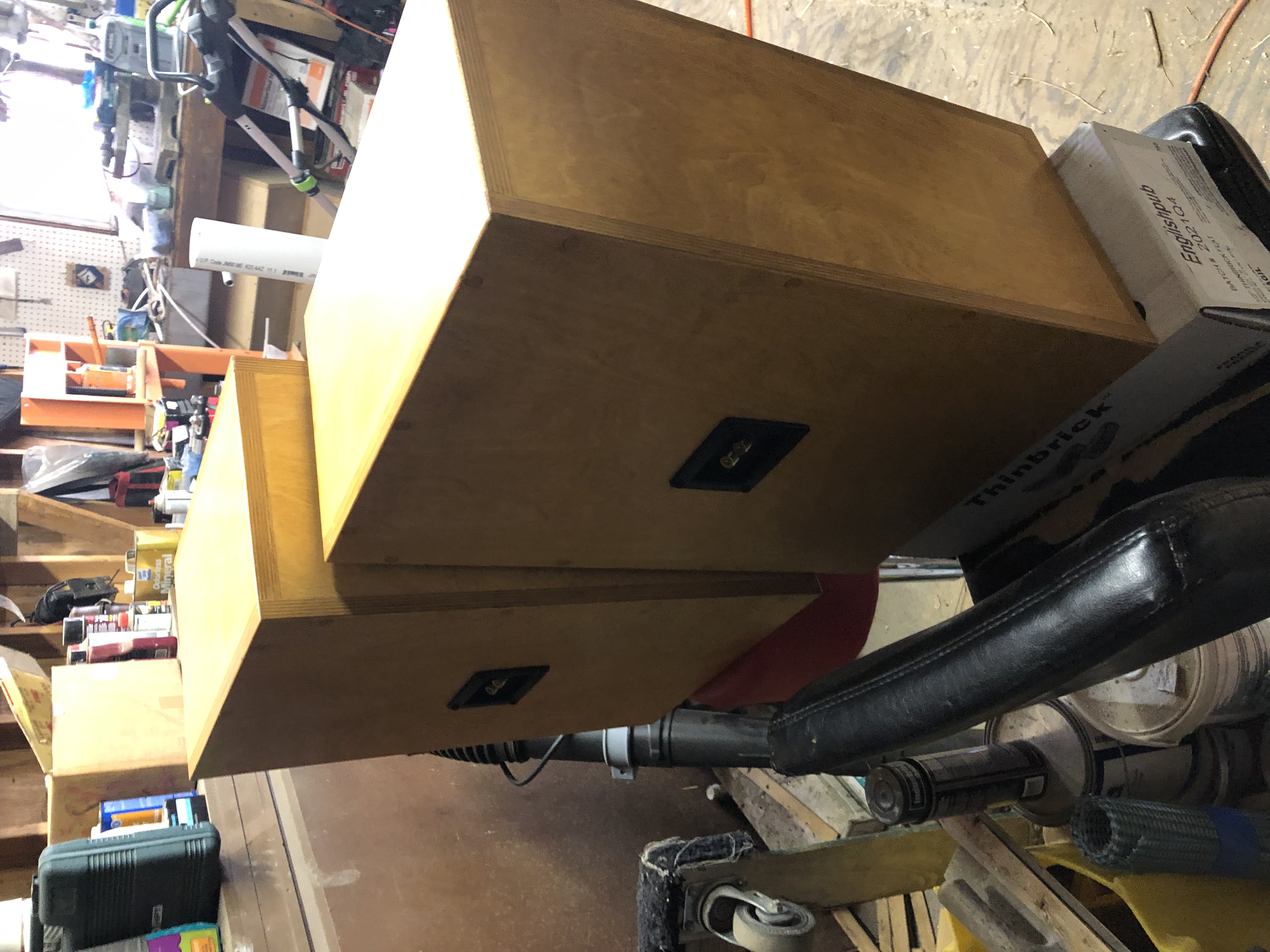

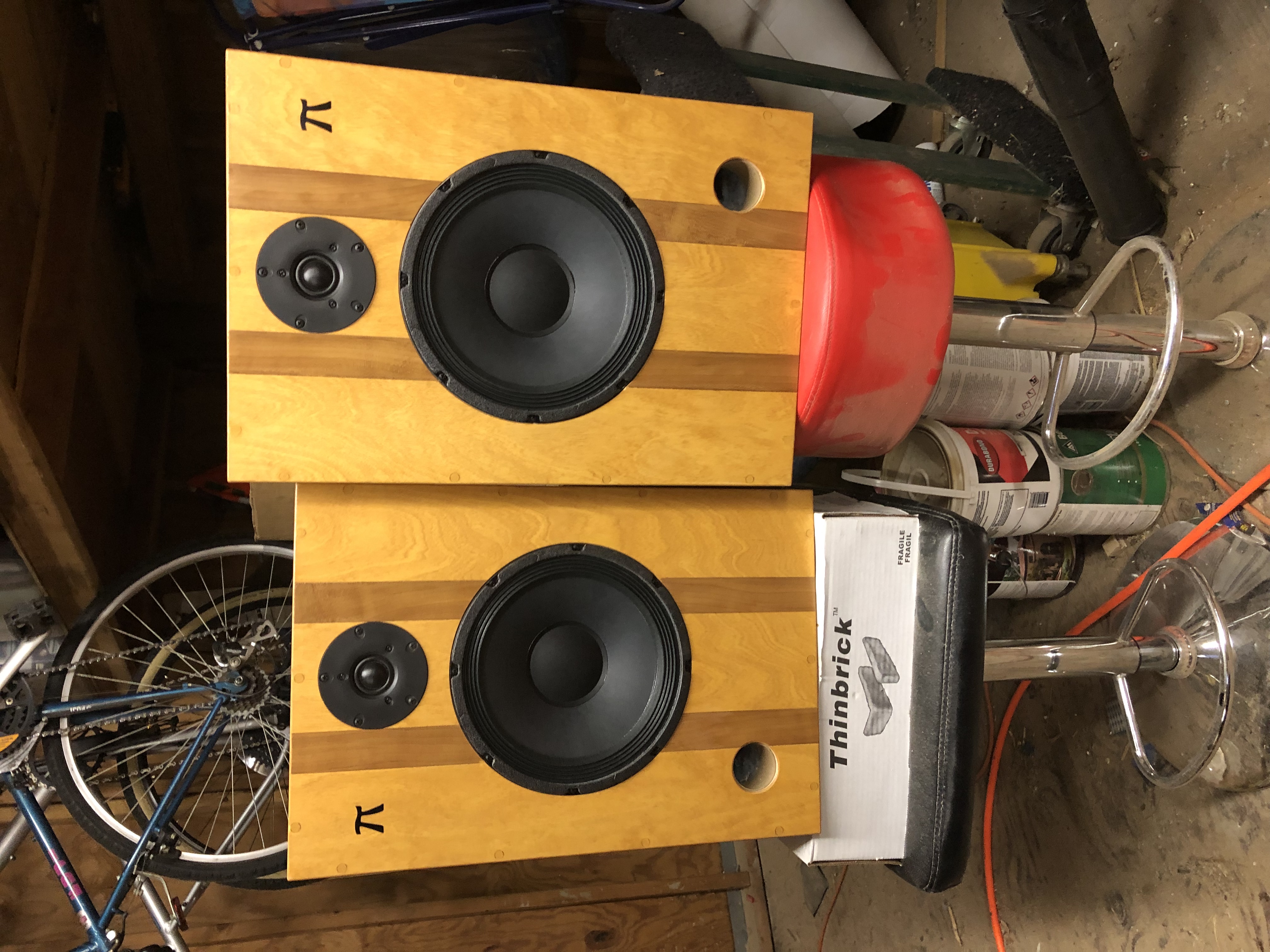

The kits came in yesterday afternoon (ahead of schedule). I had some time this afternoon so I decided to throw em together....
Looks like Wayne threw in Solen caps in the crossover... it's a win/win! 😎
I need to get better at taking more progress pictures during build and assembly, but I always seem to get lost in these builds and neglect it.

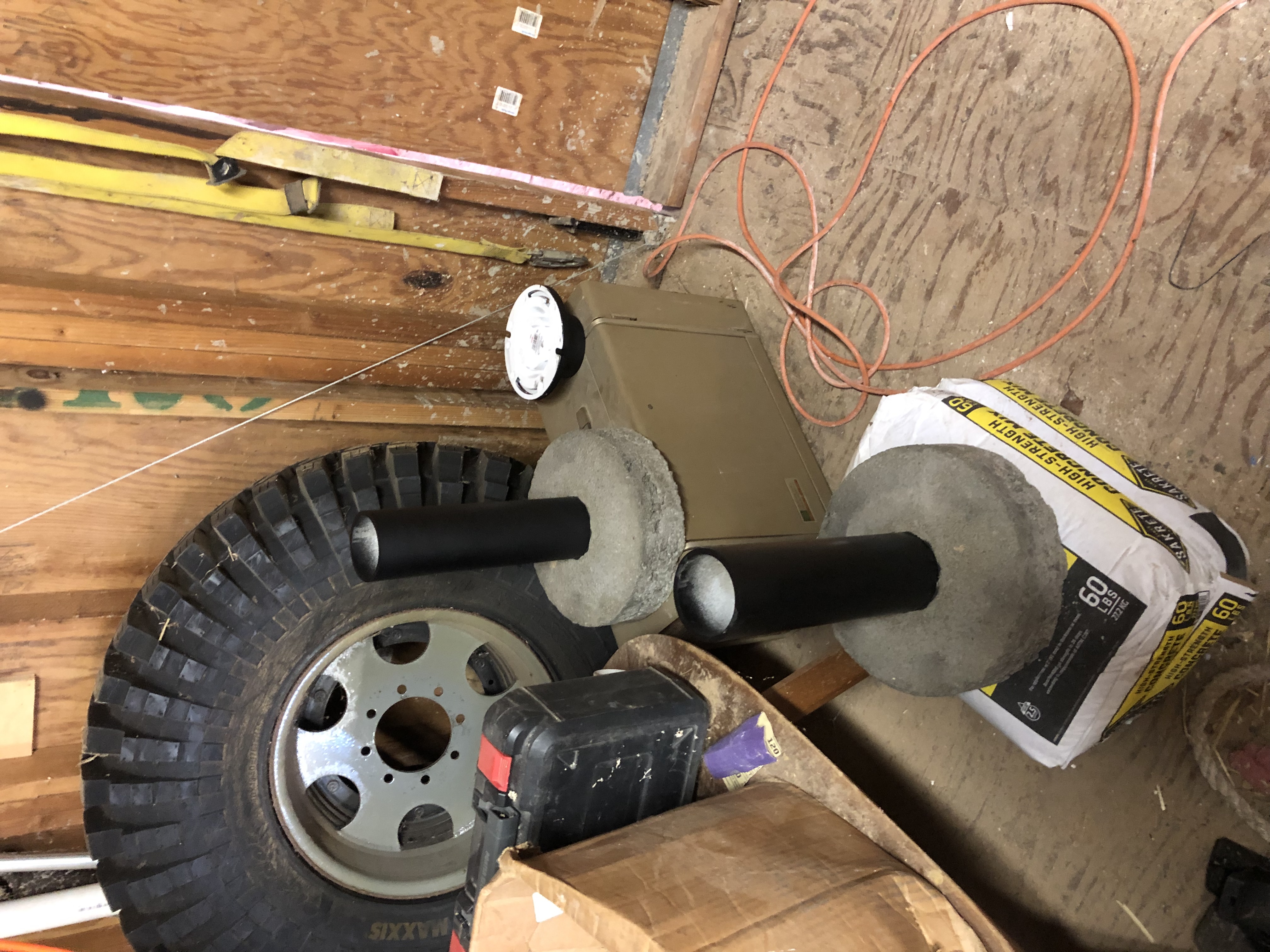

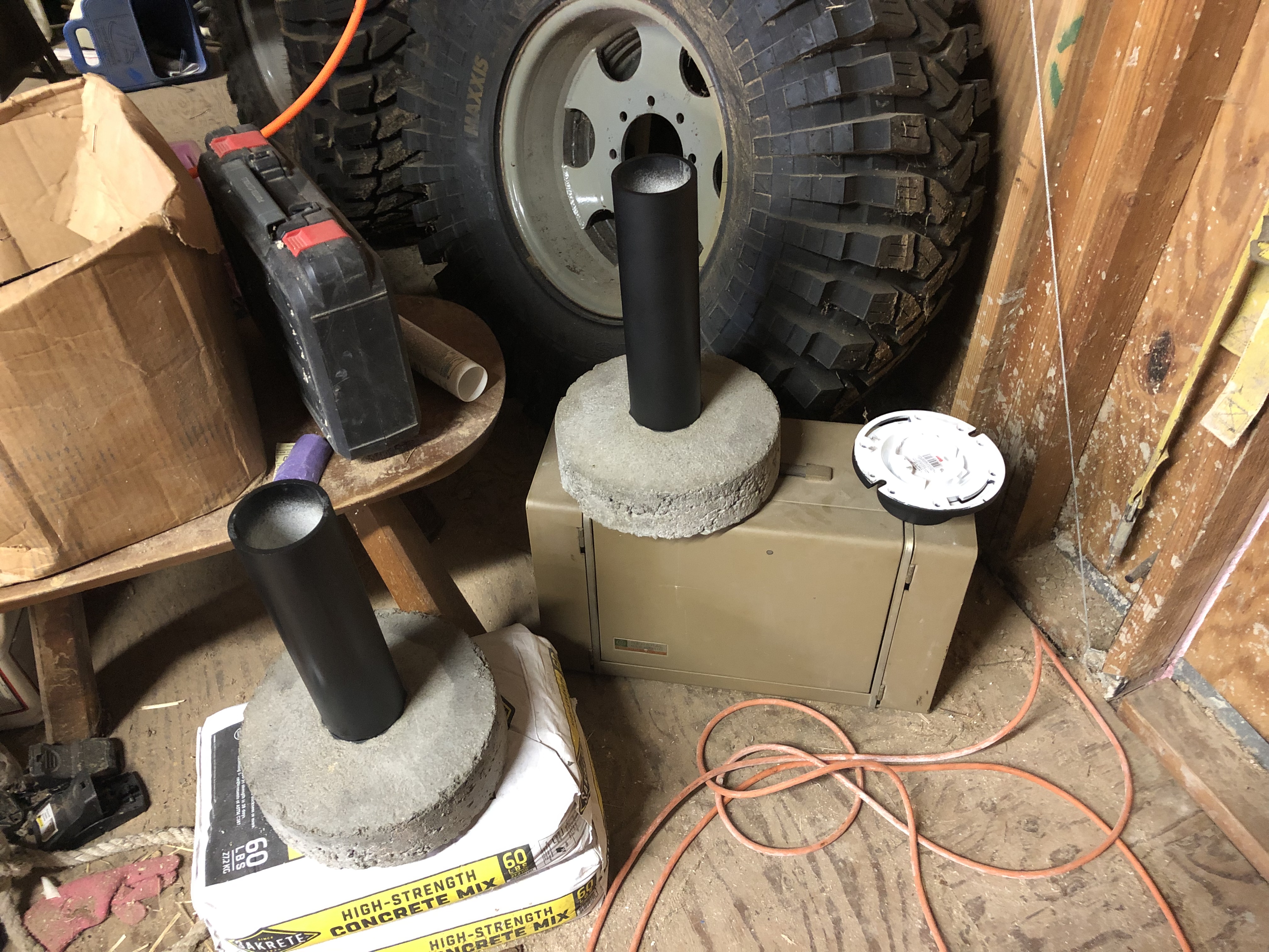

I decided to build some stands for these speakers also using material I had kicking around. The stands are built from 3" schedule 40 PVC and concrete gravel mix. The closet flanges (toilet mounts) go on the top of the 3" to set the speakers on (I'm not sure yet if I'll use Velcro, screws or both.)
I was also thinking about how I'd smooth the concrete bases. With most concrete work this is usually done the next day after removing the forms...with a sponge float using mortar cement.
But after another look, I decided I like the rough look after all.

I had six new closet flanges pvc. Once the pvc is primed and glued its almost impossible to get apart again, your more likely to break it.
Point is it would be hard to have "used" pvc parts ...
