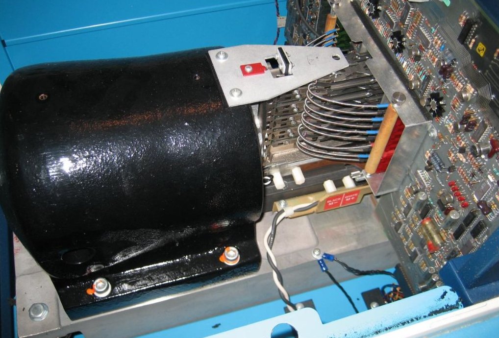

I love those old multi-platter disk drives. And you're right that they were the size of washing machines. Shook like a washing machine too during rapid disk seek operations. They usually had a large linear motor that moved the heads, and by large, I mean 100 pounds or so. Enough force they could break your arm if it went into emergency retract while you were aligning the heads. So you had to be careful how you adjusted the heads, where you pushed them as you tightened the set screw.

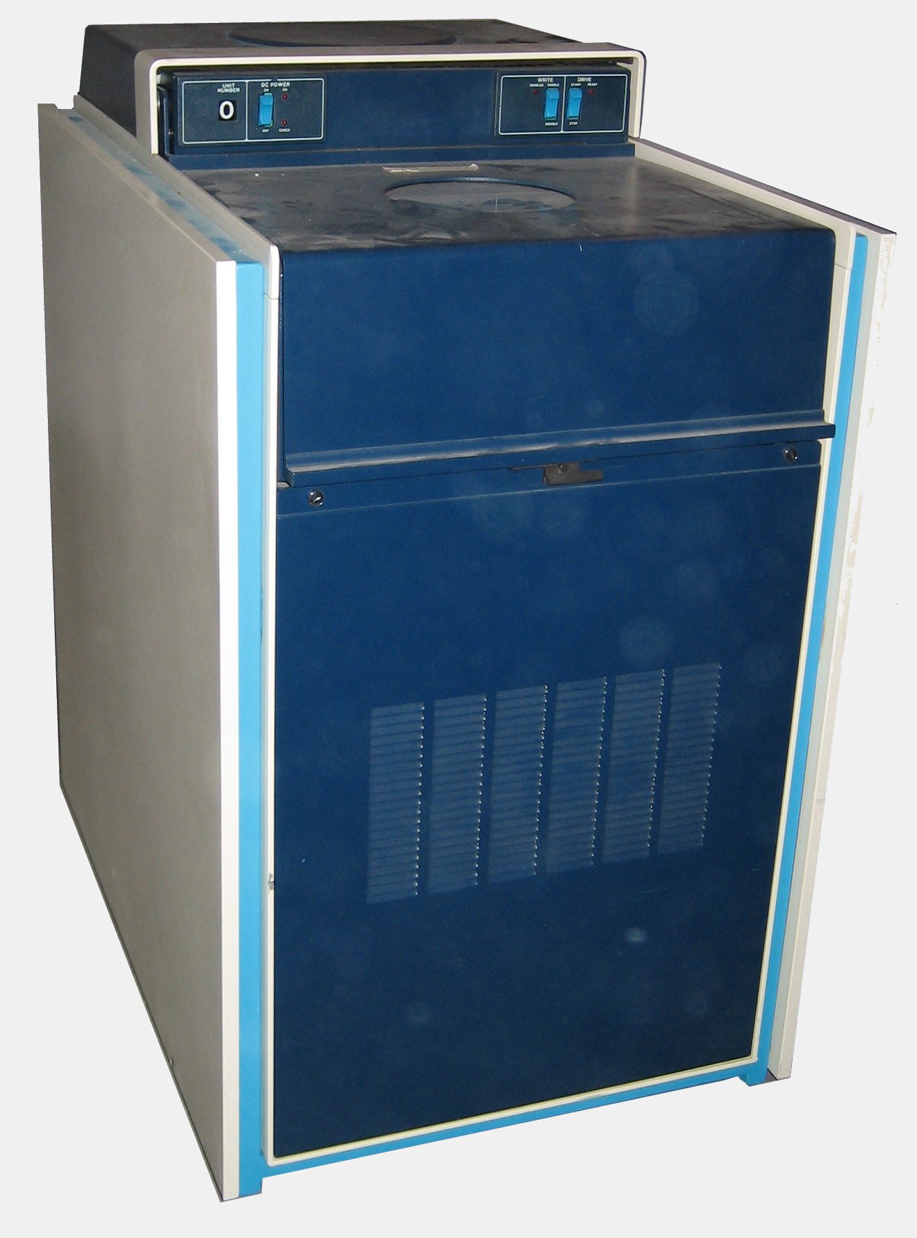

You're right that the disk drive cabinet would have been at least 250 pounds. Those multi-platter pack drives had huge transformers for the power supply and a linear motor that was 100 pounds, all by itself. And a fairly large support structure in the cabinet to support all that. So they were pretty meaty boxes.
Back in the day, I considered experimenting with using one of the linear motors from a Data General Zebra disk drive as a big subwoofer. But at 100 pounds, I just never "got around to it." Laughing
/forum/index.php?t=getfile&id=3269&private=0Linear motor that positions the heads (with shipping head lock in place)
/forum/index.php?t=getfile&id=3268&private=0Data General 6061 Zebra Disk Drive

Hi, That looks a lot like the one I was going to buy. Huge and heavy.
