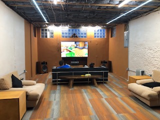

I had been hinting about finishing our basement for a long time, and I finally did (more or less).
"Finished" may be the wrong word, perhaps "rough man cave" is a better description lol.
Of course there are a few things left for me to do.
It is not a particularly large room (14.5' wide x 28' long x 8'8" high) but we are enjoying it just fine.
/forum/index.php?t=getfile&id=2351&private=0

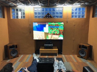

Tonight my son and I managed to get the 4pi's toed into the front corners. I hope all you Pi speaker fans can guess what's going to go in their place??
/forum/index.php?t=getfile&id=2348&private=0

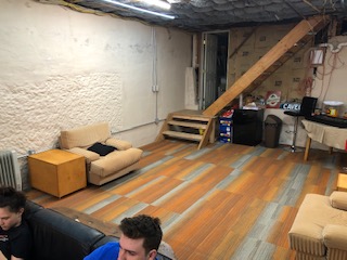

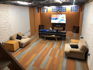

The center table under the tv is a sub, and so are the two end tables by the gold colored chairs.
The final sub, which is shaped like the center sub under the tv,
fits nicely under the bottom stair landing, but we haven't gotten it there yet.
/forum/index.php?t=getfile&id=2350&private=0/forum/index.php?t=getfile&id=2349&private=0

I spray foamed the entire underside of the decking (ceiling between floor joists) with diy open cell foam, then installed the ultra-touch (cotton) insulation over that.
With the entire ceiling acting as a broad band absorer,
It doesn't sound bad at all.
Even (like you said) with the unforgiving concrete walls.
I should really have subs flanking the mains, but I didn't bother since the 7-pi corner horns will be going in those corners any day now.
Also, it's surprising how good these 4pi's sound, shoved into these corners temporarily.
I will probably locate a sub under the bottom stair landing, and another at the opposite corner.
This way, there will be four different bass sources in the room, which should help smooth bass response.
Once I get everything finalized, I will get to taking some measurements and perhaps post them up here.

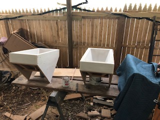

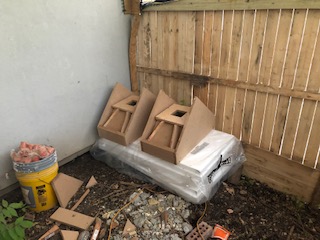

I finally got to working on the mid horn enclosures.

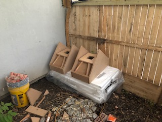

For a year or so they sat in my garage under a moving blanket like this (while I slowly rebuilt my homes foundation)-
/forum/index.php?t=getfile&id=2358&private=0

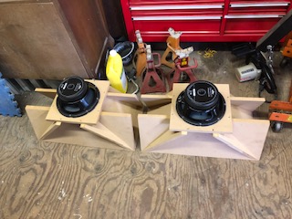

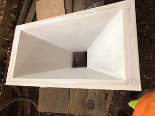

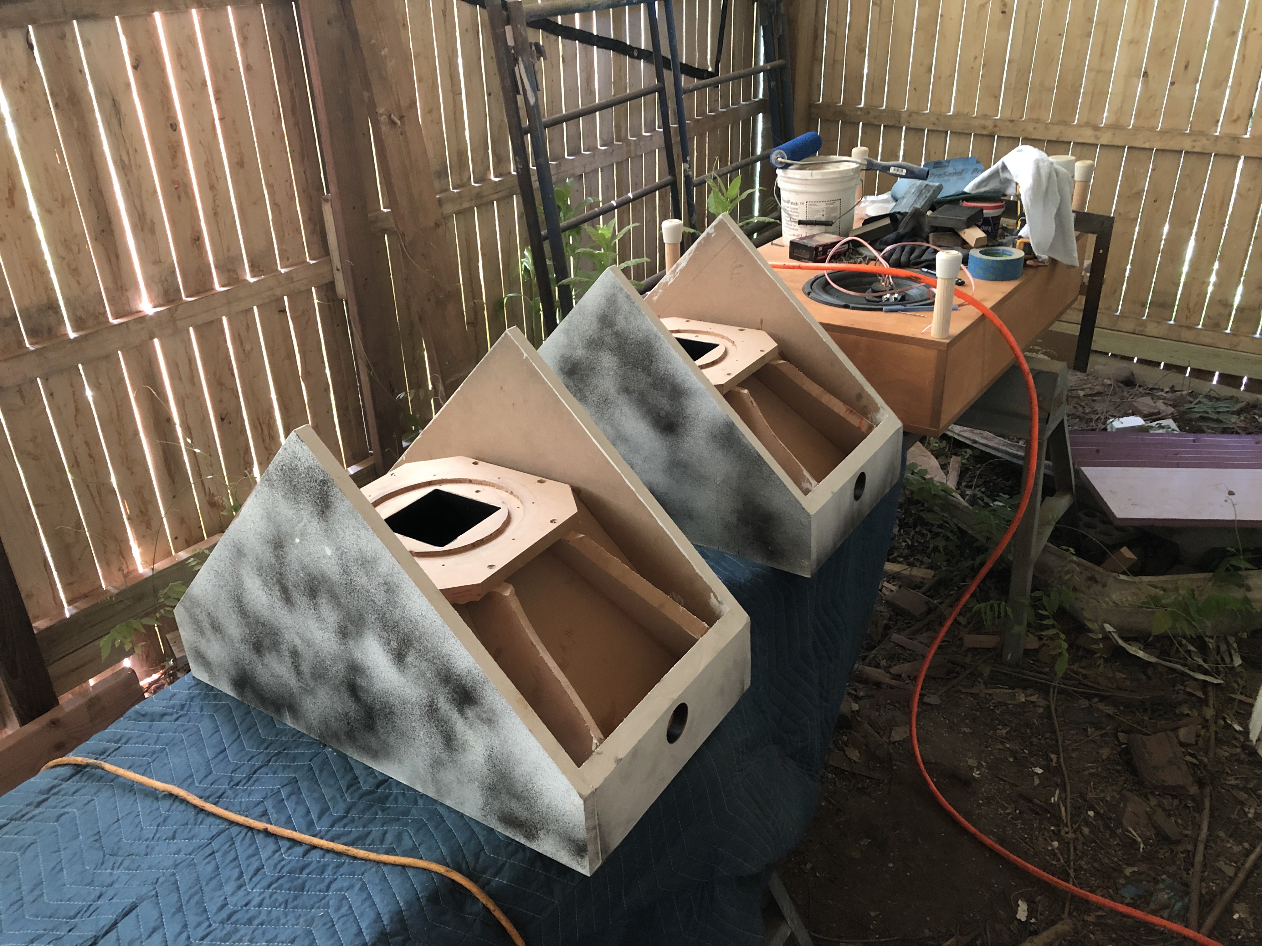

A few weeks ago I finally got to creating some enclosures-
/forum/index.php?t=getfile&id=2360&private=0

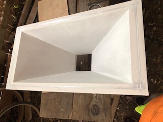

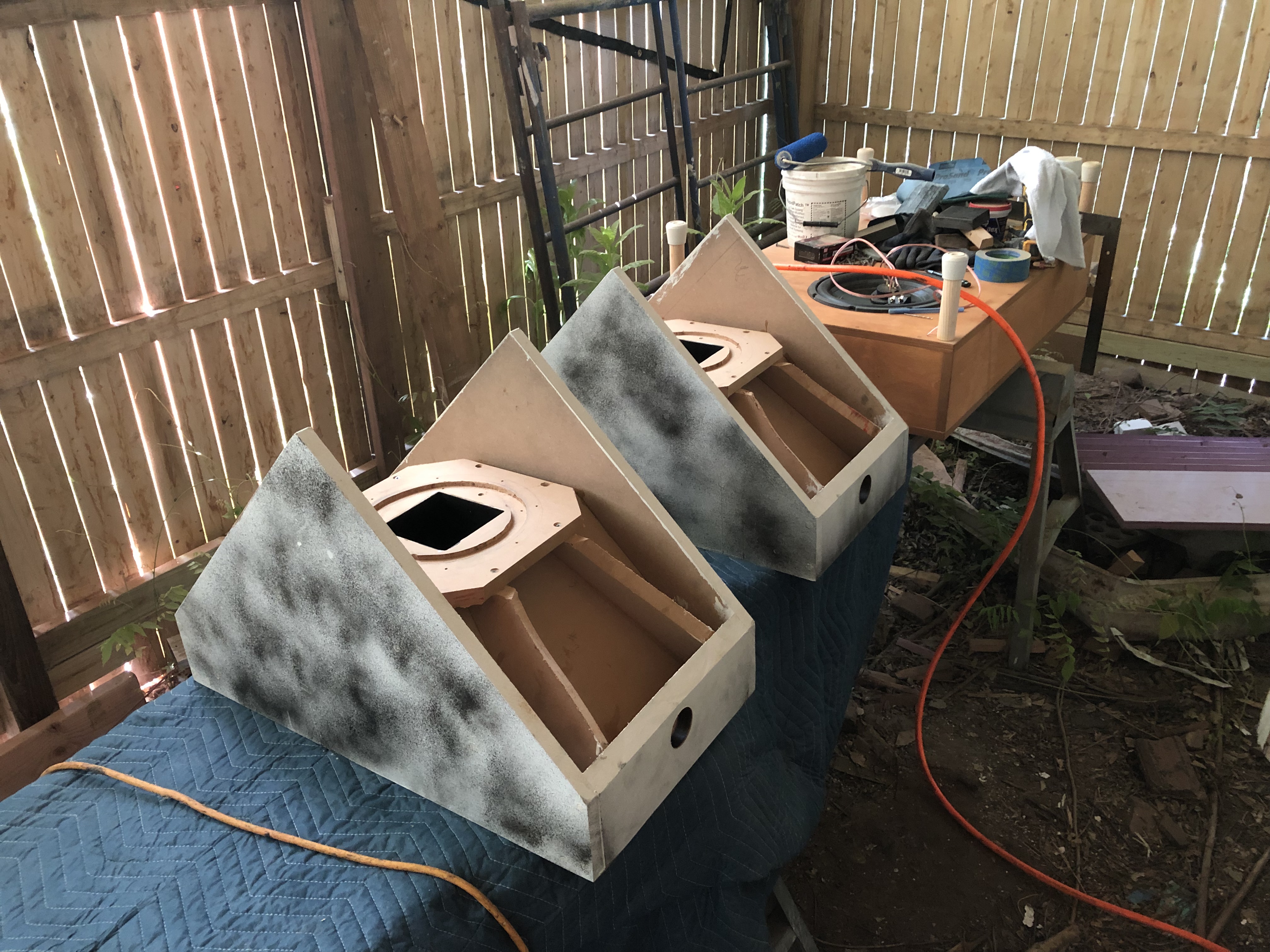

Last week I painted the MDF with oil base primer-
/forum/index.php?t=getfile&id=2361&private=0

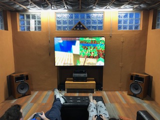

Meanwhile, Ive been using the 4pi's tucked into the front corners both for movies and music-/forum/index.php?t=getfile&id=2363&private=0
Its been set up like this for a couple of months now.
Although I had previously mentioned that I had not set up flanking subs, in this current arrangement (to my ears), they really are not needed.
It sounds to me like things have tightened up and become more cohesive in the lower mid-range, (200-500 Hz?) which is above the range of the flanking subs,
but again, just a subjective observation, no measurements of proof.
I look forward to finally getting the mid horns completed, I imagine they will sound even better.

I chose to router a 1/4" deep groove out of the mounting plate, to compensate for the woofers maximum excursion, instead of using the spacer.
/forum/index.php?t=getfile&id=2368&private=0

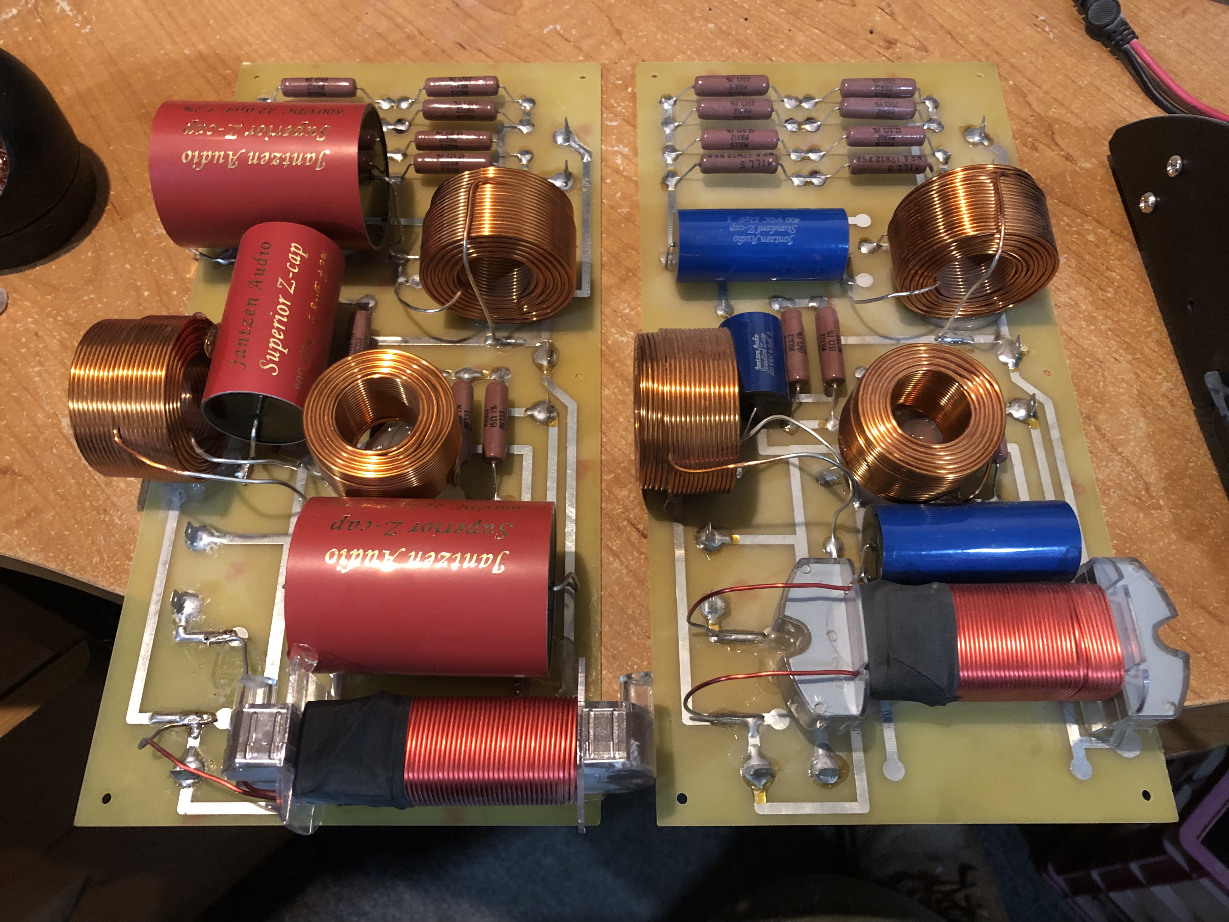

I also finally got to installing the Jantzen superior Z caps on the crossovers.
The caps are quite a bit bigger than the standard Z's, but I managed.
You can see I had to turn the Erse coil on it's side...
/forum/index.php?t=getfile&id=2369&private=0
