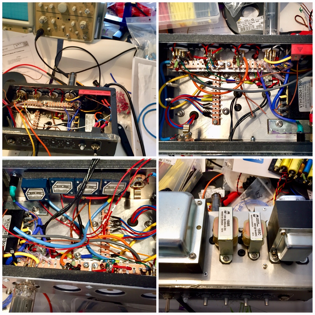

Some photos during DIY:
index.php?t=getfile&id=2247&private=0

The level of noise (buzz, hiss, humm) is very low, although all the tubes are AC heated and mounted on small chasis with PT, OPT and 2 chokes closely together and to the speaker.
A- class amps, especially this DC-coupled type (R16 ! ) are known for the amount of heat produced. I used (Vox style) vent / grill opening, this amp is literally hot!
Initially, the amp was designed with EZ81 rectifier. In the end I used EZ80 - a bit smaller voltages and slightly different sound then with EZ81. This change isn't critical, amp "draws" about 73 mA when idling. Voltages on schematics are measured with EZ81 in place, EZ80 "gives" 5-7 % lower voltages tipically.
