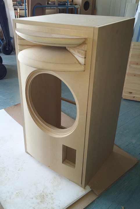

Just finished a speaker project a week ago, I am not sure these are approved as PI 4 speakers as they have some modifications
I used the Yuichi 480FL horn, the cabinet are about the correct size, flipped around 180 degrees
index.php?t=getfile&id=1569&private=0
index.php?t=getfile&id=1570&private=0
index.php?t=getfile&id=1571&private=0
They sound very good! With Eminence all the way Smile

Those are beautiful speakers! I always loved Yuichi's wood horns. They are partly what inspired me to make my first waveguides, which were made of wood. Now I make the H290C waveguides out of plastic, using an injection mold. Makes them much more cost effective. But I love the wood horns, they're so attractive!
I might suggest that you dial-in your crossover using the method described in the thread called, "Crossover optimization for DI-matched two-way speakers" or a similar process. My crossovers are designed for use with the H290C waveguide, which has different acoustic impedance and a different acoustic center. So since you're using a different HF horn, summing could probably be improved with a few small tweaks.
