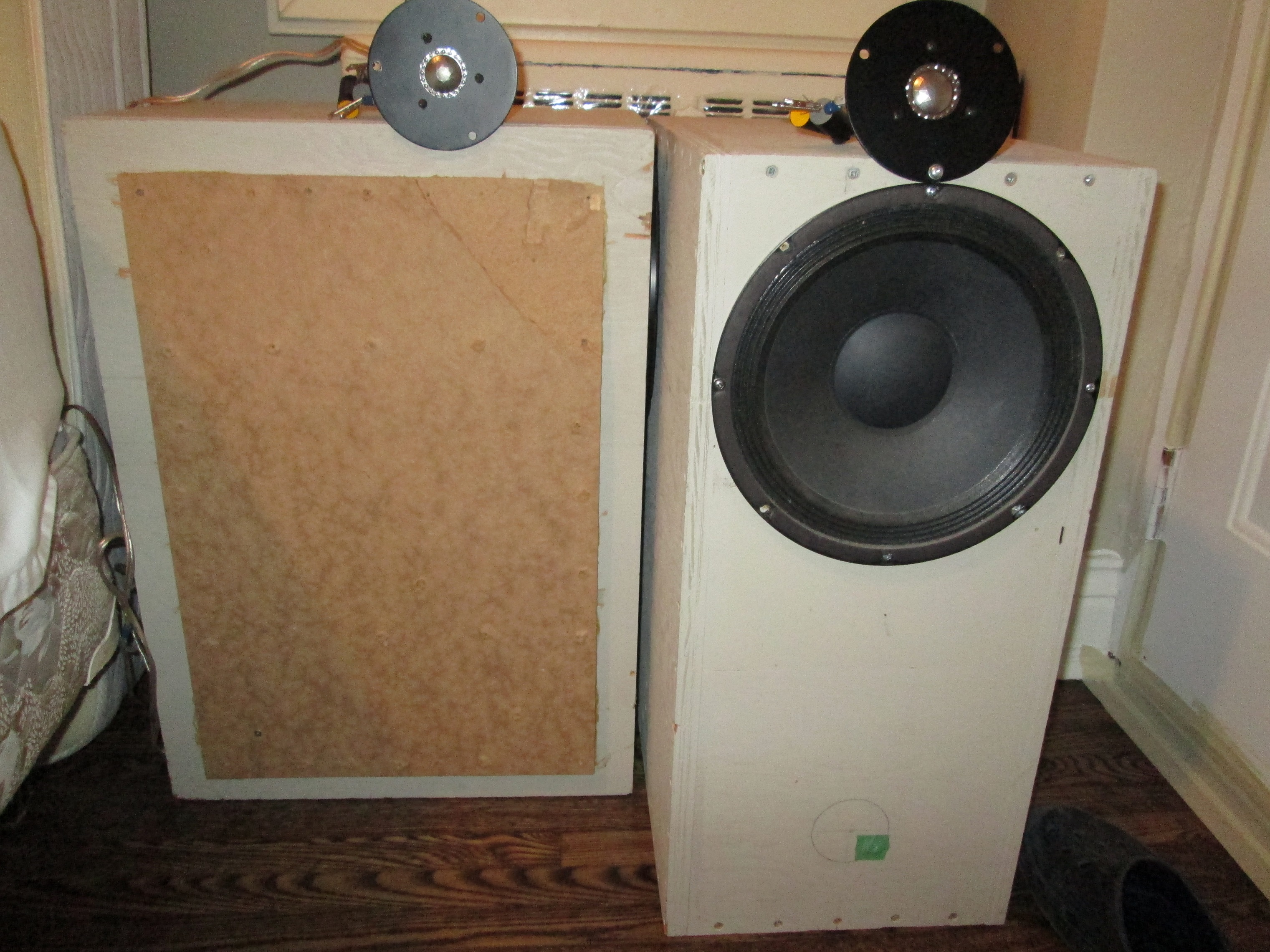

By the way, this is the reason why speakers should be kept under 12 inches in width:
index.php?t=getfile&id=1475&private=0
As you can see, there are a pair of tiny PARADIGM titans taking the place of the future 2 Pi's.
Thanks again!
