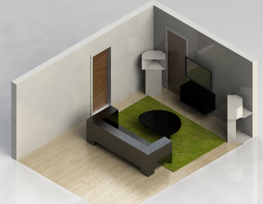

index.php?t=getfile&id=1465&private=0
I'm tempted to build the 7Pi Corner Horns.
But I wonder if the placement in my room will make the 7Pi justice.
I have to place a stereo cabinet on the front wall between the corner horns and a (closed) door near the left speaker is inevitable.
I even dare to put a coffee table in front of my sofa...
What do you think?
Re: 7Pi placement in my room [message #80047 is a reply to message #80042] Fri, 06 June 2014 06:37 Go to previous messageGo to next message
If the closed door doesn't vibrate, that will be fine. But I do worry the door might rattle.
