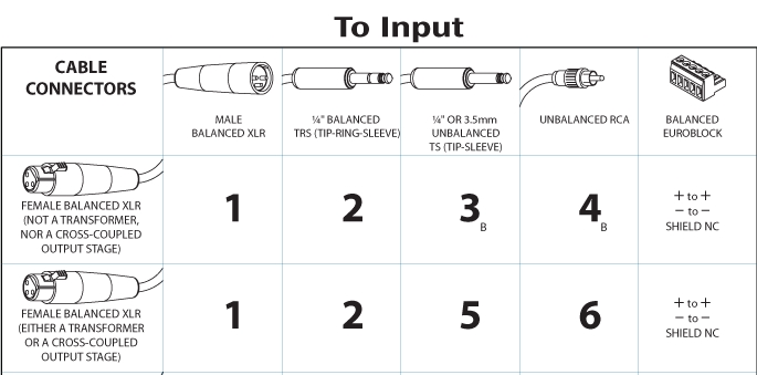

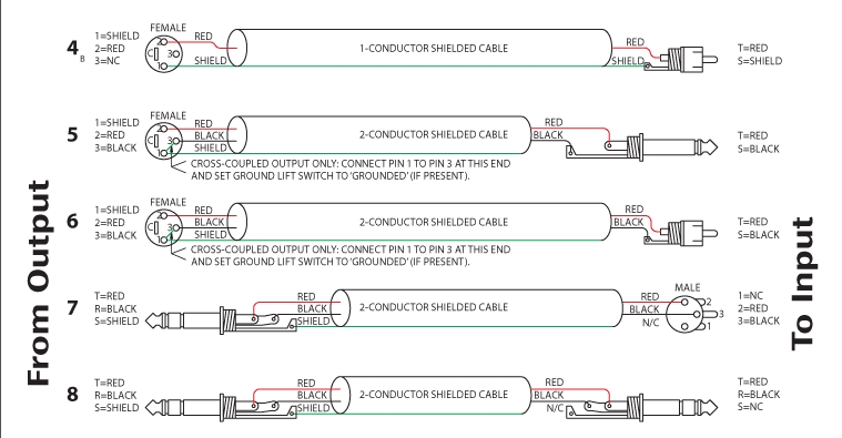

My next issue seems to be the balanced outputs of the Rane crossover. It looks like the easiest way to connect the balanced outputs of the Rane to my unbalanced Amp would be to have Blue Jeans Cable send me the correctly configured cables. Does anyone know if I should use #4 or #6 from the attachments?
index.php?t=getfile&id=1414&private=0
index.php?t=getfile&id=1413&private=0
Does this mean that I'll lose half my signal?

Hi, No, but you will lose the benefits of the balanced line configuration (low noise, immunity to EMI). An alternative is something called a Direct Box from the Pro side of the house. They come in all sorts of configurations and will provide the connection you need. Both passive and active are available.

So I'm on track with the active crossover? I don't see any that review well that are also unbalanced input and output.
If I'm on track then, and I understand you correctly, then I'll want a direct box as well? Can you recommend any?

Remember that balanced pairs are like speaker outputs, with a "+" and a "-", each signal being the compliment of the other. Unbalanced signals are referenced to ground or some other "zero" reference. The information is the same either way, as is the content and everything else. So nothing is lost or gained with respect to information or signal content. Its just a different interface. The main thing that makes balanced attractive is common mode rejection. Any signal coupled into the wire pair will be cancelled at the input(s), since each is the opposite of the other. Anything that is common to both is cancelled.

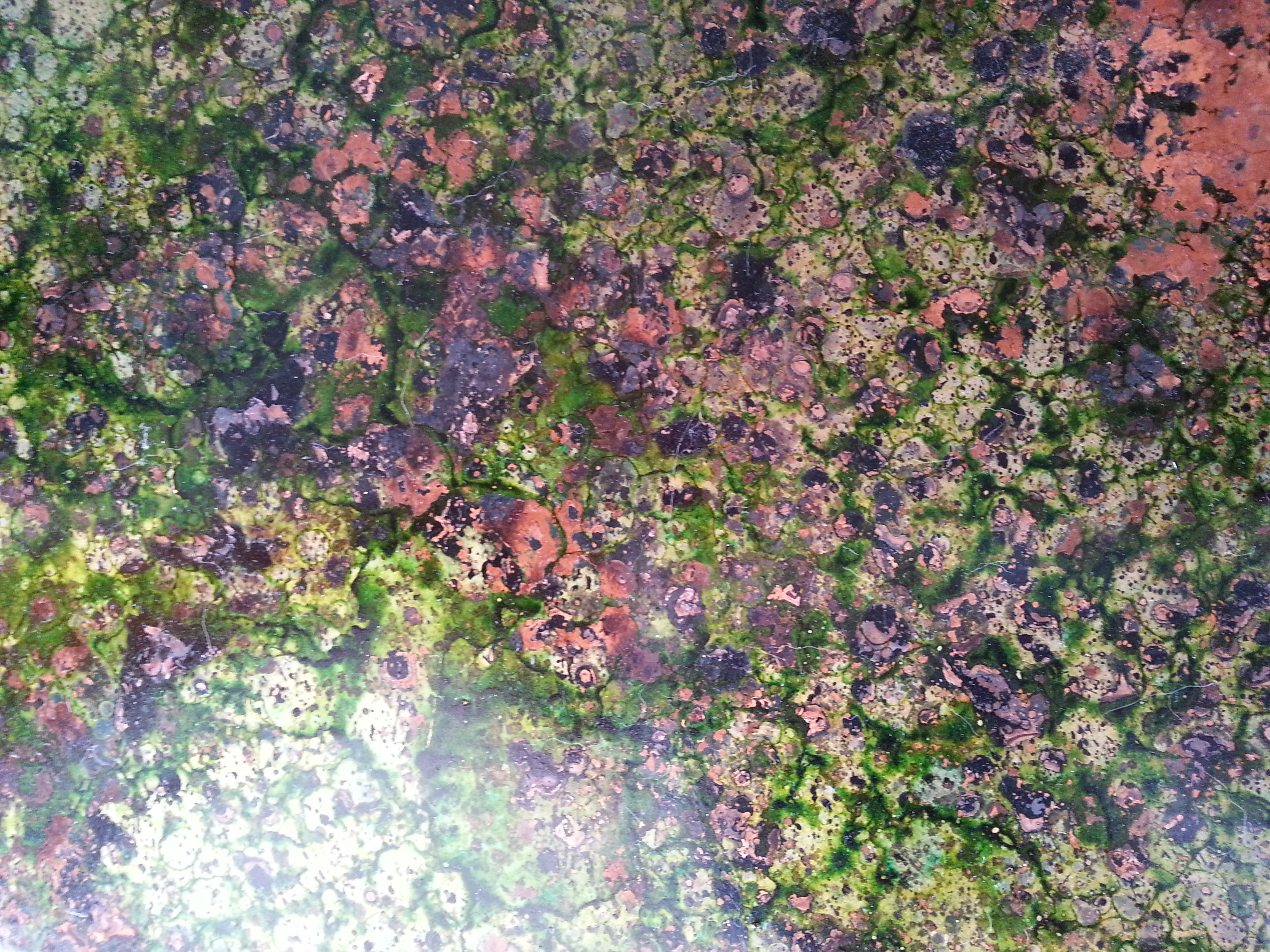

I used copper laminate on the subs, and they came out pretty well. We've had quite a few cloudy days lately and the speaker didn't show up well in my photo, so I included a photo of the top of one of the speakers so you can see how beautiful they came out.
index.php?t=getfile&id=1450&private=0
index.php?t=getfile&id=1451&private=0

Interesting! That looks really cool!
