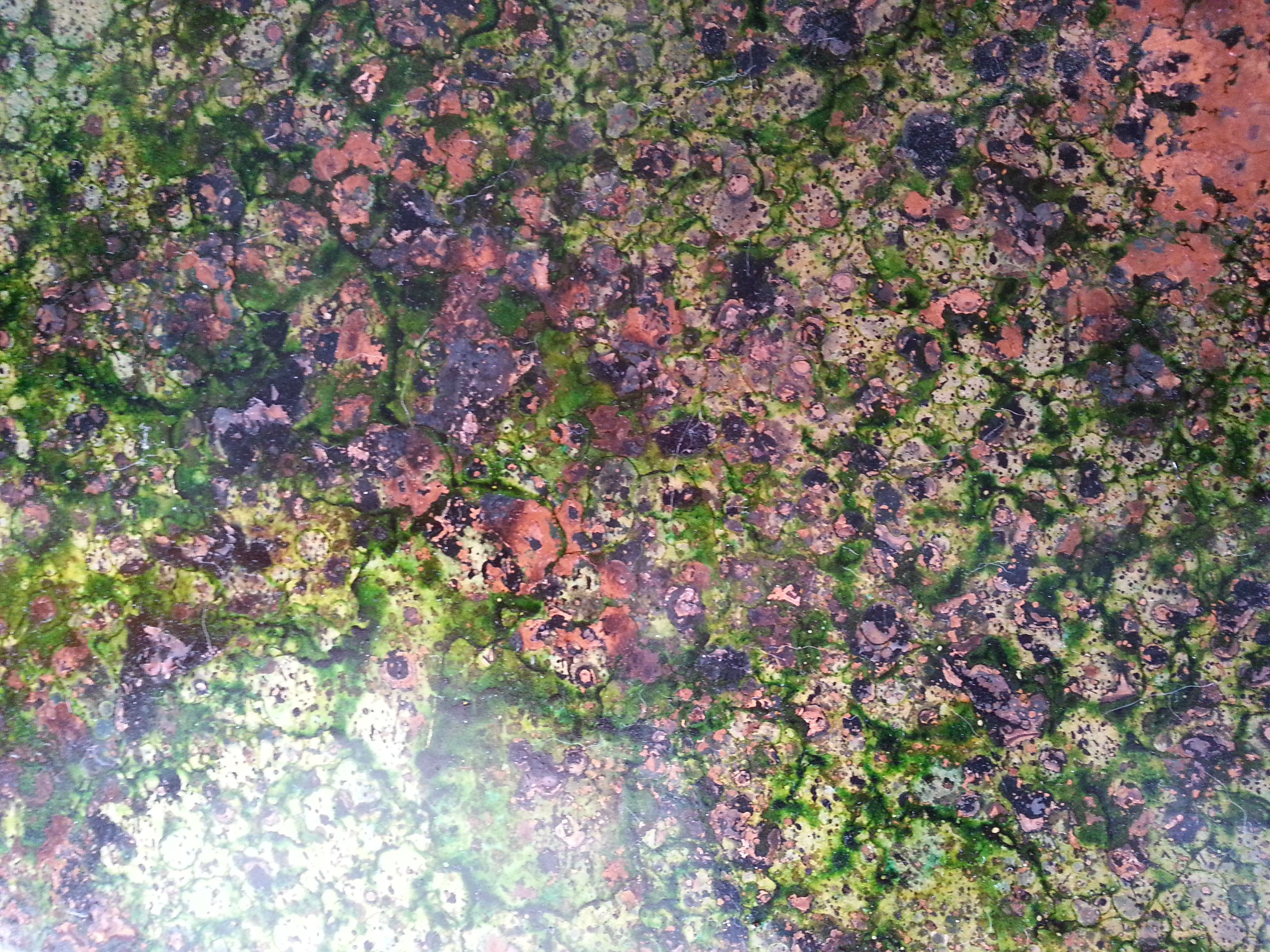

I used copper laminate on the subs, and they came out pretty well. We've had quite a few cloudy days lately and the speaker didn't show up well in my photo, so I included a photo of the top of one of the speakers so you can see how beautiful they came out.
index.php?t=getfile&id=1450&private=0
index.php?t=getfile&id=1451&private=0
Thanks,
Doug
Re: Flanking Subs Lead Newbie to Confusion [message #79775 is a reply to message #79764] Tue, 01 April 2014 11:00 Go to previous message
Interesting! That looks really cool!
