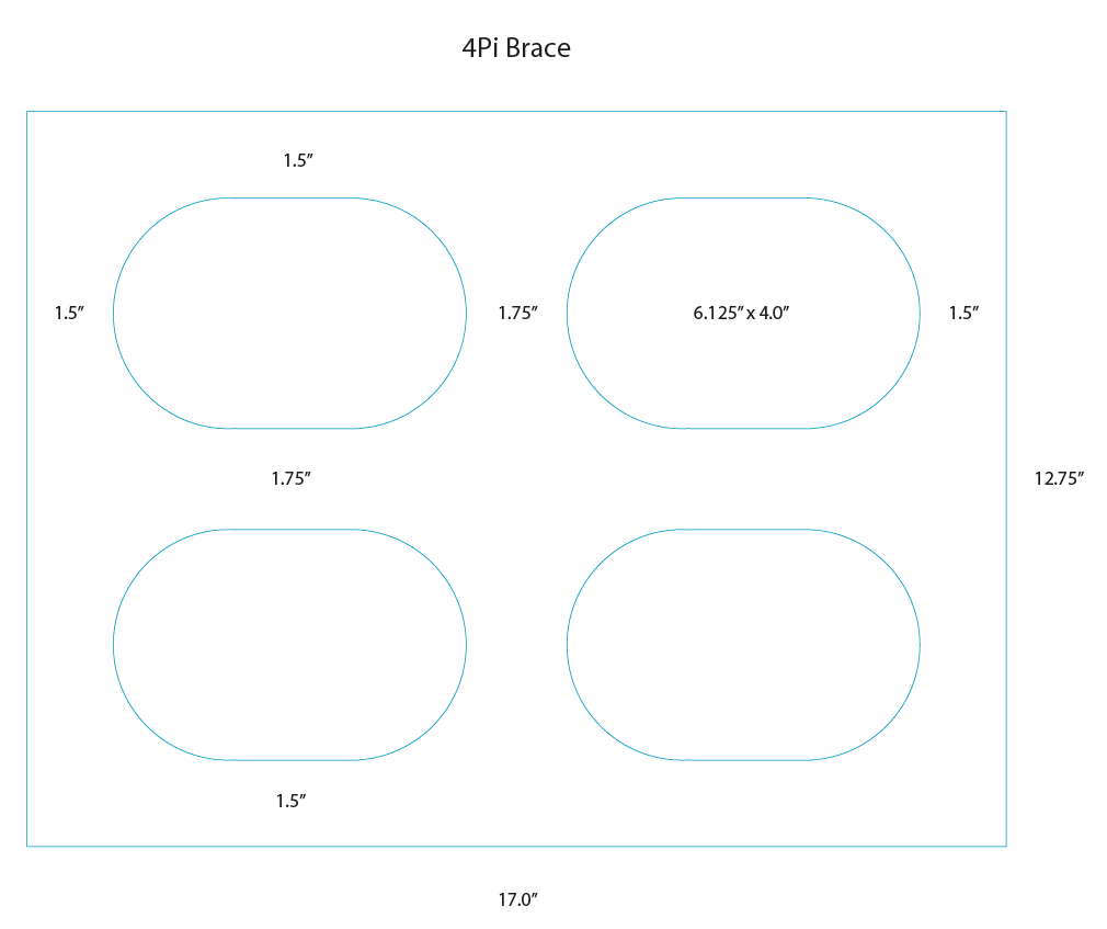

Would this be a more substantial way of building a brace for a pair of 4Pis.
Do the oval cut outs look like they will allow enough airflow?

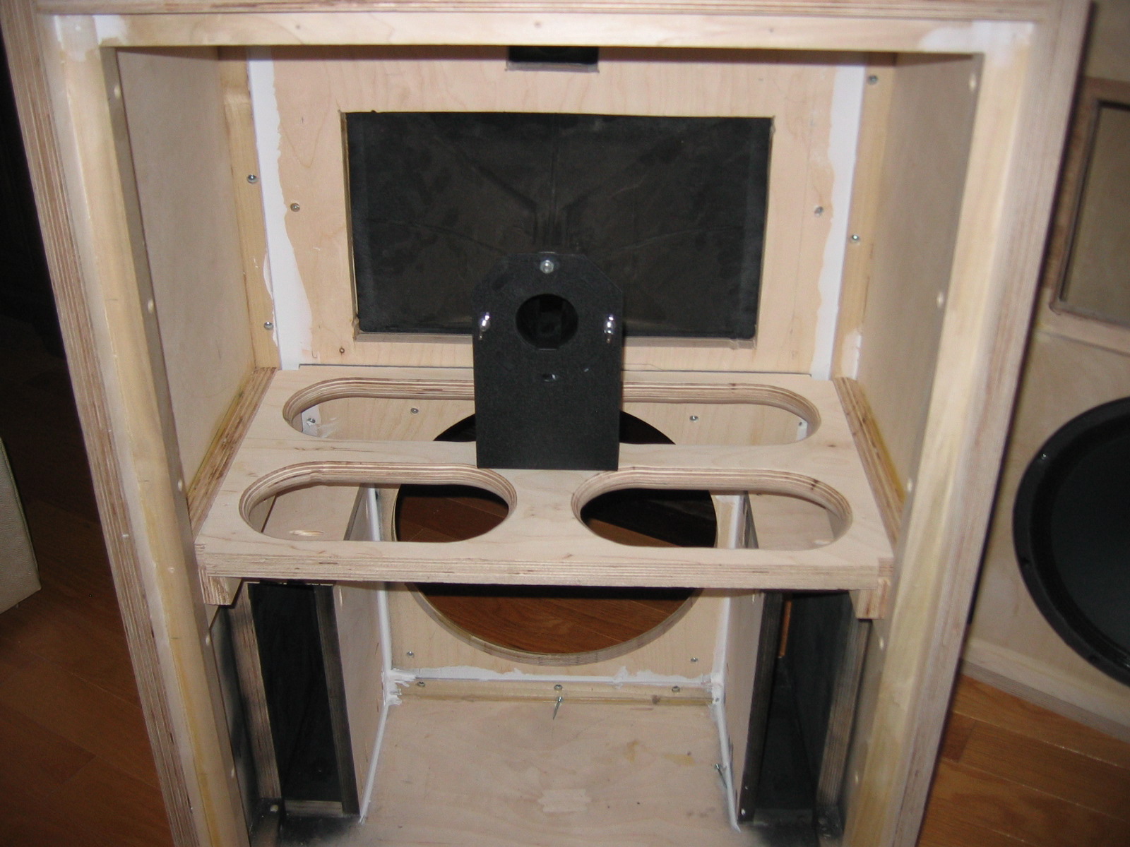

I did something similar when I built my Cornscalas a couple of years go.
As you can see, it also makes an ideal way to support the horn and driver, and in the case of the 4Pi a nice platform to lay the insulation on.
index.php?t=getfile&id=1350&private=0
Mind you, the Cornscala Brace pictured above has a larger footprint than the 4Pis will have...
13.5" deep x 23.75" wide, with 5" x 9.5" ovals.

That will work just fine.
