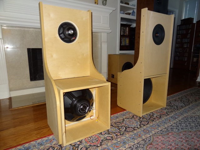

This is a reboot of a topic I initially discussed on the LSAF 2013 thread. I don't want to hijack that thread with too much discussion about one DIY project, so I'm restarting it here. The speaker project incorporates open back Dayton Audio PS220-8 8" Point Source Full-Range Neo Drivers with H-Frame mounted Eminence Alpha 15's as subwoofers. A DEQX digital processor is used as the elctronic crossover and for equalization.
Here's a picture of the two speakers with the drivers mounted but not wired:
index.php?t=getfile&id=1026&private=0

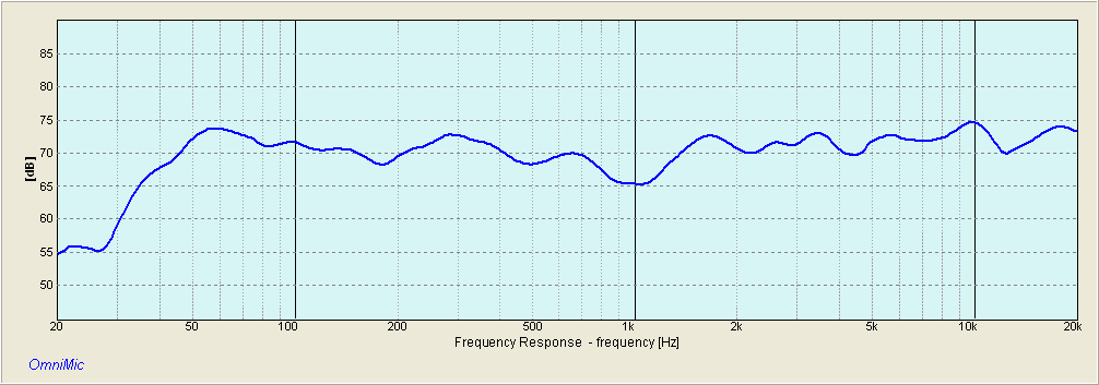

I wired them up this morning and connected them to the system. Just to get started I set the crossovers for 150hz, using a 48dB LR slope for the subwoofers and a 24dB slope for the full range drivers. Measurement revealed the full range drivers were about 5dB more sensitive than the subwoofers, so I added a 5dB boost to the subs. Here's the measured in-room frequency response of one speaker, on axis, with no equalization.
index.php?t=getfile&id=1027&private=0

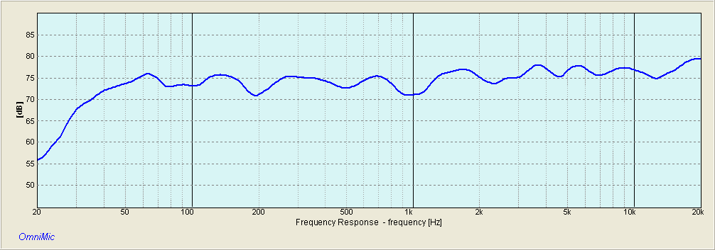

Here's the measured response with some equalization added. The next step will be to get about 25 hours of time on them before further tweaking.
index.php?t=getfile&id=1028&private=0

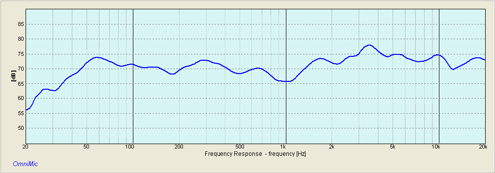

Here's a frequency response graph, with the mic positioned at ear level (35" from floor), 40" from the Dayton driver, about five degrees off axis, without the notch filter, using 1/6 octave smoothing.
index.php?t=getfile&id=1045&private=0

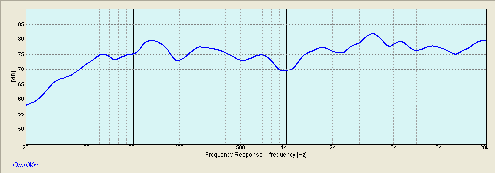

The same, but with the notch filter installed.
index.php?t=getfile&id=1046&private=0

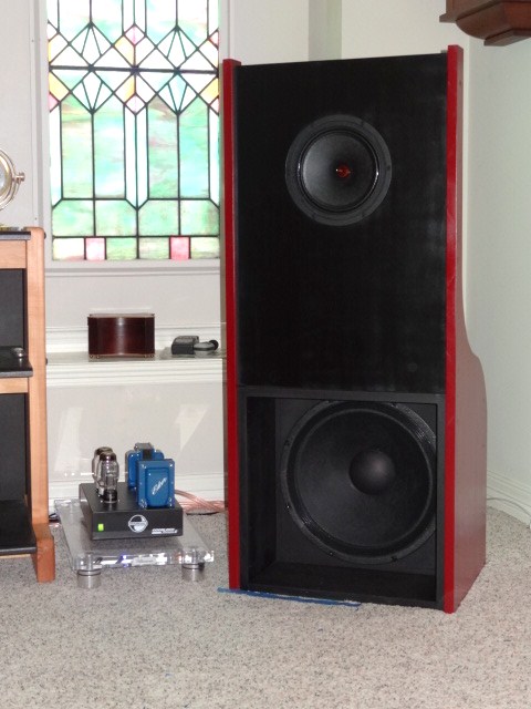

Finally put some lipstick on them.
index.php?t=getfile&id=1081&private=0
