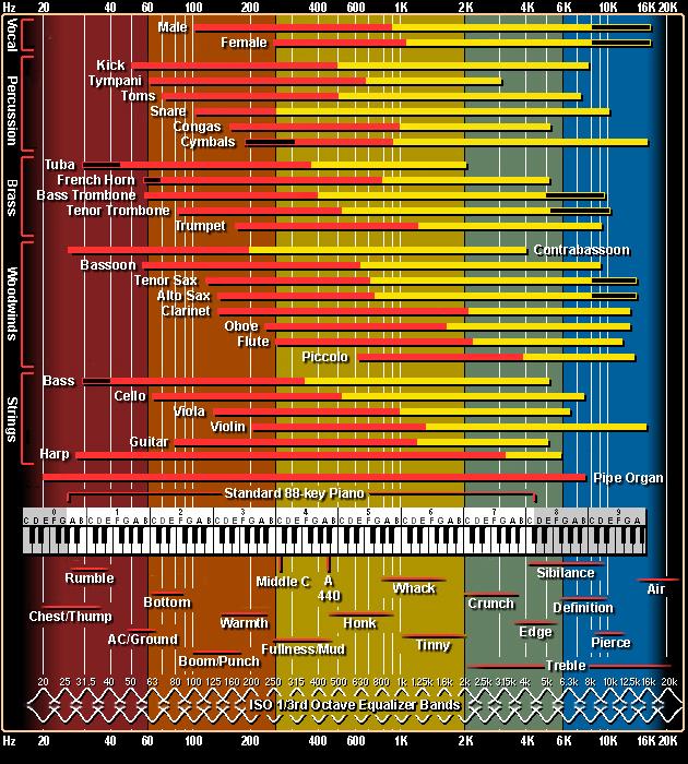

I suppose you could send a summed signal to flanking subs, and it would probably work pretty well in most cases.
The problem is that lower-midrange content panned hard left or hard right would go to both flanking subs even though only one of the mains would receive the signal. So the lower midrange coming from the flanking sub on the "off" side would probably sound unnatural to most people. It would sound like a rumbly "echo" on the wrong side.
Flanking subs get the lowest part of the vocal range, almost enough to be able to make out words if volume is high enough. They're designed to generate output well above 100Hz, up to 150Hz and sometimes higher.
The first two octaves from a piano come from flanking subs. Lots of instruments play in this range - See the red and orange areas in the chart below. All of the red and most of the orange comes from flanking subs. Since they are sent a low-passed copy of the main speaker they are flanking, and since they are fairly close together - just a few feet away - the mains and their flanking subs blend seamlessly and give the impression of a single sound source. But it only works as designed when the flanking subs are sent a low-passed copy of the mains they're flanking.
So anyway, try using the summed signal and see what you think. It's an easy experiment. Just setup the subs flanking the mains, and set the LFE channel crossover to a fairly high frequency. I think in most cases, it will sound fine that way. Most times, the mains get a signal that is pretty similar at bass and low midrange frequencies. But those rare moments where low-midrange content is panned hard-right or hard-left will probably be noticeable to you, and drive you to lower the low-pass frequency for the LFE channel.
That's the right thing to do for a traditional subwoofer, of course. You want the low-pass filter set no higher than 80Hz or 100Hz. That's true for distributed subs in a multisub arrangement too. Only the red areas in the chart below get sent to traditional subs and distributed subs. But flanking subs serve a little bit different purpose. They're run higher than normal, and so can be localized if they're too far away from the main speaker they're flanking.

Wayne Parham wrote on Mon, 28 January 2013 16:47
index.php?t=getfile&id=999&private=0

I think if it works, then it's a good solution. Modal smoothing with dense interference is as much an art as a science. I mean, there's "science" in it, of course, but we're mitigating interference problems rather than solving them, so it's a solution that has many possible paths. Whatever makes the modal range act more like the statistical range is what we want.
Flanking subs and distributed subs have some similarities and some differences. The main similarity is that sound sources are blended. The difference is flanking subs are pretty much tied to the mains they're flanking but distributed subs are not.
Down low, you really can put sound sources all over the place - random, ordered, symmetrical, asymmetrical - and you can expect it to work pretty well. If you optimize source positions with measurements, all the better. Smoothing can be accomplished very nicely, and there is no chance of localization as long as the subs are low-passed below 100Hz.
The transition region is a little different because you can't put the helper woofers "just anywhere". They can't be far away, and they probably need to be symmetrical with respect to the mains. They need to be close to the mains, but far enough away to mitigate the self-interference notches from nearest boundaries. And the low-pass frequency has to be high enough to blend in the transition region, but low enough to let each of the mains become point sources from the Schroeder frequency upwards.
Essentially what we're doing here is making an array of speakers that is large and spatially-distant at low frequencies and becomes smaller and closer-spaced at transition frequencies. As the frequency rises into the statistical range, the array is faded out leaving only the point source mains.
