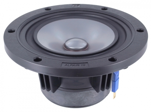

I believe I've decided what I'll bring to the AudioFred DIY room for the 2012 LSAF. I haven't built any single driver full range speakers in some time, and I've ordered a pair of Mark Audio Alpair 10.2 full range drivers, which I plan to use in Jim Griffin's MLTL design, built out of Baltic birch plywood.
After a first listen I'll have to decide whether to add a baffles step compensation network. I prefer most single drivers with this, but it's upsetting to see the purists running from the room with their hands covering their ears repeating over and over again "must remain pure, must remain pure..."
http://homepage.mac.com/tlinespeakers/FAL/downloads/Griffin-A10-MLTL-030611.pdf
index.php?t=getfile&id=656&private=0
