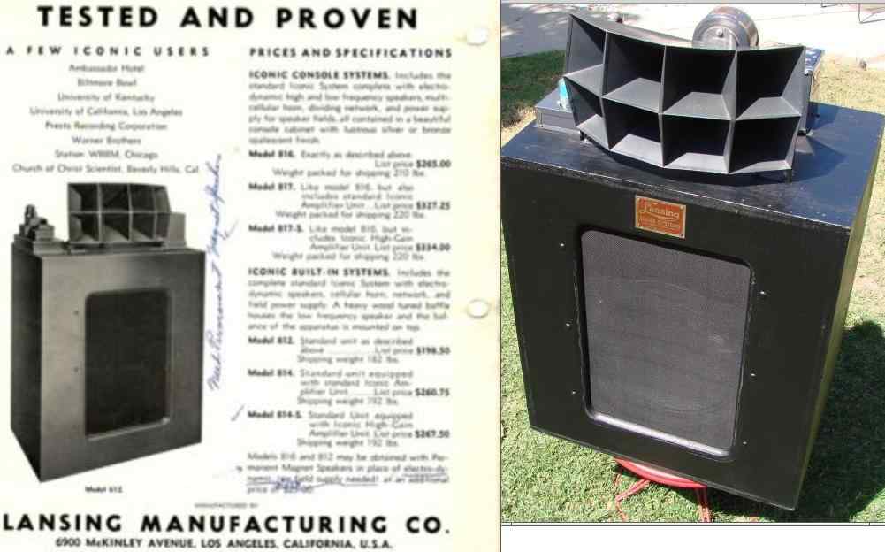

Advance apology for an apparent troll but it's just honest ignorance in its native habitat.
Been all over the map trying to answer a sort of simple question caused by stumbling on this catalog page tonight.
index.php?t=getfile&id=669&private=0
Basically, if we're 47 years past this, how come we need LF (and/or HF) reinforcement, too? Not talking about a specific design, more the whole type. Is it just different priorities or is it something else?
Do people not make parts that'll do that anymore?
Were those just marketing claims (and maybe optimistic)?
Did they not care as much about pattern and traded a hole at xo?
Do people hate big cabs so much that they trade LF and efficiency?
Do "2-way people" all use them for HT so subs are already there?
Do current preferences align more for clarity from swanky motors than FR?
on and on--I got a million of 'em, but that's sort of my point.
As near as I can tell, people have been making reflex + horn boxes for almost 80 years
index.php?t=getfile&id=670&private=0
The priorites have moved a few times already. But, save for adopting some whole other thing, why do people seem to forego wider range responses?
Even granting bunches of money--for example, those nice-motored midbass drivers are not so inexpensive--and we still need bass supplementation (?)
Do the current standards for acceptable clarity at higher efficiency preclude reaching lower even in giant boxes even when granted non-trivial expense?
I mean, why work soooo hard on driver spacing and phase and waveguides and all that--just to be band-limited and need one or both ends to be supplemented?
Is it just because the drivers don't sort neatly into higher-volume "pro" or "auto" categories so there's just not work being done in those areas?
At least these are what I'm wrestling with...not pointing at any one thing, just the "2-way way" in the higher-efficiency sandbox.
Thanks for the bandwidth, the time, and the education.

Altec made excellent speakers in that era. Not too bad by today's standards either. But they definitely don't compare with a properly designed modern matched-directivity two-way (waveguide) loudspeaker, even though they look similar.
The following document tells you why, and even has a little bit of history too. You'll probably recognize an Altec horn in this whitepaper:
The differences are mainly the result of iterative improvements, not so much a paradigm shift. What Altec was trying to do in the 1950s is pretty much the same idea today. We're just better at it.
Top-of-the-line modern drivers provide smoother response, lower distortion, higher SPL and dynamic range. Modern horn/waveguides have less internal reflections and are also able to generate a more constant pattern, one with fewer coverage holes. Crossovers are more thoroughly optimized too, made possible using today's acccurate measurement systems. As a result, response is better and the coverage pattern is more uniform.
As for the matter of subs verses mains with deeper extension, to me, there is no question which is better. There are several qualitative reasons to split the deepest bass out to subs. Distortion (both harmonic and intermodulation) is reduced by splittiing the band and using dedicated subs. But the biggest improvement, in my opinion, is modal smoothing. See the following thread for more information about using distributed bass sound sources to smooth room modes:

No offense taken. Comparisons with other loudspeakers are common, especially Altec and Klipsch. Each has a lot in common. My designs are more refined, but that's because they're more modern and I could take advantage or better drivers and better design tools. I truly stand on the shoulders of those earlier designs. The Klipsch cornerhorn was the inspiration for my constant directivity cornerhorn designs. Altec published a document that described how to aim the forward lobe by reversing phase and looking for the deepest notch. JBL went a step further in their whitepaper about the 4430. Each of these were pioneering efforts in their time, and I base my work on them, using those as a sort of starting point. So it's good to bring them up, and it makes a nice segue for discussion.
