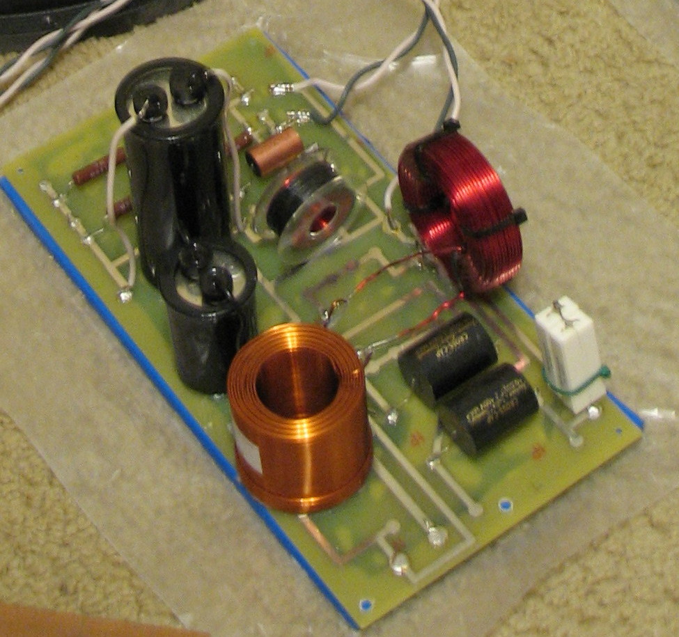

There are sooo many of us using 4Pi crossovers, both old and new, with 2226Js from the Tent Sale. Wayne gave me some custom coil values for mine when the new boards came out; I think they were mainly doubling the values of the coils. Who doesn't not like "big-uns"? Laughing
index.php?t=getfile&id=328&private=0
