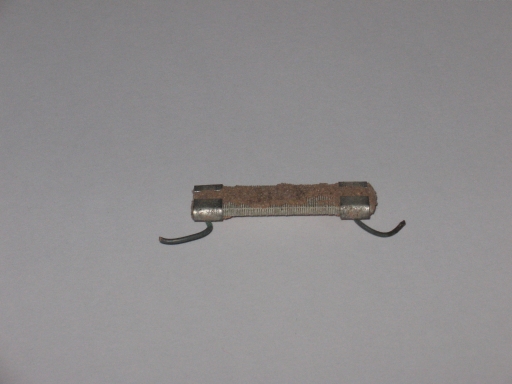

I have the necessary capacitors to complete the "re-cap" and a new silicon diode to replace the rectifier, but there are a couple of pieces that I do not know how to identify. I clipped a piece attached directly to the positive end of the rectifier, it seems corroded.
index.php?t=getfile&id=251&private=0
index.php?t=getfile&id=252&private=0
From the schematic, my best guess is that this is a resistor? Also, do I need to replace the power resistor unit that is grommited to the chasis?

That's awesome! I have a couple Transoceanics and they're very good radios.
Yes, that part you have is a resistor. Is it bad? I'd probably measure acrosss it to see, and only replace it if it's bad. I tend to swap caps blindly on old radios like that, because they're almost always bad. But wirewound resistors like that don't go bad with age.

Thank you for the response. I tested that resistor and it appears to be bad - no resistance across the leads! I am also curious if you've seen capacitors like the green ones on the right side of the picture in the original post (attached to the ocs. coil). I think they are represented in the schematic by the 150 MMF capacitors, but I haven't been able to confirm that by internet research, and that stripe pattern doesn't seem to match the values on the schematic with any stripe rating schedule I've found.
