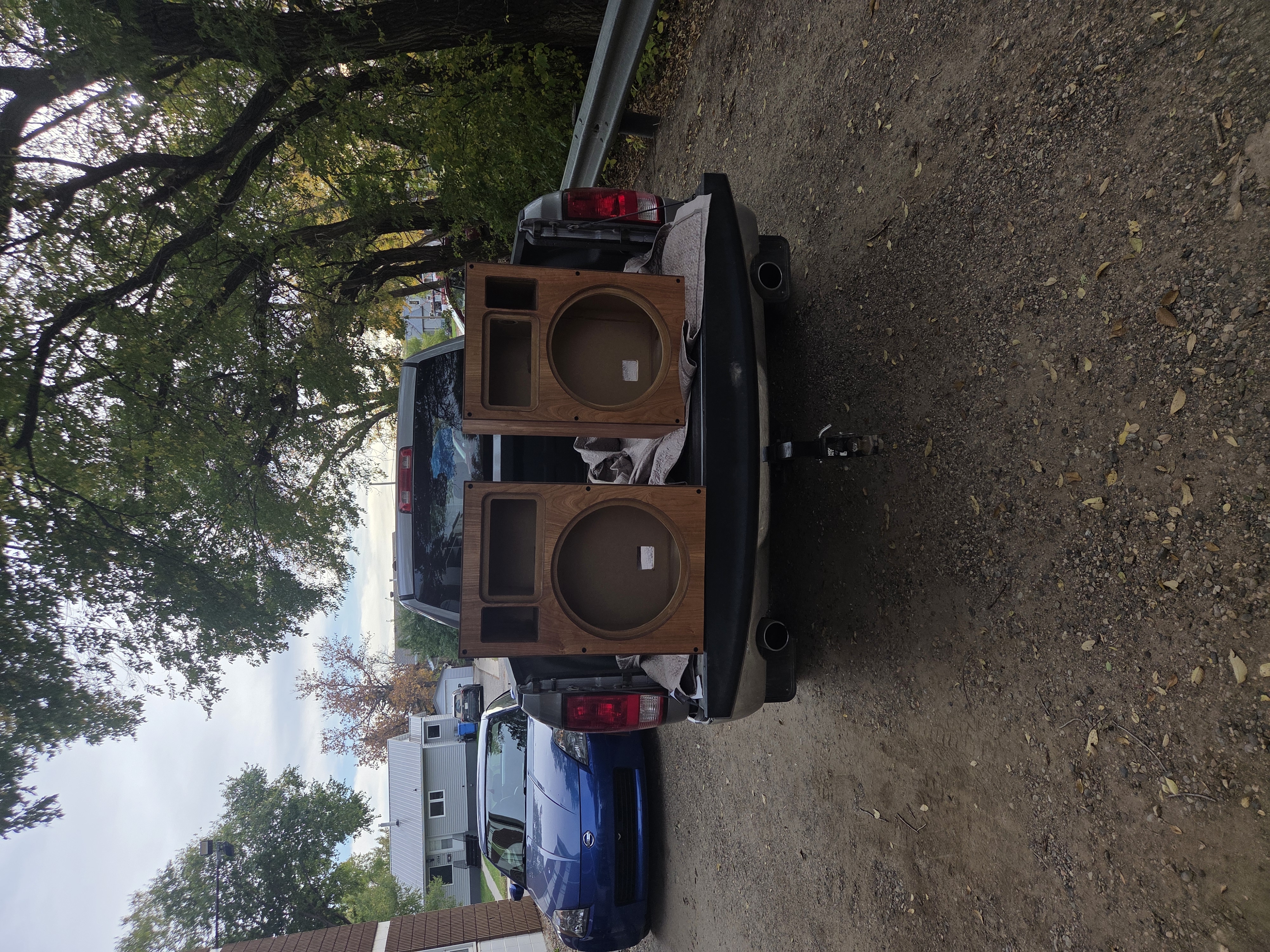

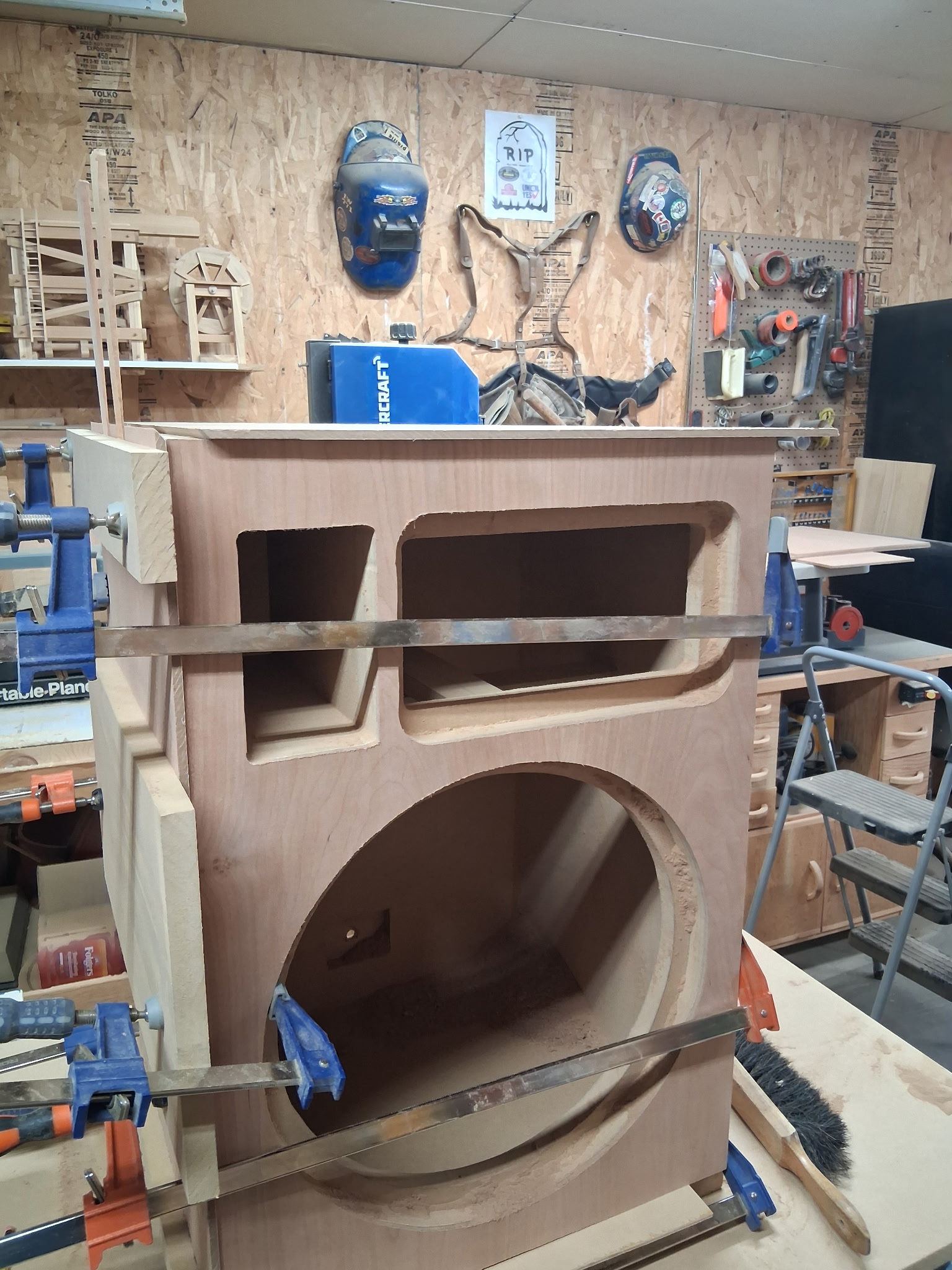

I also decided to have the cabinets professionally built rather than compromise on the woodworking. I wanted the dimensions, construction, bracing and internal damping to follow your design as closely as possible. Cherry veneer was my choice for the finish.
Along the way, I learned quite a bit about how much thought goes into a proper loudspeaker design. Cabinet volume, port tuning, bracing, damping, driver integration and crossover behavior all started making more sense to me.

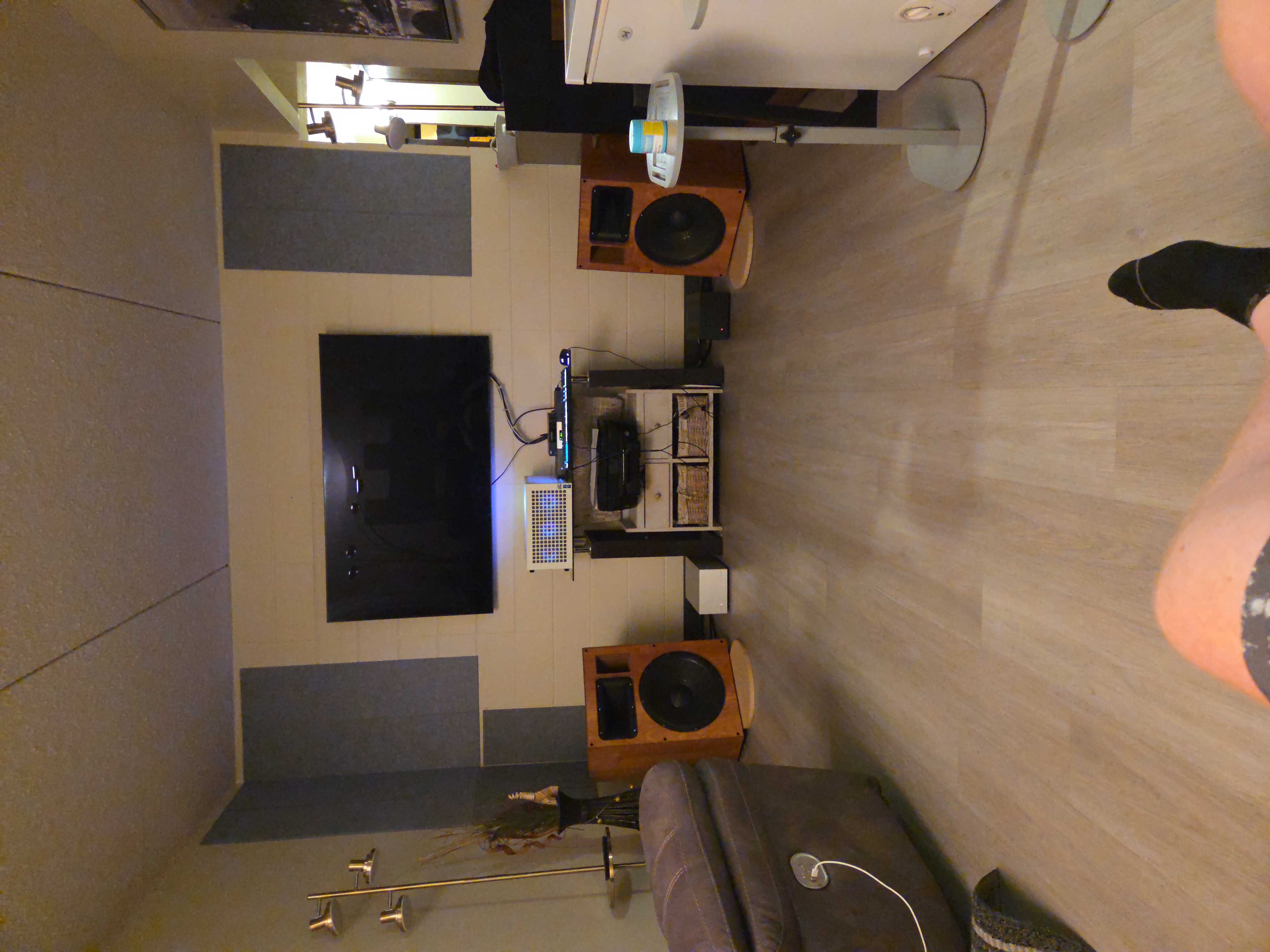

I've also been experimenting with speaker positioning. Initially I had the cabinets facing straight ahead, but introducing roughly 30 degrees of toe-in made a substantial improvement.
The imaging became much more focused, with vocals appearing solidly centered in front of me. The soundstage seems much better organized, and voices have an almost tangible presence.
I've been using them for movies as well, and that has been another revelation. Dialogue is beautifully focused, effects have enormous dynamic impact, and the overall presentation is incredibly convincing.
My system consists of Audiolab 8200MB monoblocks and an SMSL VMV D1SE2 DAC. I've been experimenting with the DAC's digital filters, and the four Pis are revealing enough that those differences are quite apparent. With the Linear Fast filter, I particularly enjoy the additional sense of precision and definition without losing the naturalness of the speakers.
