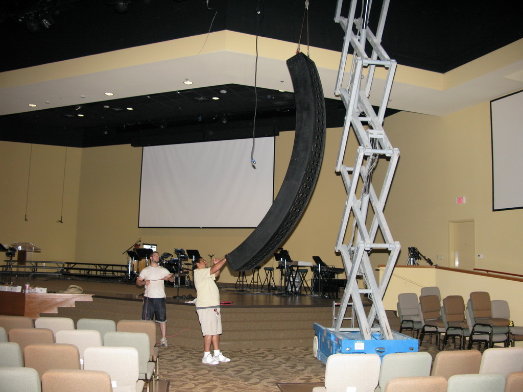

Here's a picture of an array that I helped build for my church. This is probably larger than what you may need (sanctuary seats 1,000)but you could build the same thing on a smaller scale. The design is based on the CBT (constant beamwidth technology)research of DB Keele.

That's massive!!! What size and how many drivers? I thought about curving the front baffle of course mine would curve the other direction but I wanted to keep things as compact as possible. I'm assuming if I wanted to curve the array for time alignment with a 7.5' line that would be quite a curve. I'm also not sure what the consequences of a curve would be in the far field and how it would affect the vertical dispersion.
56 5" woofers and 22 ribbon tweeters. The beauty of this design is that you can control the coverage extremely well. I don't have a picture but we also built three smaller ones for stage monitors.
