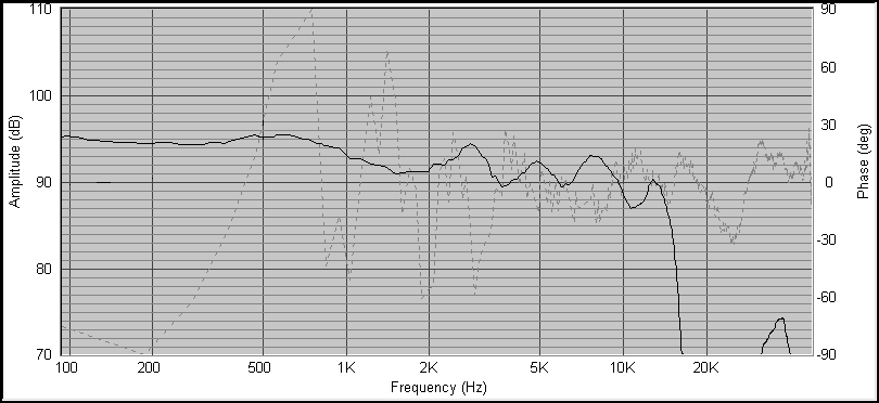

Hi Wayne:
I was browsing your measurements folder and was a little surprised by the way the slope of the Pi Seven declines as frequency increases, and by the rapid rolloff of the tweeter at about 15KHz.
Can you explain the reasons? I'm just trying to understand the likely sound prior to making the commitment to build, and I have been under the impression that generally speaking one aims for a frequency response that is roughly flat to 20KHz, and that some people are even aiming for much higher frequencies with supertweeters.
Thanks,
tim

That's just the nature of compression horns. They don't get much above 16kHz or so. Some people add super-tweeters, others don't feel the need. I personally would prefer a bit more on the top end, but not at the expense of integration. It's hard to seamlessly match a super-tweeter because wavelengths are so short at the crossover point.

OK, I understand the top end piece. What about the more gradual slope from 500Hz to 15KHz? Is that an intended balance, or just something that's too small to notice in real life?

You're right, there's an overall trend, sloping downward about 5dB over the audio band. It's within a +/-6dB window up to the top octave, but there's a general slight sloping downward. I think it's a very natural sound.

It all depends in the horn being used. For that fact, to have more high frequencies and if I was Tim, I would use SELENIUM D210Ti driver instead of Eminence PSD2002. Again, the listening window is so narrow at 16KHz that it's only 15º to the left and 15º to the right from the speaker (sweet-spot). Another way is to go with a speaker including the Vifa tweeter, flat to 20KHz and a real Hi-Fi home-runner with a large listening window both vertical and horizontal.

Dome tweeters actually have pretty narrow radiation patterns at high frequency. Intuitively, it looks like they would radiate an omnidirectional pattern but they exhibit collapsing DI according to radiator size.
LMS measurements show the response of the new π wood tweeter horn is virtually the same off-axis within a 90° x 40° angle as on-axis, even at HF above 10kHz. Response above 5kHz falls at vertical angles larger than that. I didn't measure other horns to see how they compare.
