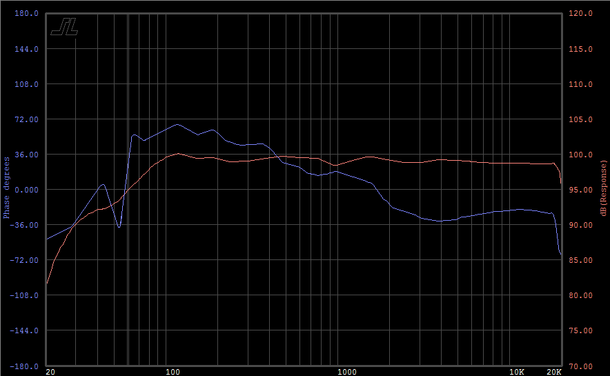

Whichever way you go, small and short or large and deep, pay attention to the phase between woofer and tweeter when designing the crossover. Whether measuring the forward lobe using the top/bottom process I described in the video clip above, or by doing the reverse connection method to find its center, be careful to find whether the two sound sources are truly on the same cycle, and not shifted by a full cycle or even a multi-cycle shift. You can estimate the acoustic centers and then calculate the phase between drivers through the crossover, but it is a meticulous process. An easier (and more accurate) method is to measure acoustic phase.
The goal is to have acoustic phase within 90° through the audio band. If you see phase shift rapidly in the crossover region, yet the reverse-connection method still shows a null on the baffle normal (straight-forward) axis, then there is a full cycle or a multi-cycle shift. This will usually show up as poor off-axis response, but will not show up in on-axis response.
This is an example of what you are looking for:
http://www.pispeakers.com/Measurements/fourPi_phase.gif
