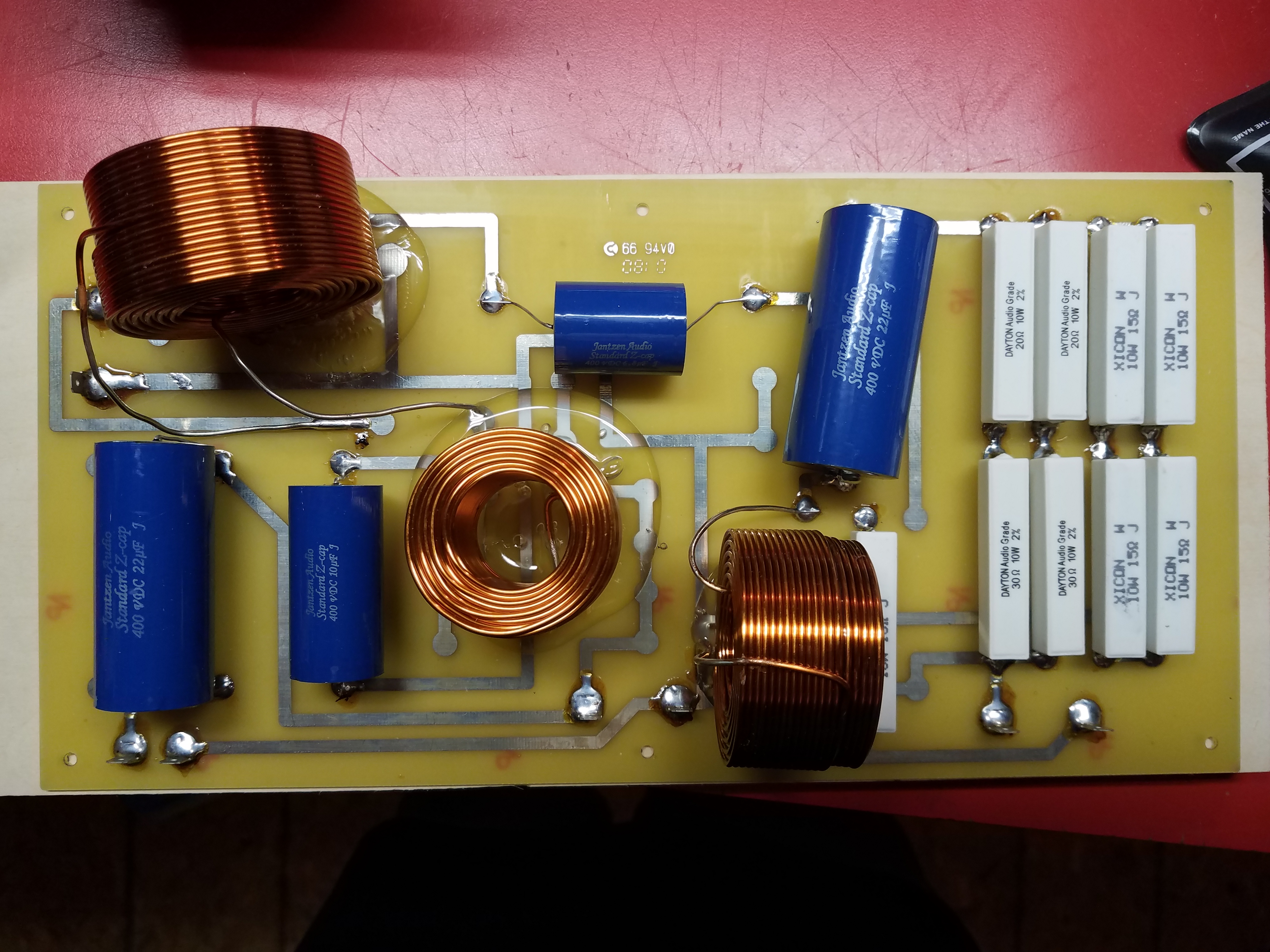

I bought the Four Pi crossovers quite a while ago and now I'm ready to hook them up... but which terminals are input, LF, and HF?

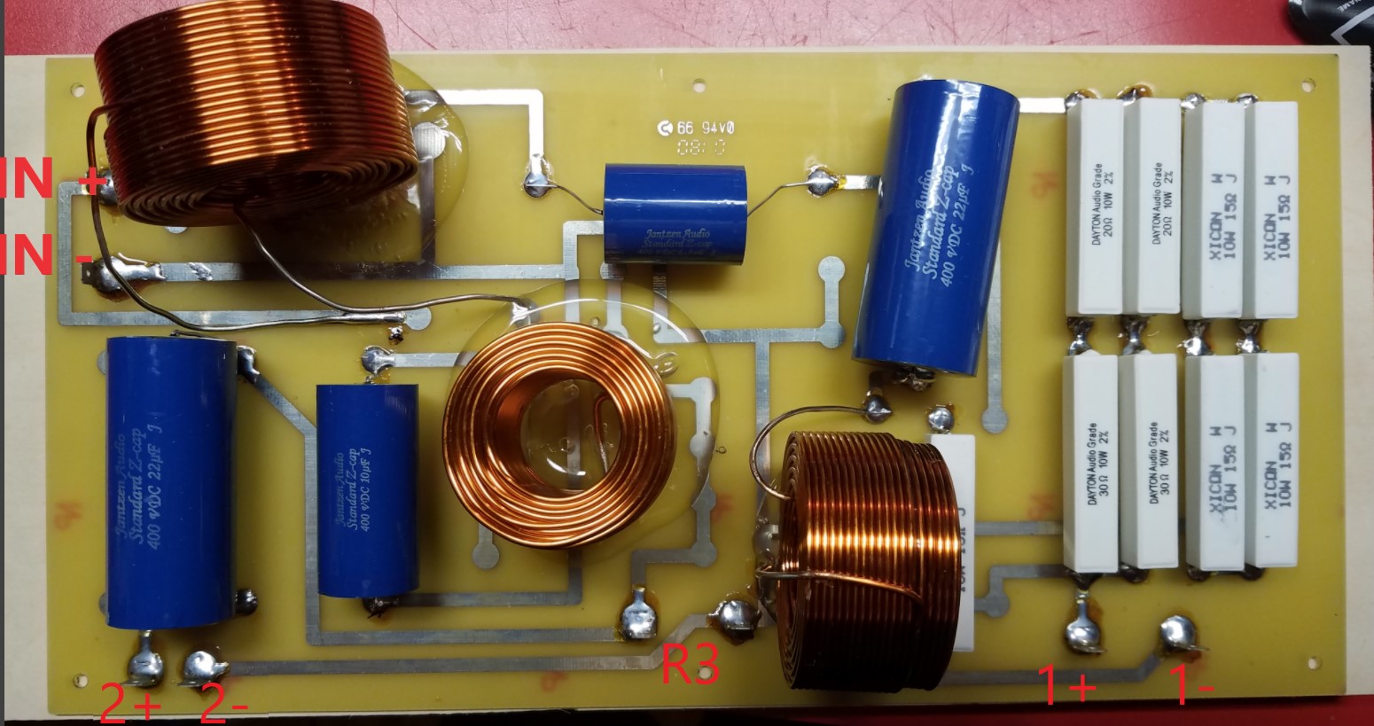

I stared at the schematic and I think I have it. With the paralleled resistors on the right, it goes like this:
IN + is top left
IN - is directly below it
2+ is bottom left
2- is immediately right of it
The connections for offboard R3 100w resistor are middle bottom.
1- is on the bottom right
1+ is just to the left of it.
/forum/index.php?t=getfile&id=2635&private=0
Re: Connections for Four Pi Crossover? [message #92308 is a reply to message #92306] Sun, 13 September 2020 12:17 Go to previous messageGo to next message
Messages: 18947
You're close. The image below shows the board layout, with the input labeled "IN," the tweeter output labeled "1" and the midwoofer output labeled "2." The Zobel connects to "R3" and polarity isn't important. Polarity is important for the midwoofer and tweeter. The 2226H black terminal goes to the "+" connector and the DE250 black terminal also goes to the "+" connector. This is the opposite of how most drivers are connected, but that's how it should be for those drivers. The input "+" connector goes to the amplifier's positive output post, which is usually red.
