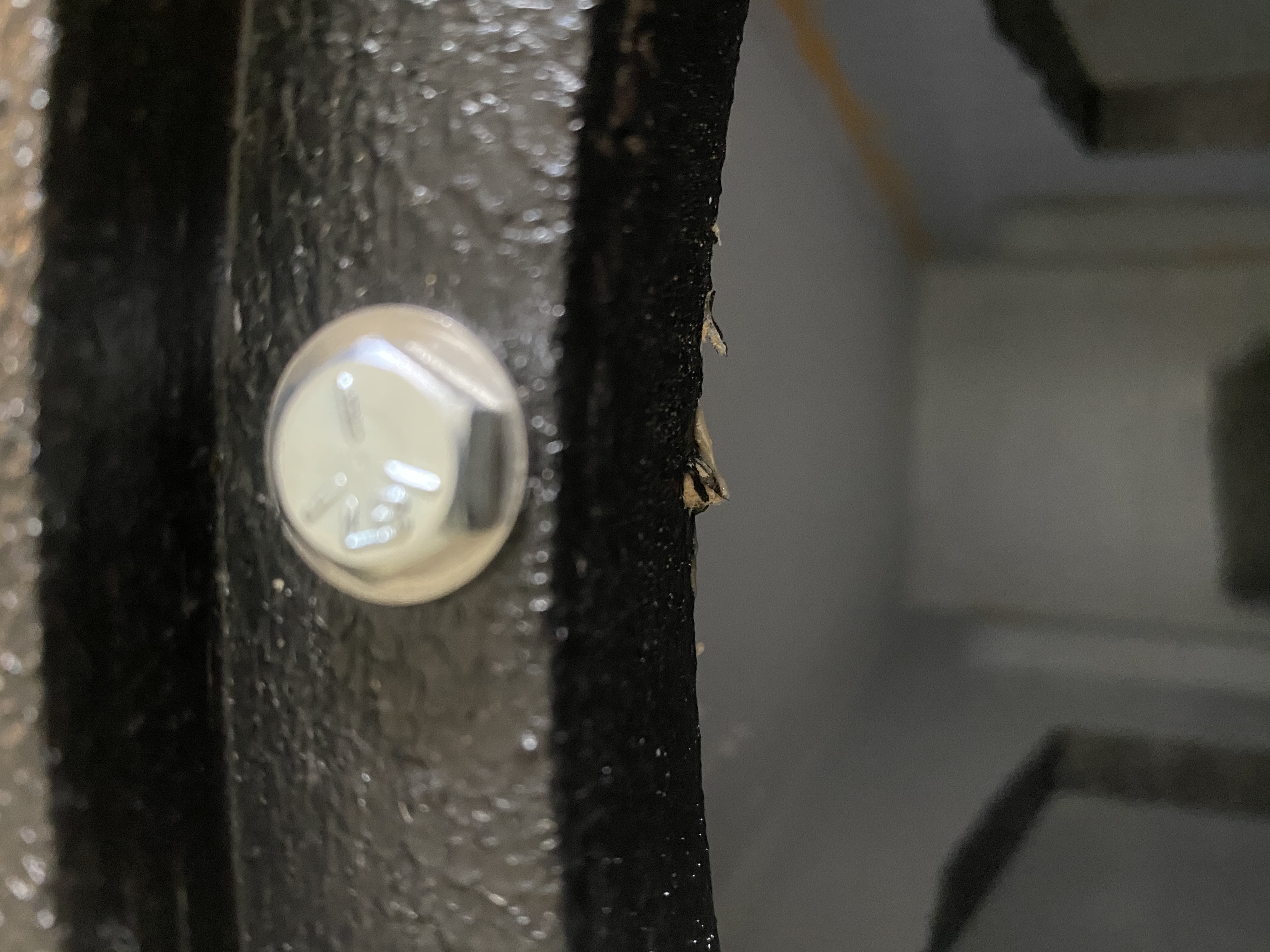

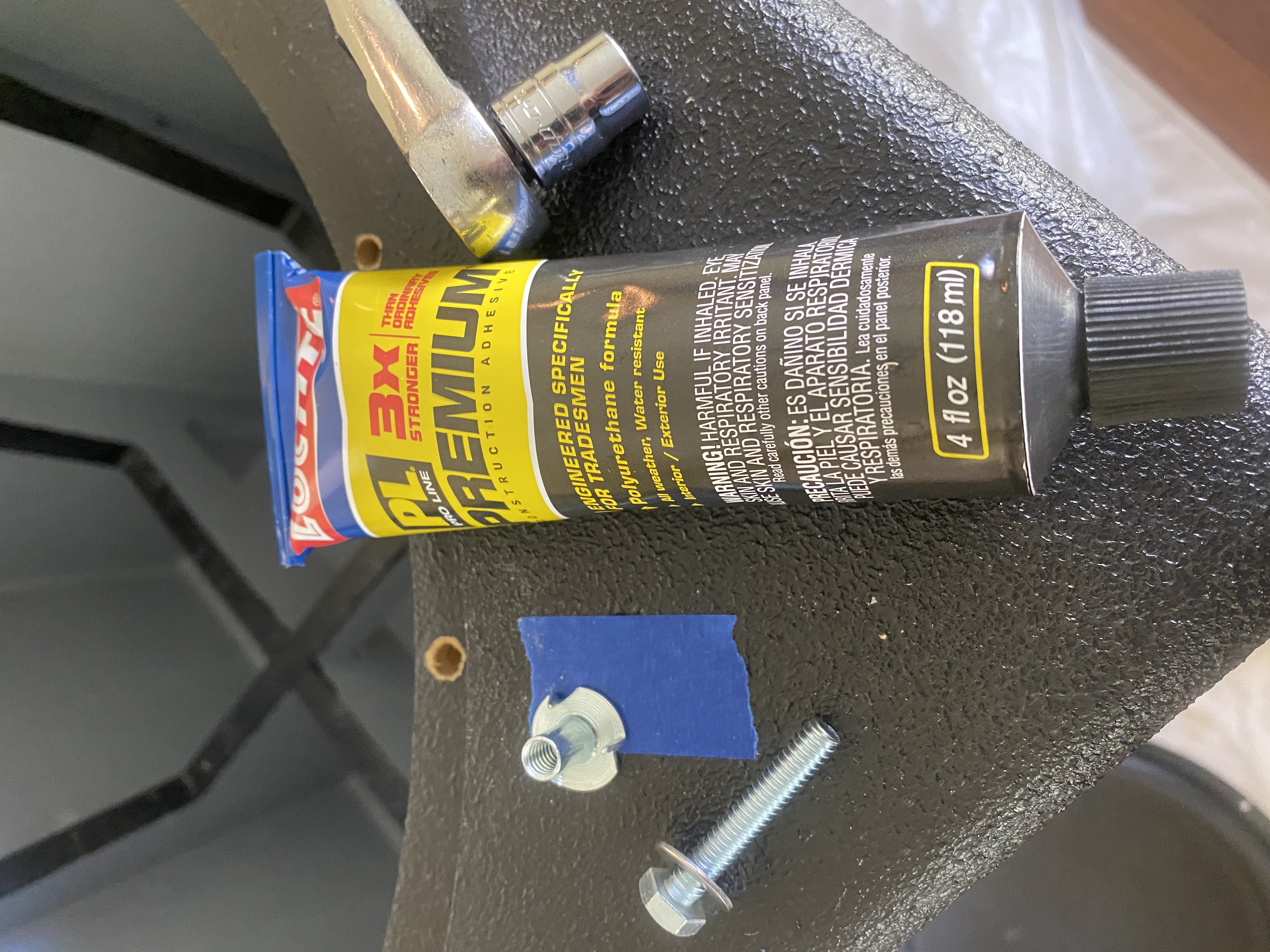

I really dislike drivers being held in with wood screws. If you ever need to remove a driver more than once, the hole is usually buggered up as it's not really made for multiple disassembly. So how does one deal with that? Tee Nuts! This is how I use them...
First you need to purchase some quality tee nuts as these are meant for a permanent installation. I will be using SHCS as my finish bolt to hold the 45 lb 18" driver in.
So you get the Tee Nuts and some basic grade 5 bolts with washers along with PL Adhesive as seen below. See where this is going?
/forum/index.php?t=getfile&id=2624&private=0
Re: 4pi flat pack, Rhino Line [message #92291 is a reply to message #92257] Wed, 09 September 2020 13:53 Go to previous messageGo to next message
Messages: 66
Registered: October 2009
Location: FL

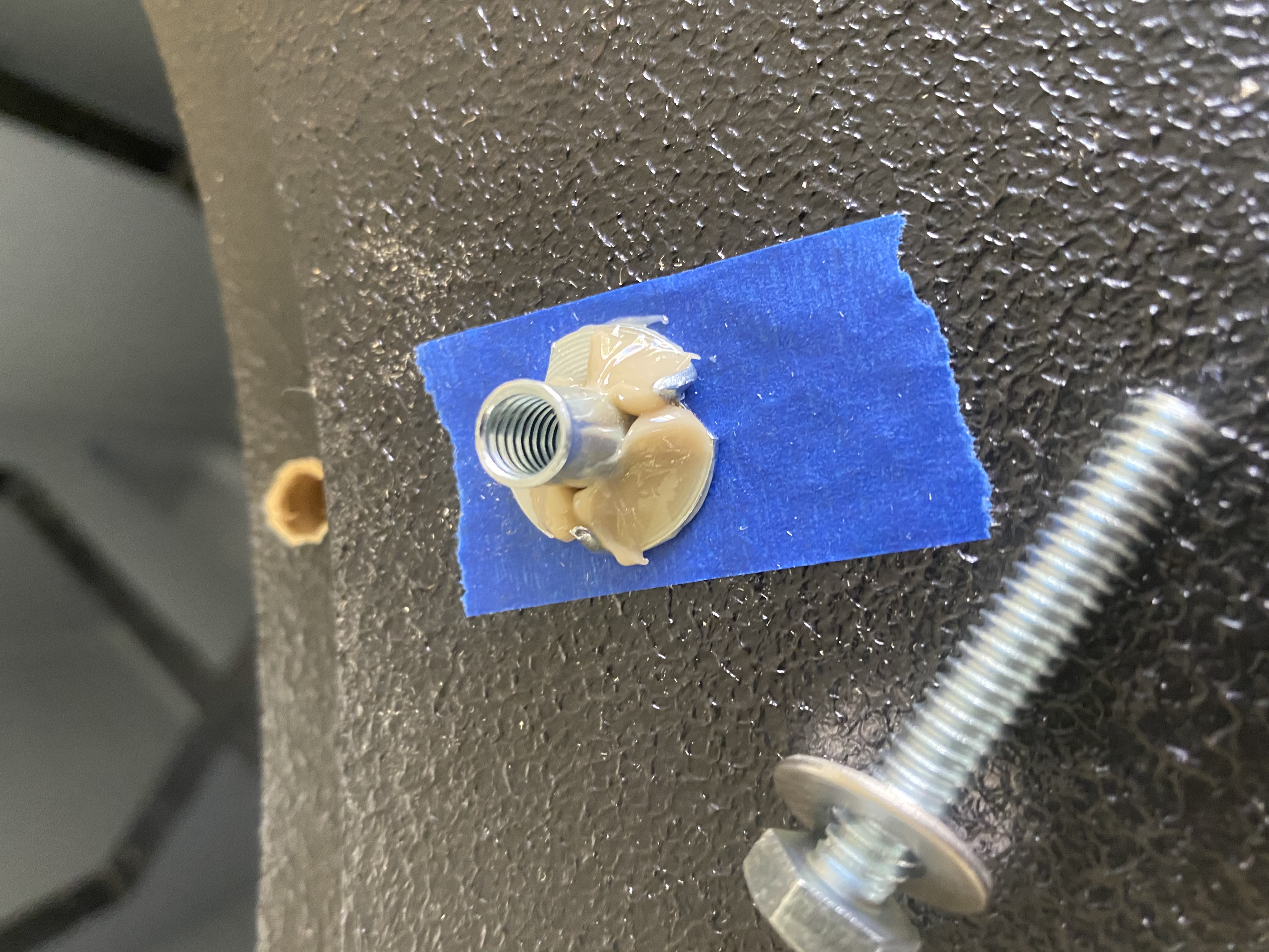

Now this is very important. If you get the PL on the threads of the Tee Nut, you're screwed! :nono:
So I put 3 dabs around the side of the Tee Nut like below.
/forum/index.php?t=getfile&id=2625&private=0

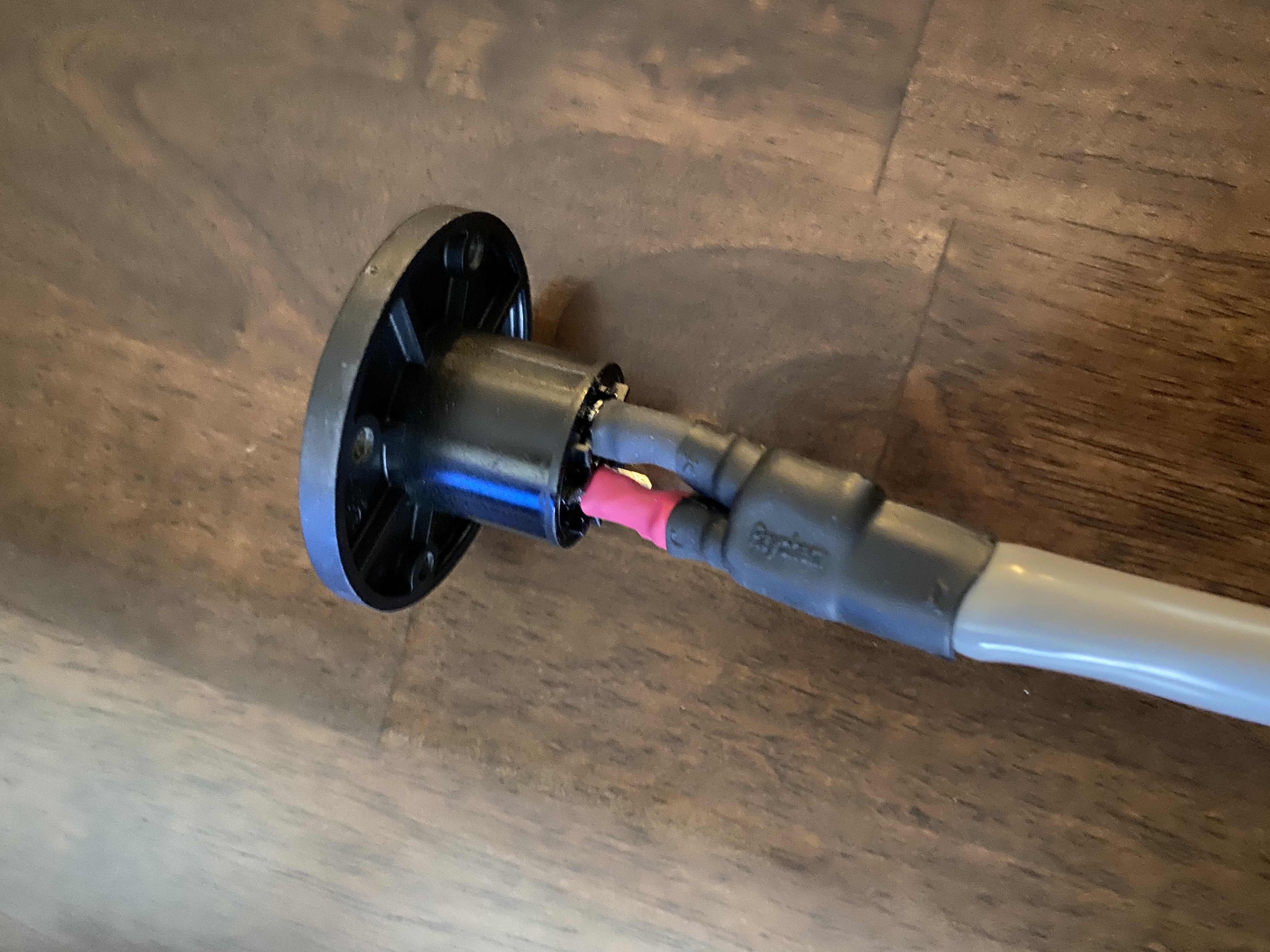

Next was to solder the Belden 1313A to the Neutrik speakON and install into the cabinet.
/forum/index.php?t=getfile&id=2628&private=0

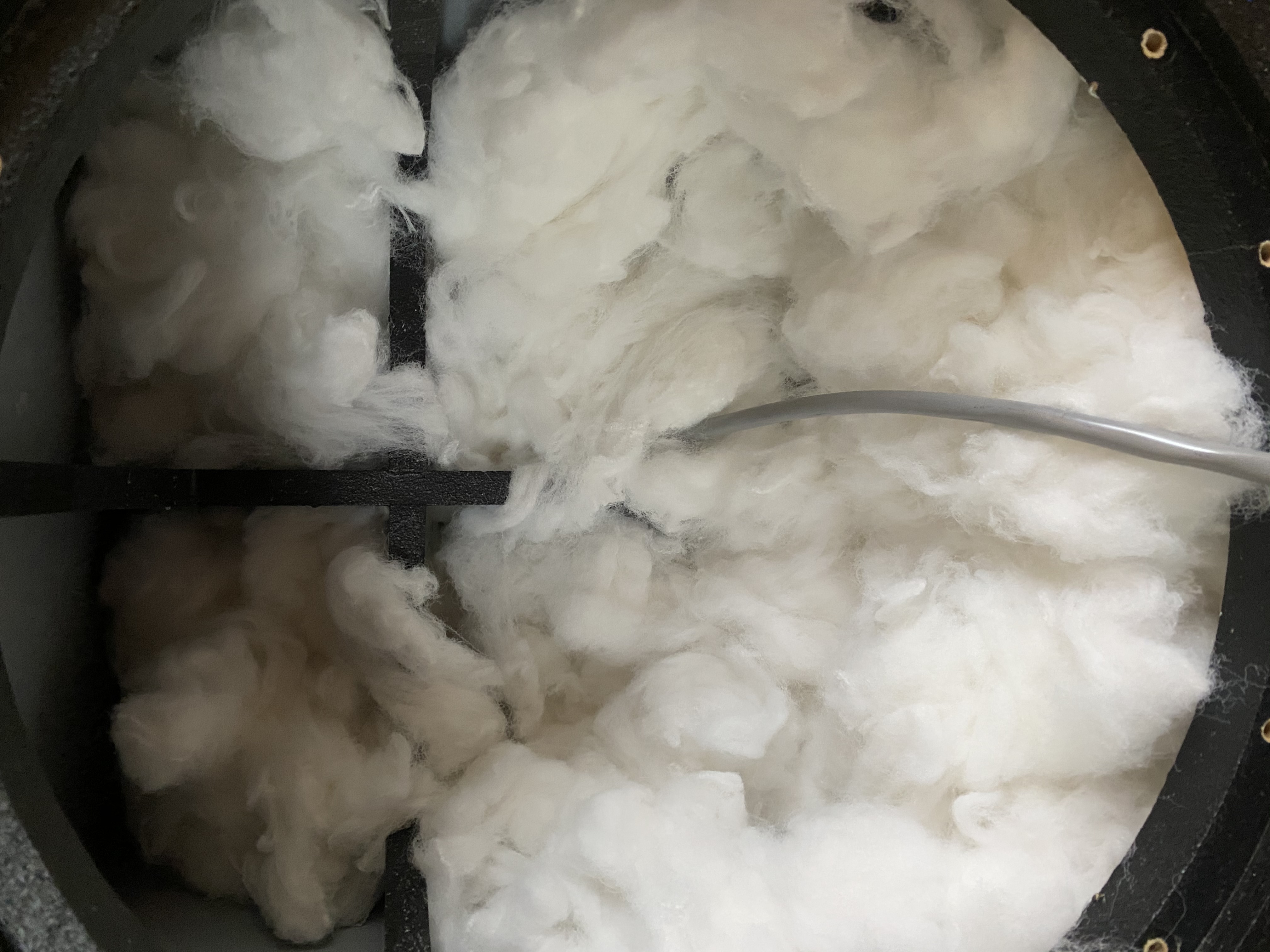

Stuff it!

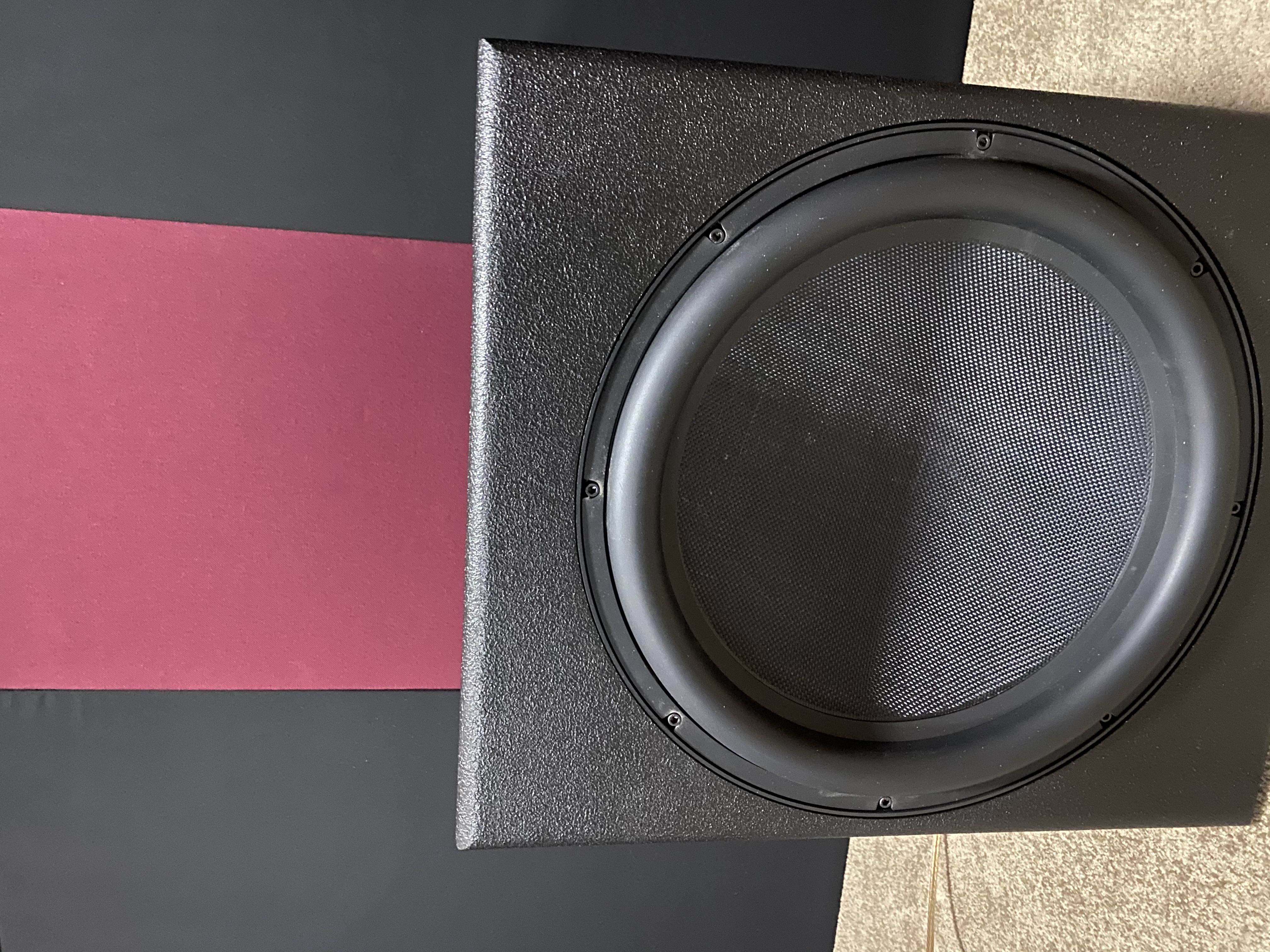

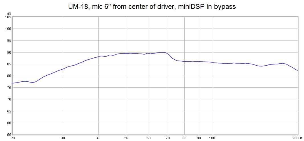

And finally the completed sub with a measurement:
/forum/index.php?t=getfile&id=2632&private=0
/forum/index.php?t=getfile&id=2633&private=0
