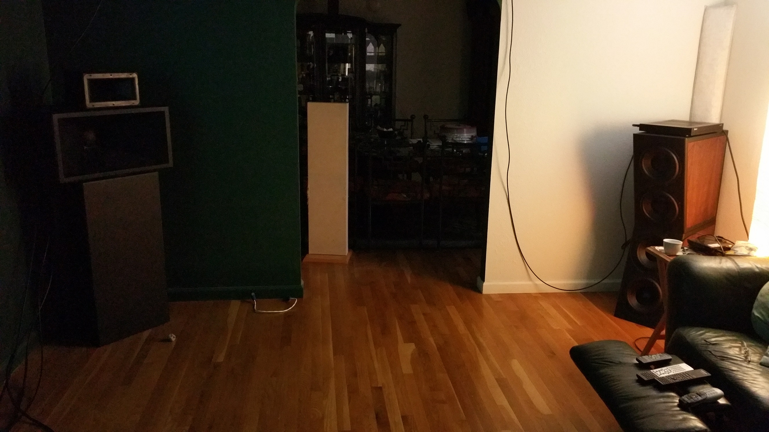

Re: 7Pi Build 2014 [message #80824 is a reply to message #80823] Wed, 12 November 2014 16:07 Go to previous messageGo to next message
Messages: 86
Registered: April 2014
Location: Auburn, CA USA
No I have not. I do have some very talented people at my disposal and pretty good ears though!
After playing with MiniDSP I can't imagine going back to passive. I just installed a pair of Nolte Audio 4X10" (per pair)175Lbs subs and I now have BASS!
index.php?t=getfile&id=1590&private=0

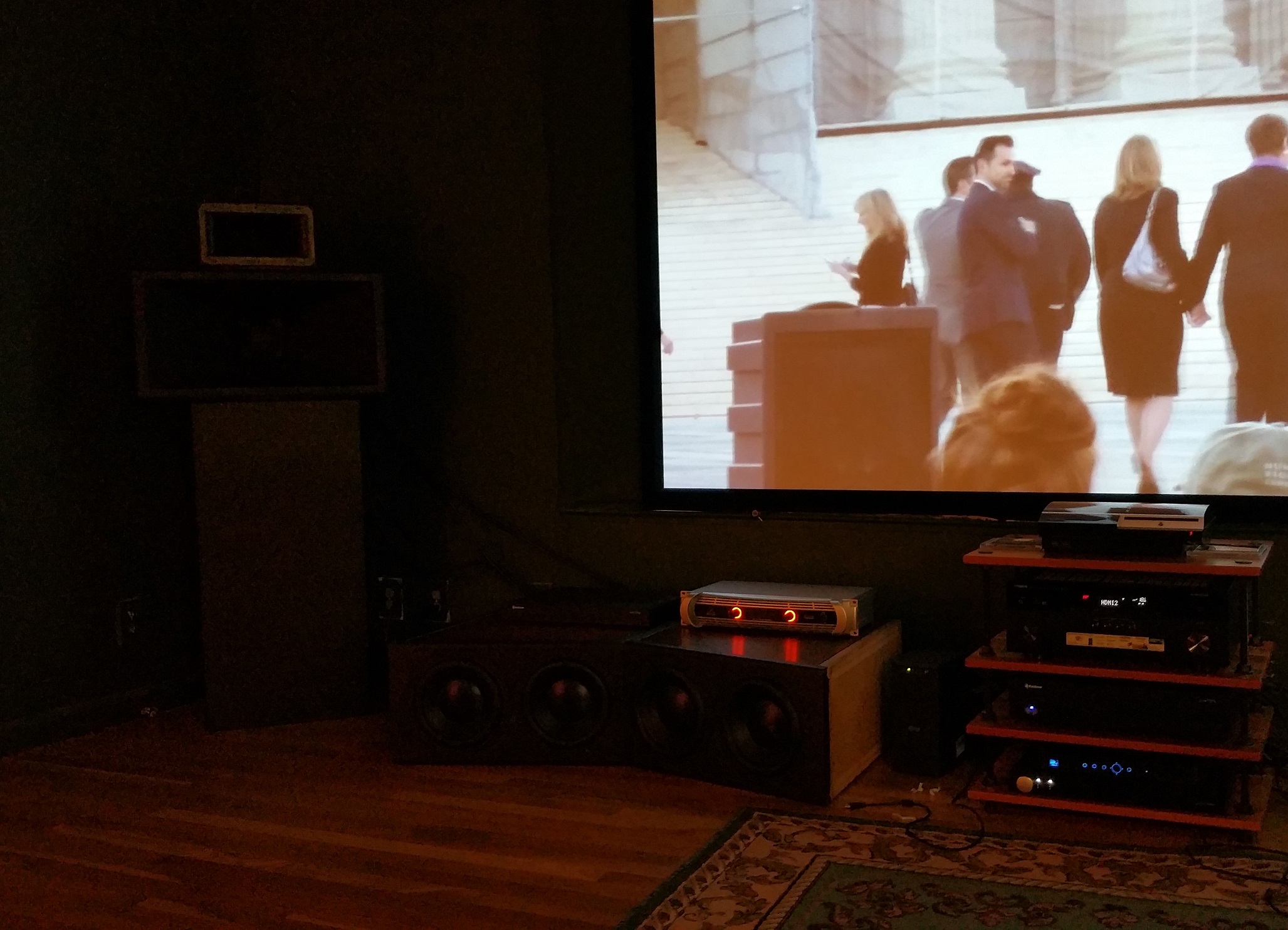

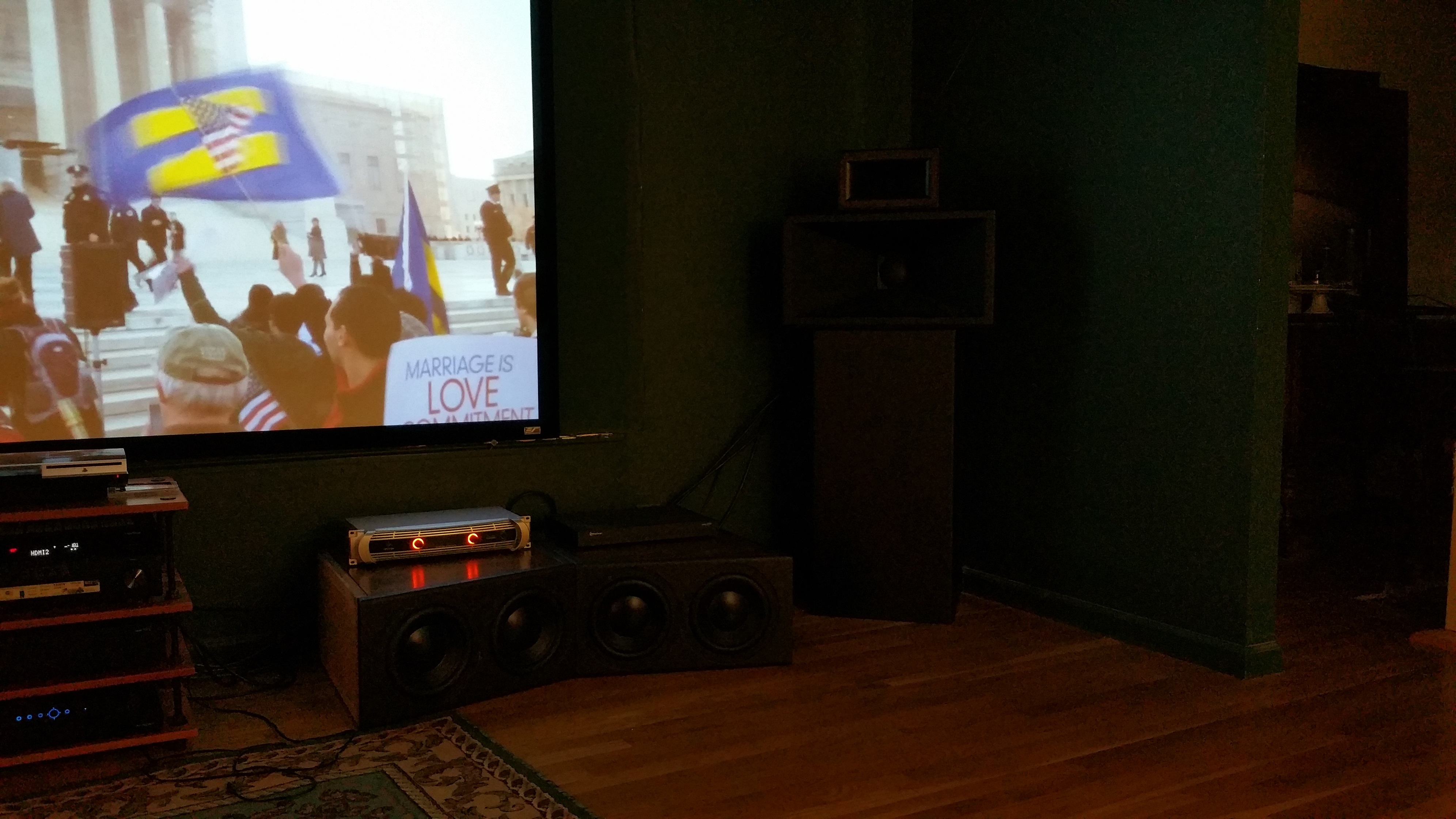

Re: 7Pi Build 2014 [message #80843 is a reply to message #80113] Sun, 16 November 2014 14:50 Go to previous messageGo to next message
Messages: 86
Success!
John Nolte of Nolte Audio came over and set up the MiniDSP crossover driver by driver. He used the same XO points as WP and measured and set thing up from there.
Spent all day tweeking, went out to dinner then sat down and listened for a while.
These are indeed very nice speakers.
Because of the design of the subs, we had to lay them down on the front wall. They don't seem to do anything bad in that position. The sealed subs are flat to 24Hz and make crazy amounts of bass.
We have not done any EQ at all and could walk away right now and be 100% satisfied.
index.php?t=getfile&id=1592&private=0
index.php?t=getfile&id=1593&private=0
