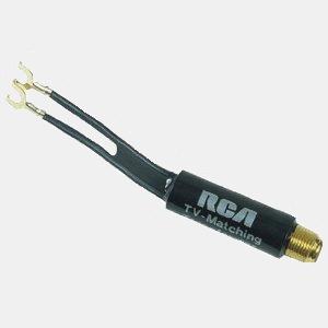

Speaking of cable TV isolators, what I always used were the old 75Ω/300Ω matching transformers. Now days, the isolators are probably becoming very common because most people are connecting their home theaters to cable TV. But not long ago, there wasn't such a thing to be found. So I used 75Ω/300Ω matching transformers instead. You need two: The 75->300, connected to the 300->75. It works great, only introduces a couple dB loss (which is probably the same as the isolators) so if you have any of the old matching transformers laying around from back in the analog antenna days, don't hesitate to use them.
index.php?t=getfile&id=980&private=0index.php?t=getfile&id=981&private=0
  • Attachment: 75.300.jpg
    (Size: 6.33KB, Downloaded 5155 times)
  • Attachment: 300.75.jpg
    (Size: 4.62KB, Downloaded 5071 times)

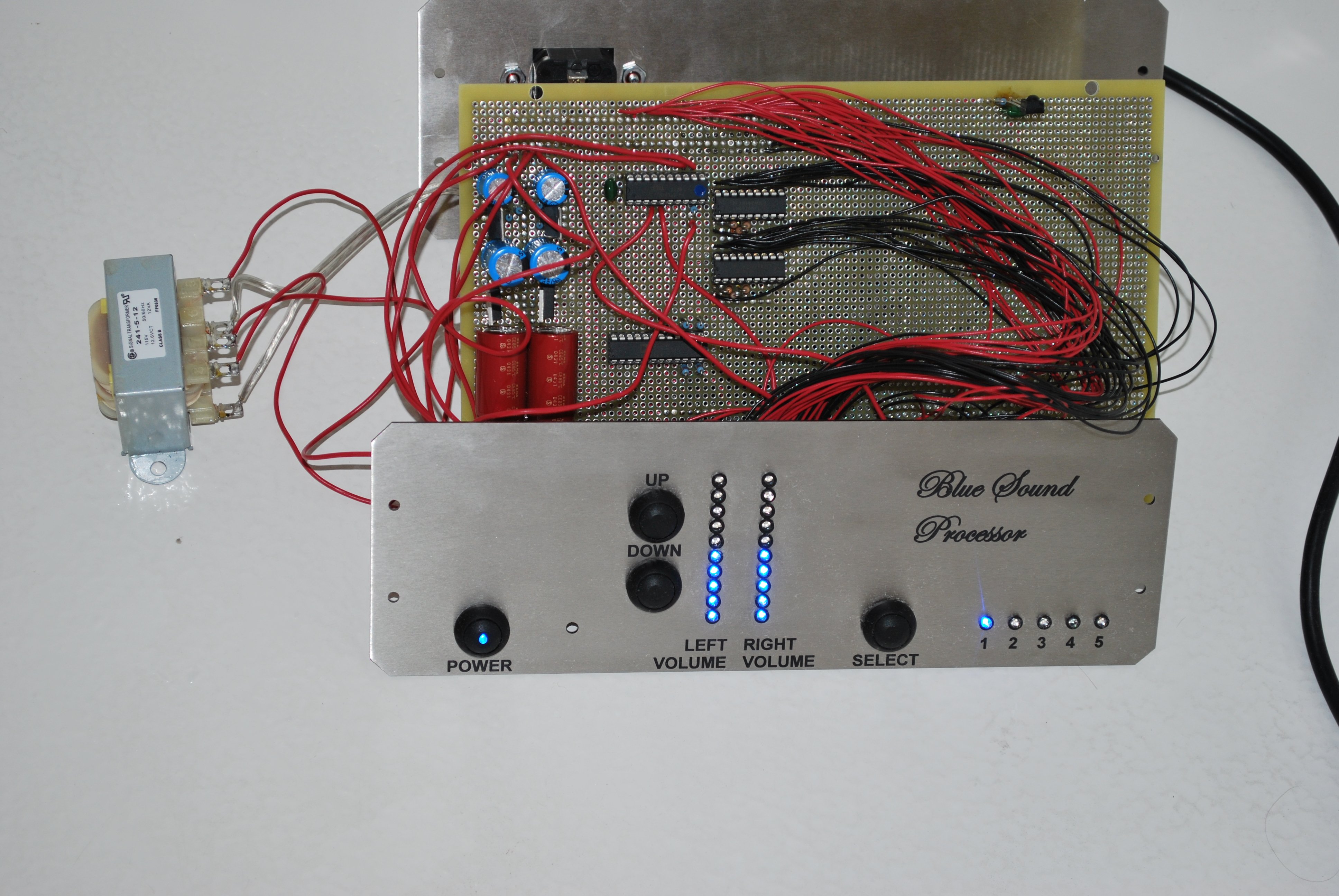

It's built and tested. I'm itching to put it in the cabinet and wire-tie that mess of interconnect and LED wires, but I probably won't get to that for a few days. Gotta hit the road tomorrow and won't be back 'til Sunday. But here's a view of the working circuit and the front panel:
index.php?t=getfile&id=985&private=0

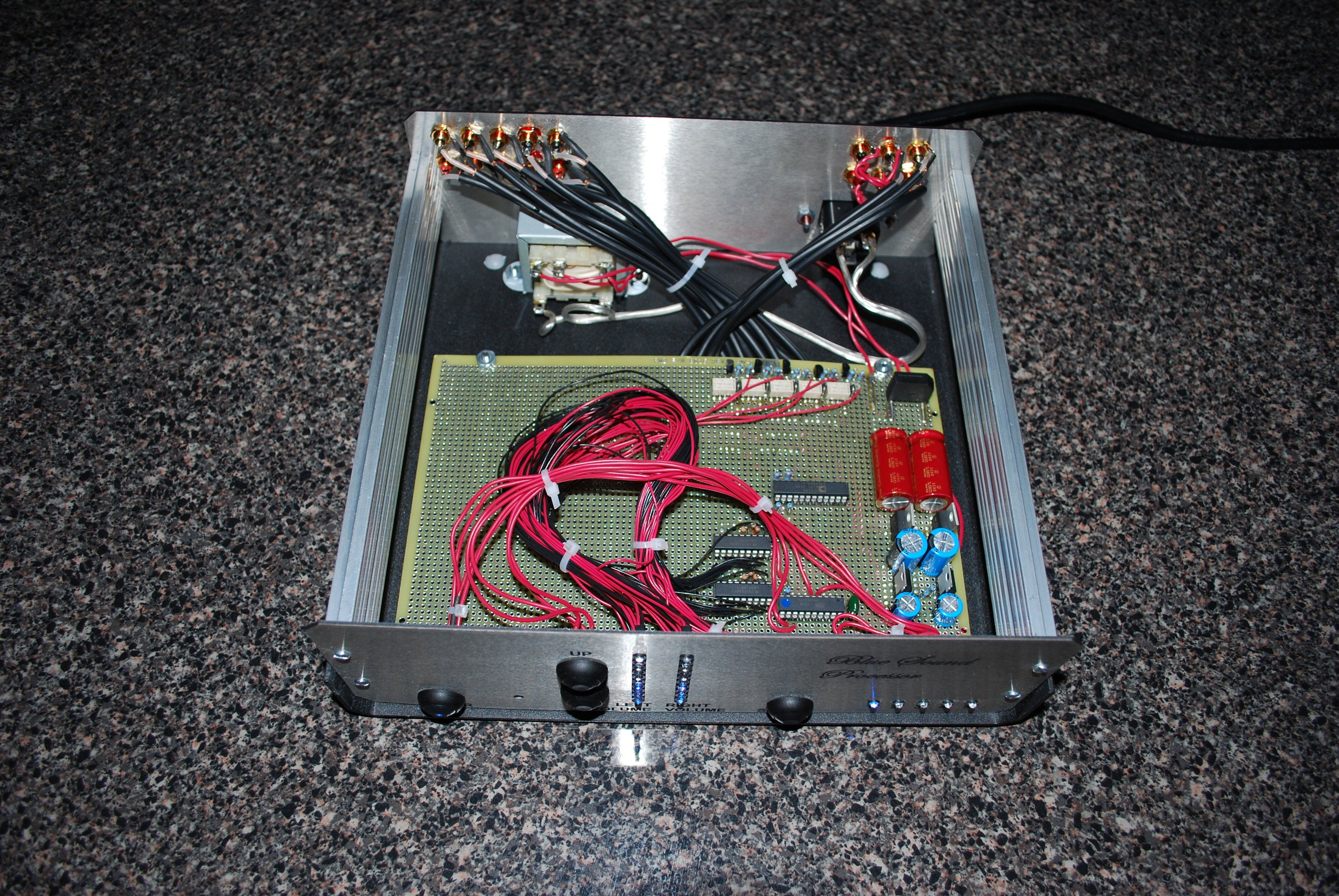

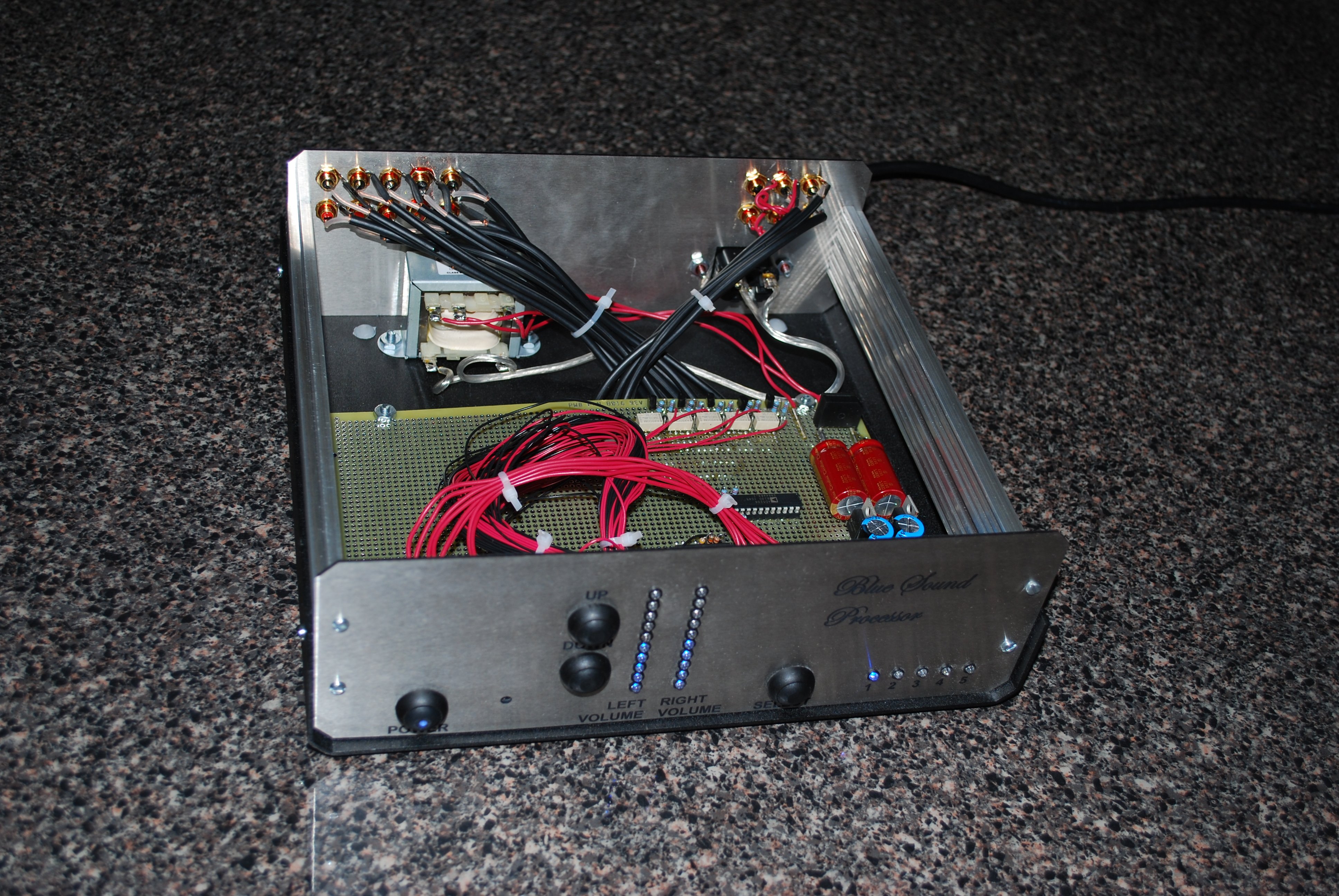

Here are a few more pics, with the board installed in the cabinet:
index.php?t=getfile&id=993&private=0
And here with the camera pointing a little more straight down, to get a better view of the board and stuff inside:
index.php?t=getfile&id=994&private=0

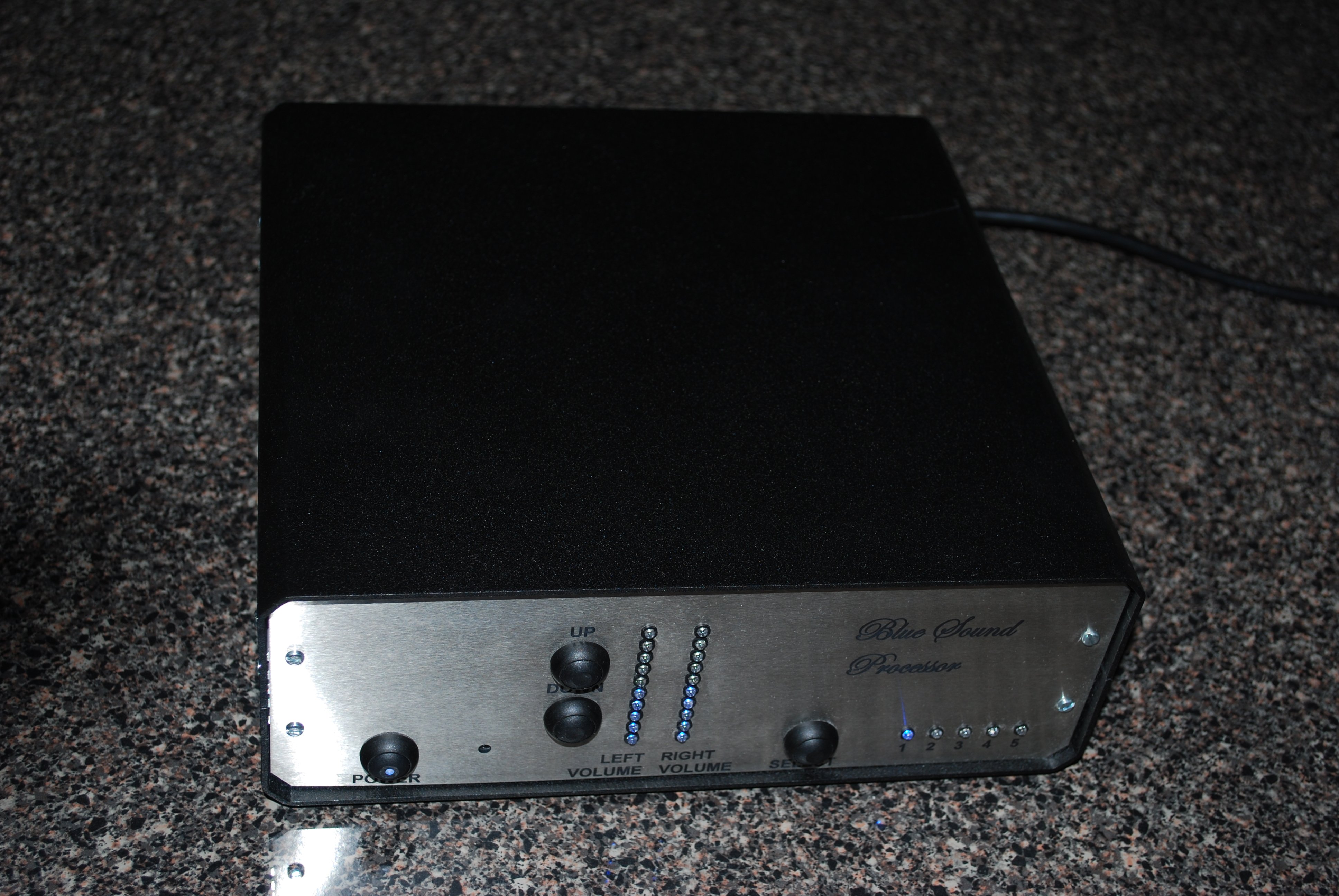

And now a shot of the box, buttoned up and ready to go:
index.php?t=getfile&id=995&private=0
