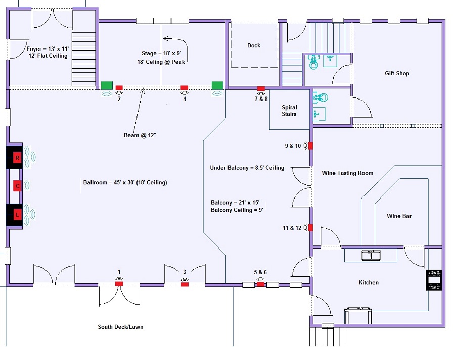

I have tried to depict the placement of all of the speakers/subs the best that I can in the floor plan below. Below the floor plan is a key to help you understand what you are looking at.
Wayne: When you talk about me using the horned subs as a "distant flanking sub", do you suggest that I use the four Theater F20s on the west wall in conjunction with the stage sound? Would you then recommend a pair of 3pi Subs to accompany the Stage 4pis? If so, what placement do you suggest for the 3pi subs? I was thinking the bottom of the Stage 4pis could be positioned at a height of approximately 5', as that would (in my opinion) provide the best positioning for a standing audience. Would the 3pi subs (if their use is suggested) then be placed under the 4pis at floor level facing the audience? (It seems to me that the 3pi subs would also double as extra multi-subs for the 7.1 surround when playing movies, filling in any nulls created by our being limited to F20 placement. Thoughts?)
Finally; with the plan for our dinner theater and stage sound coming together, it looks like we might end up with 4pi x 5, 1pi x 12, and 3pi Sub x 2. I have two 4pis and four 1pis constructed, so I am probably at least six weeks out from ordering all of the components. How much lead time are you going to need for all of those components?
P.S. I am open to a critique of our plan below from anyone. Everyone's feedback is always appreciated! Smile

Re: 4pi Commercial Dinner Theater Build [message #69284 is a reply to message #69280] Thu, 01 September 2011 21:36 Go to previous messageGo to next message
Flanking subs and distant subs are two different things, and serve two different purposes. Both provide extension, and beyond that, the main purpose of the flanking subs is to smooth the upper midbass and lower midrange and the main purpose of the distant subs is to smooth the lower bass. Flanking subs are close to the mains and are low-passed sometimes as high as 200Hz but more often between 80Hz and 120Hz, depending on the slope. Distant subs are put further away, and are low-passed below 60Hz.
Flanking subs are in near proximity to the mains, a meter or two away from the mains in all three dimensions. The mains are on stands and the subs are on the floor, the mains are forward of the wall behind them and the subs are pressed back to the wall. They are also both inside or outside the mains, whichever is most convenient. As I said earlier, these smooth the upper midbass and lower midrange modes. There is almost always a strong notch around 120Hz to 140Hz from axial modes between ceiling and floor, and also from self-interference from the wall behind the speakers and floor bounce. The flanking subs main purpose is to smooth these notches.
Distant subs are usually placed somewhere in the opposite side of the room. It almost doesn't matter where the distant subs are placed, as long as they aren't in the same place as the mains or flanking subs. We want diversity of positions for the sound sources in the modal range.

Wayne: Thank you for your patience as I get past the learning curve. I learn quickly; but there is much to learn. If I understand what you say correctly:
1. The F20 subs on the west wall can function as the "distant subs". I see that you suggest a high pass at 60Hz. Would a high pass at 80Hz be troublesome for the distant subs?
2. If I build two 3pi subs, then I should place them at the back floor of the stage wall slightly offset from the x coordinate in relation to the mains?
3. Are the drivers pointed at the audience in this configuration?
P.S. Did you see my question about how much lead time I should give you for all of the components I will end up needing?
Thanks again!
Re: 4pi Commercial Dinner Theater Build [message #69293 is a reply to message #69292] Fri, 02 September 2011 09:43 Go to previous messageGo to next message
Answers by numbers:
1. If I understood your picture properly, the west wall is on the left, where the mains are. So that would be where you would put flanking subs. Distant subs would be put somewhere else, more distant from the mains. The low-pass frequency is set empirically - if you can't tell they're on, then the crossover frequency and SPL is right. It should provide deep bass foundation but still be subtle, you definitely should not be able to tell where the rumble is coming from. So set the distant sub(s) crossover frequencies empirically. You can even use measurements to find what settings give smoothest response, if you have that capability.
2. Indoors subs should be in a different position in all three coordinates that the mains. It is different than outdoors, where we want to have them acoustically close, acting as a single source. Indoors, we want to spread things around. Wall reflections create multiple virtual sound sources, so we cannot create a point source anyway. It creates course interference, because the number of sources is fairly small, so the spacing between peaks and nulls is wide, and pretty obvious. The goal of the multisub configuration is to actually make even more interference, and by making the interference pattern more dense, it more closely resembles an averaged reverberent field.
3. All drivers should be pointed at the audience. It actually doesn't matter much what direction low frequency sound sources are facing, so if it is more convenient to point subs in another direction, you can do so.
As for lead time, I keep stock of all crossover parts, and many drivers. But I go through a lot of 2226 woofers and DE250 compression drivers. So it seems like every other month, I get backlogged on one or both of those drivers for anywhere from a week to a month. The TD12S often takes several months to fill. Everything else is usually either in stock, or if not, less than a week until the replenishments arrive.
We build the crossovers at time of order. Sometimes I'll have a couple on the shelf, but there are lots of versions and options. For example, a four π crossover for the PSD2002 is different than one for the DE250. Then there are the coil, cap and resistor options. So in most cases, we have to build the crossover at time of order.
All that to say you should expect at least a couple weeks lead time for a three π or four π kit. Right now, we're running about a week for one π, two π, two π tower and three π subwoofer kits. All other kits are taking two to four weeks. If you order all of them at once, it will take a little longer to get them all ready for you, but we can ship as we make ready rather than all at once, if that will help.

I have two sets of mains. The three 4pi mains for the dinner theater seen in red on the picture, and two 4pi mains on the stage depicted in green. My question about the F20s on the west wall acting as distant subs is in relation to the two mains on the stage.
Re: 4pi Commercial Dinner Theater Build [message #69298 is a reply to message #69295] Fri, 02 September 2011 12:40 Go to previous messageGo to next message
It would probably still be best to order all at once, that way I'll know what I need to bring in. I keep stock of a lot of stuff, but if I need something, it would be best to know as soon as possible. The shipping would be the same either way, because the kits are packed the same way even at moderate quantity levels as they are in singles or pairs. The larger kits fit one per 20x20x16 box, smaller kits can fit two per box.
When we send out a large quantity, we palletize drivers and ship them separately, but that usually only happens with the 12π hornsubs. Those are usually sold in quantities that makes LTL shipment of palletized packages most effective. But your order is not so large that palletizing makes sense.
As for the distant subs, yes, I see what you mean now. That's a pretty good idea - the flanking subs for the mains on the north wall could be used as distant subs for the mains on the west wall, and vice versa. Just remember that flanking subs (closer to the mains) get low-passed around 80Hz - 120Hz and distant subs (further from the mains) get low-passed around 50Hz - 60Hz.
