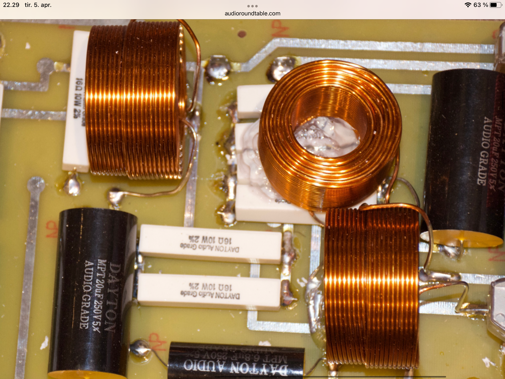

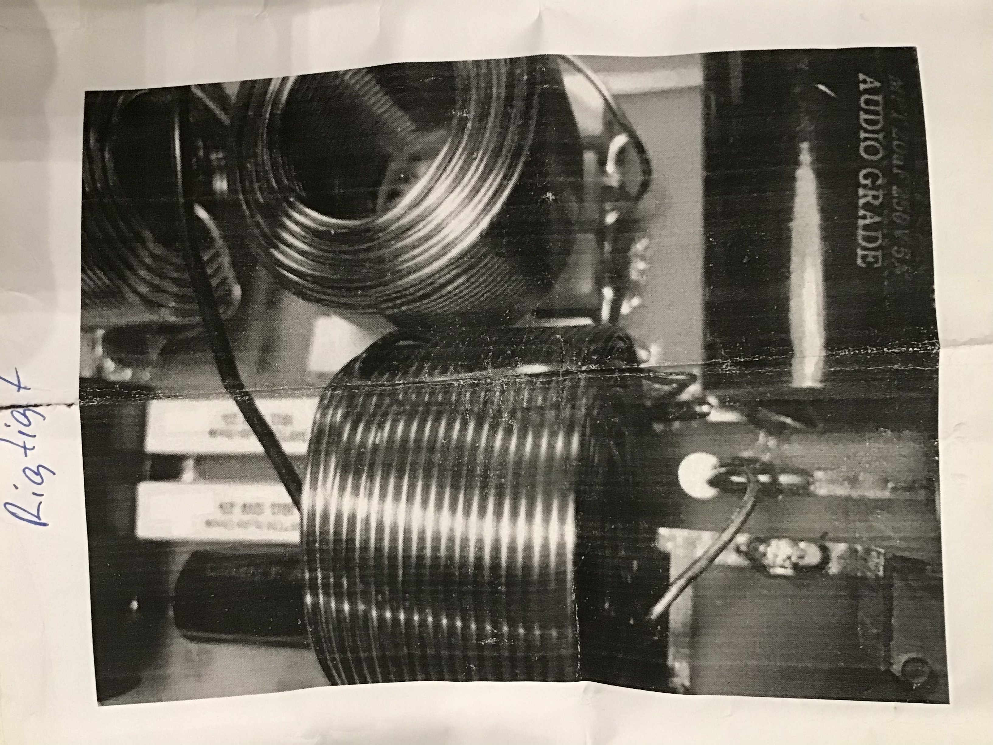

Got my crossovers back from the tech long ago, and as he expected it was a simple fix.
The black and white picture is the fixed crossover, and the picture with colors was before fix.

So glad your technician was able to find the problem! I kind of thought it was that coil - Even though it is attached with silicon, it is the one most likely to shift and push a wire into a PCB trace. I don't see it as often in domestic shipments as I do international. And as much padding as I surround the crossovers with, sometimes they still take a hit I guess.
