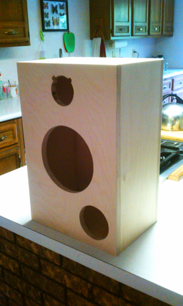

Re: 4pi Commercial Dinner Theater Build [message #68687 is a reply to message #68600] Fri, 22 July 2011 21:57 Go to previous messageGo to next message
Messages: 102
Registered: June 2011
Location: Iowa
The first of twelve 1pi speaker enclosures is finished. It did take a lot of sanding, but it turned out well. FedEx shows my terminals and port tubes will arrive tomorrow.

Re: 4pi Commercial Dinner Theater Build [message #68698 is a reply to message #68688] Sun, 24 July 2011 03:10 Go to previous messageGo to next message
Messages: 102
Location: Iowa
I tried staining my first 1pi (red mahogany) after some extensive standing with very fine sandpaper. Parts of it looked good, parts looked "splotchy" as a result of inconsistent standing. I see why most people veneer them. I don't have that kind of time on my hands to do this with twelve 1pis; especially if only 2" of it will be seen. I instead painted it black with the concrete epoxy. It is not elegant, but it looks professional and does not look homemade.
