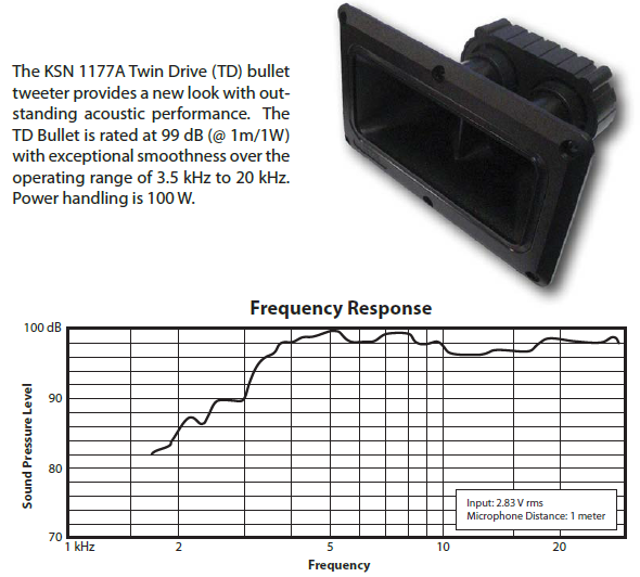

Hey that old dual one I have is pretty good! But would you get ripple as you moved side to side because of the interference of the two units?
index.php?t=getfile&id=1015&private=0
  • Attachment: KSN1177.png
    (Size: 132.94KB, Downloaded 3665 times)

IDK about the off-axis response. I know a few guys on other forums reported liking the KSN1177.
The KSN1056 and the KSN1038 look very similar, but they are different somehow. If you look through all the drivers on the website, they show a KSN1038, but don't have the specs up for download/viewing.
The KSN1165 looks very similar to the KSN1167 , but the KSN1165 has a larger/thicker piezo drive element. Also the horn throat is deeper and the overall diameter is larger than the KSN1167. KSN1165 is rated to about 3500-3800hz and up , while the KSN1165 is rated from 1800hz and up.
