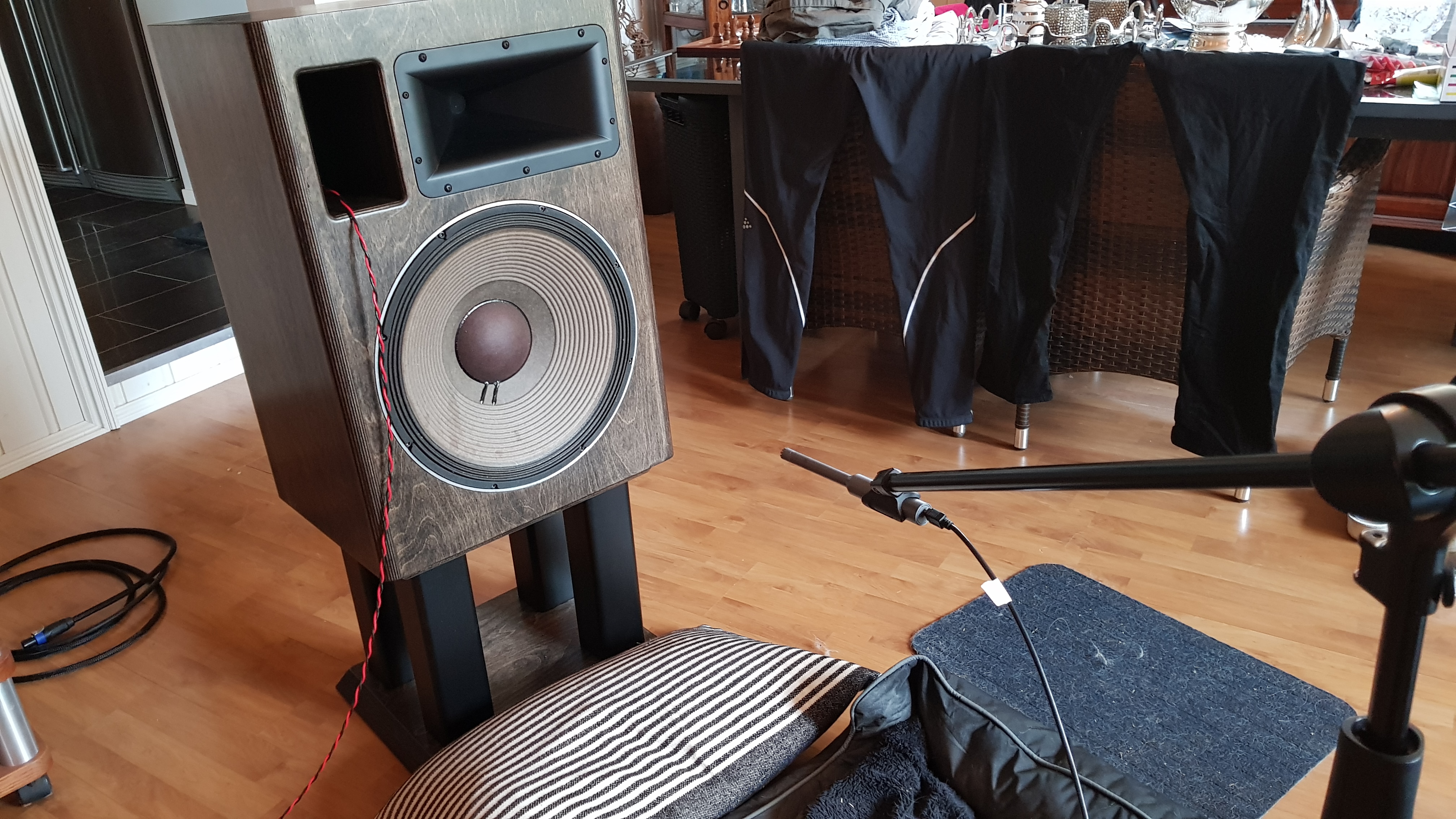

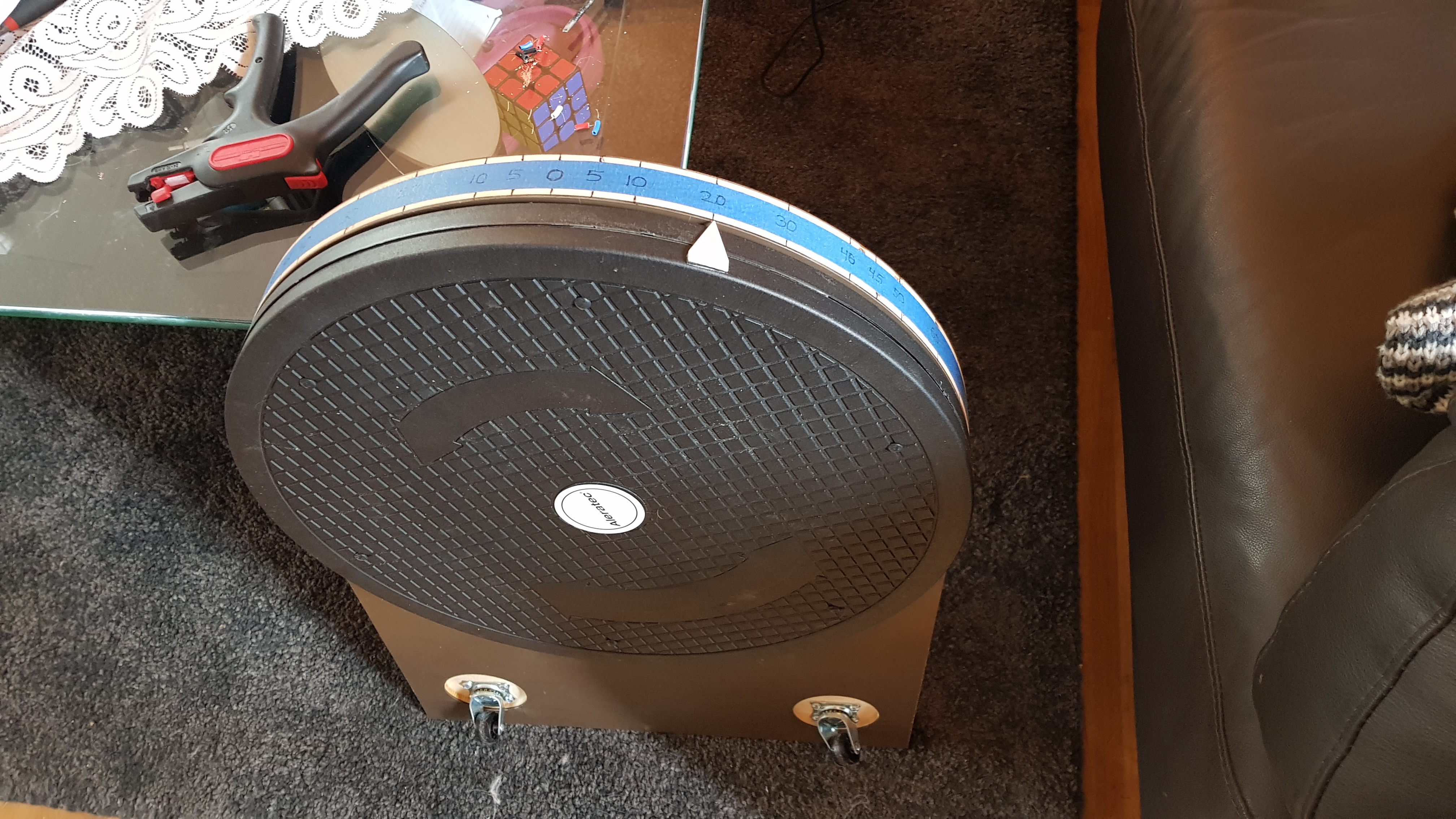

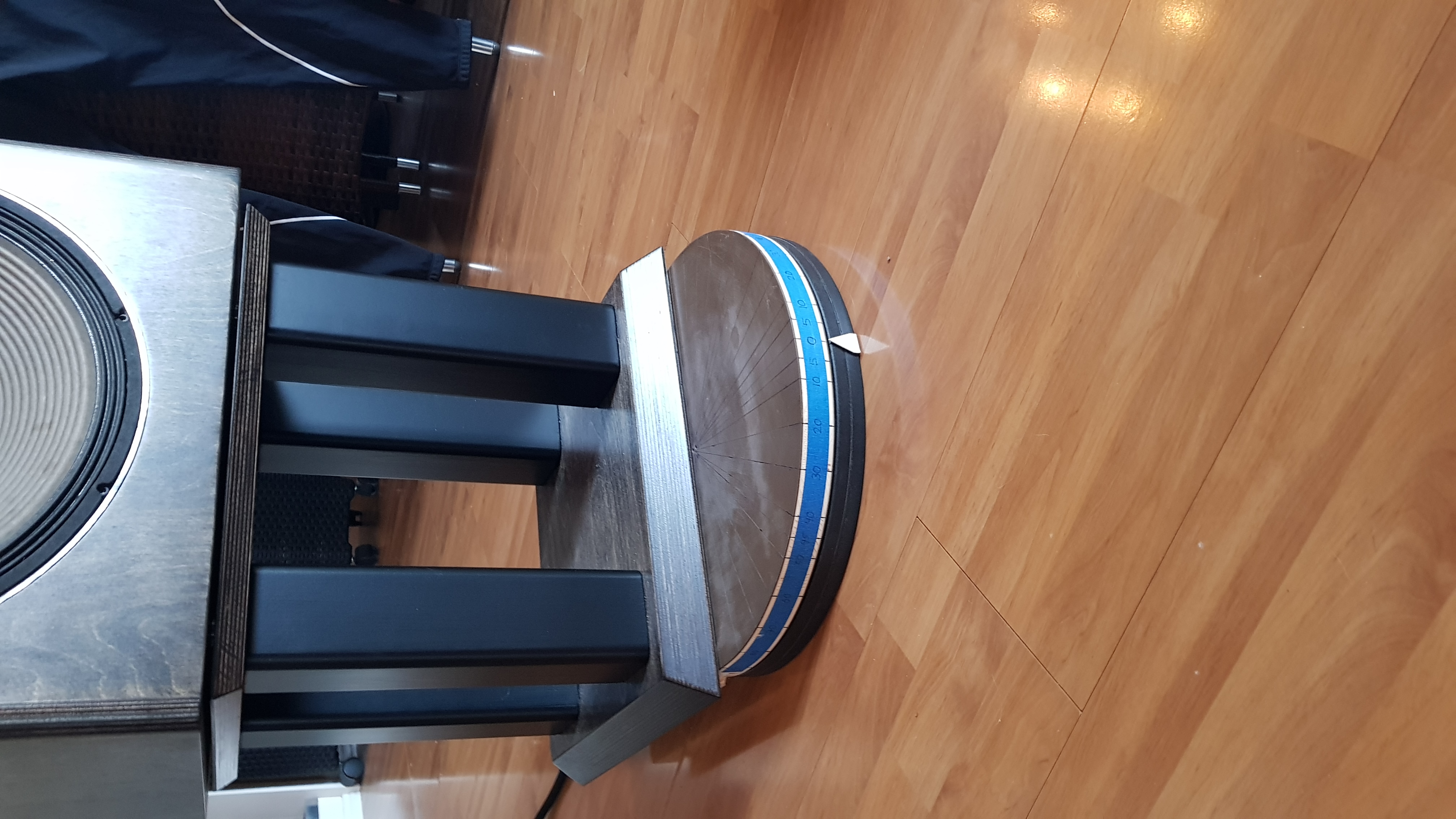

Measurements are done indoors and in the 4pi box. I am using a diy turntable for off axis measurements. Some pillows on the floor helps, but with gated measurements or with frequency dependent windowing in REW it seems quite reliable in the midrange and up. I know outdoor measurements are preferred, but a lot of hassle.

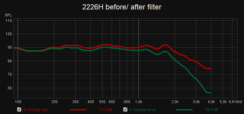

Made some measurements of the woofer before and after crossover. I got less noise when I laid the speakers on the floor. Called the guy who sold the woofers, and he insisted they were originals. He put his pride in this and said he had newer sold drivers with aftermarket recone kits. Made three measurements, with and without crossover on 0,25m, 0,5m and 0,75m distance. Averaged the three measurements for each case. It is smoothed 1/12 and has not got the resolution you get outdoors, but the general shape and location of the dips/peaks are consistent. Standing measurements show more or less the same. It is more useful to show the effect of the xo.

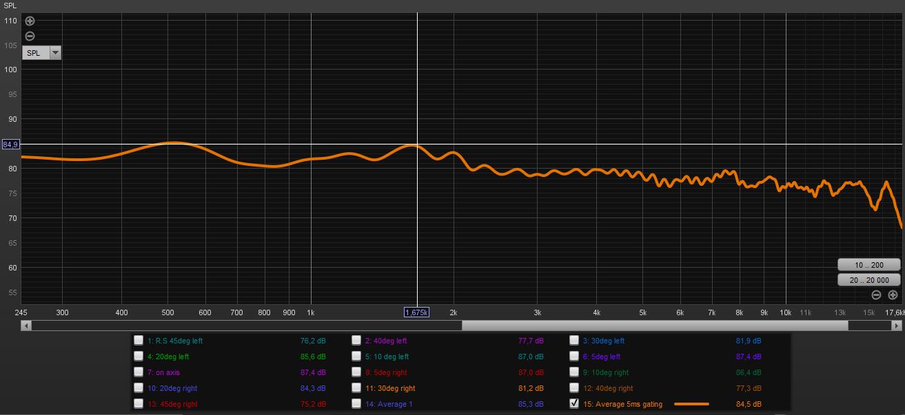

Took measurements with my turntable going from -45 to +45 degrees, and with 5ms gating to remove most reflections from midrange and up. Horizontal power response looks good to me, and I think this correlates with what one is hearing if listening at distance in a reflective room as mine. There is a problem with flutter echo in my room and I hat to pull down the area from 1,3k to 3k with eq to get it balanced to my taste. This has been the case with almost every speaker I have had in this room.

Your measurements look good, congratulations! I feel better about that 2226H cone now, because the measurements appear in line with what I expect from the OEM.
As for box tuning at 35Hz, that's not bad at all. The expected Helmholtz frequency is 37Hz - and that's what I've measured on several occasions - but even if you have some slight differences in your box or damping material that shifts it down to 35Hz, that's not too bad.
The truth is the 2226 will perform very well in cabinets from 2ft3 to 5ft3 with Helmholtz frequencies between 35Hz and 40Hz. I've found that the thing that matters more than the box tuning - provided it's in that range - is the positions of the driver and port in the cabinet and its size and shape because of internal standing waves. We don't want a pressure node to line up with the port or driver in the lower midrange 'cause that will give noticeable midrange aberrations.
I can see from your response curve that you loudspeaker system is free of any such aberrations and it is working as designed. https://audioroundtable.com/images/thumbs-up.gif
