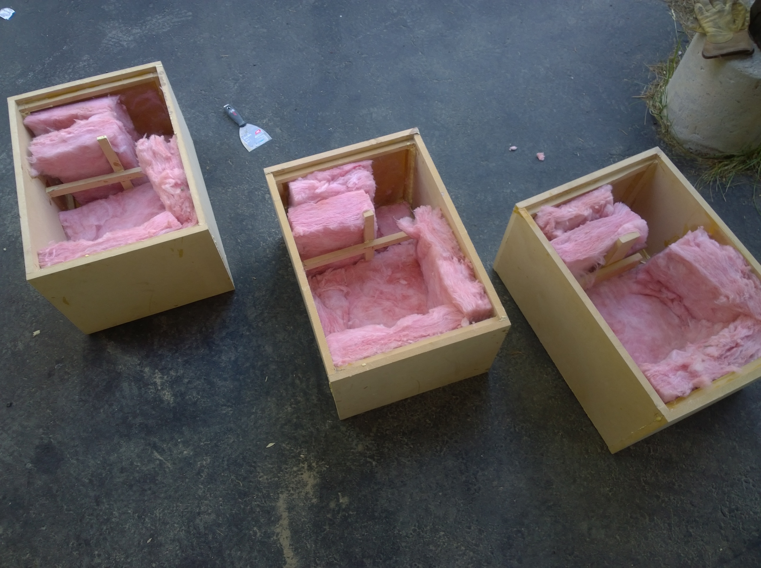

Does this look right for insulation?
index.php?t=getfile&id=1779&private=0
I glued down the back piece and my binding posts aren't in yet, still waiting on a delivery from Parts express. Which also has the hurricane nuts for the baffles.

Yes, that looks just fine. I actually don't use quite as much as you do above the brace, but what you have will be good too. I usually just lay a sheet on top of the brace, spanning the cross-section. It sort of separates the cabinet into two sections, top and bottom.

If you're trying to build these exactly as the plans direct you, you may want to remove the piece of insulation on the bottom of the boxes, as it's not supposed to be there.

Hmm I didn't realize it wasn't supposed to be there seen it in a few other builds, I'll remove it most likely then when I mount the cross over.

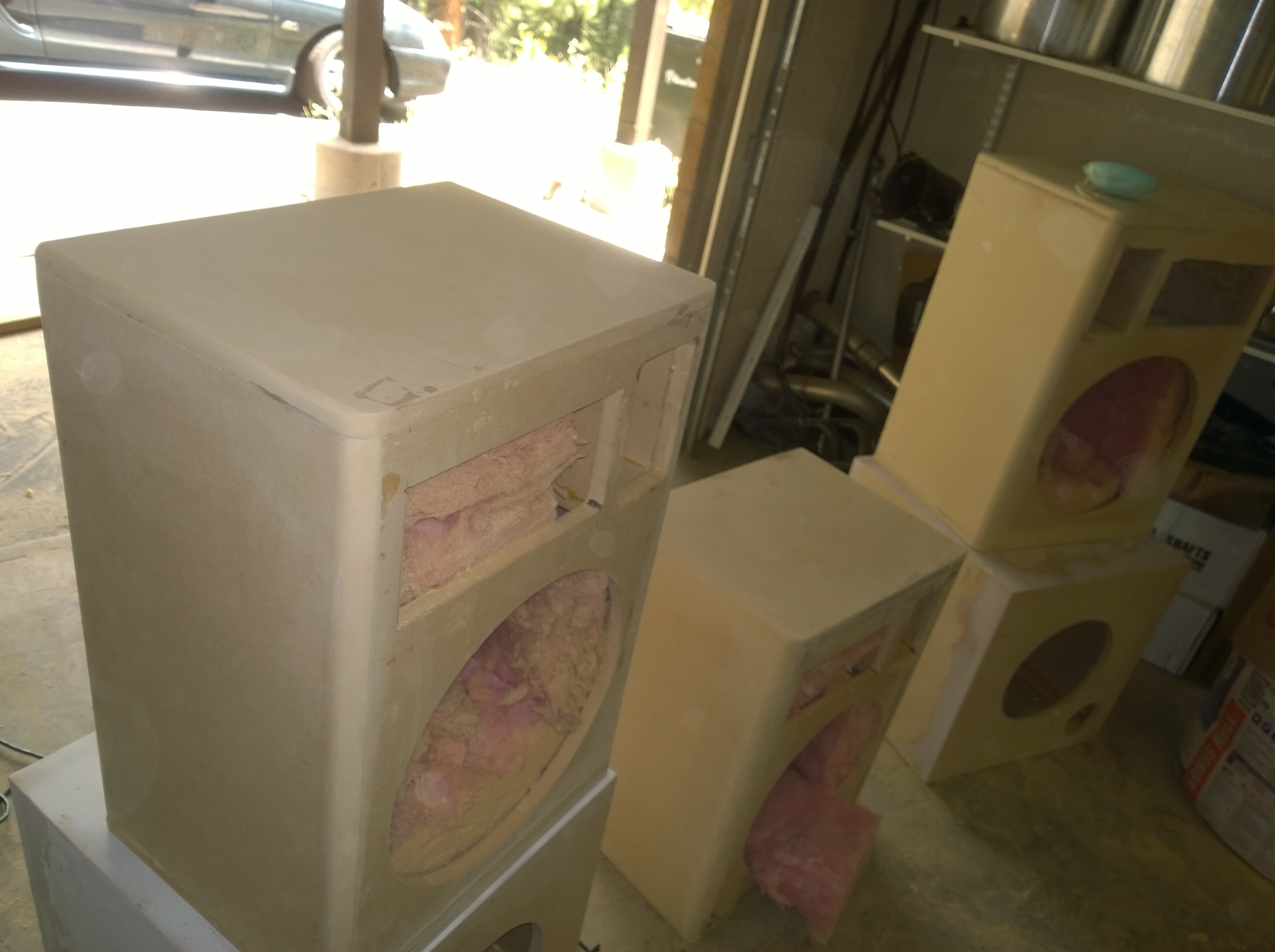

More progress, The 3 Pi Subwoofers got their final hole cut with a 4" hole saw, since my router couldn't make a 4" hole and my dermal didn't like cutting MDF. I also bondoed around the edges and sanded, The subs are almost ready for paint. As of this morning before work the last baffle has been glued on to the 4 Pis.

Round overs done, hope to finish Bondoing the edges of all the boxes tomorrow, then a bunch of sanding and I'll hit them all with some primer.
You can see the 3/8" round over on the top sides, and the 1" round over on the front sides, I think I'm leaving everything else square.

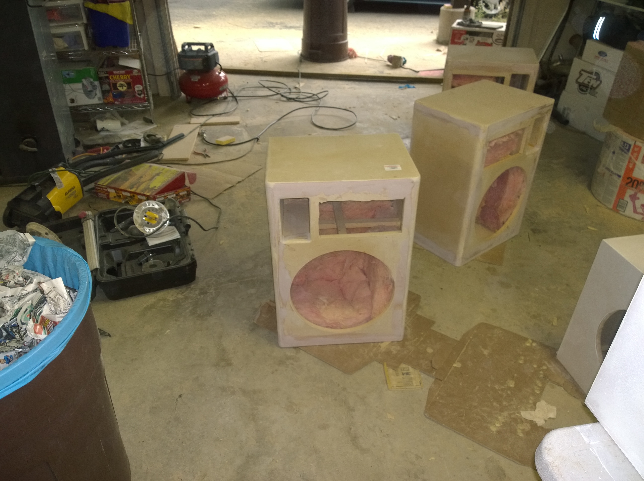

index.php?t=getfile&id=1784&private=0
Here's a shot of all 5 cabinets
index.php?t=getfile&id=1783&private=0
