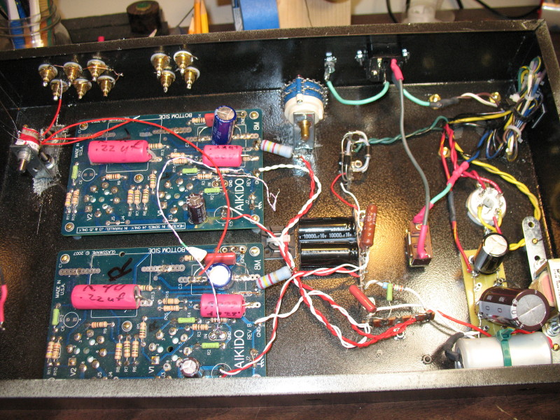

Somewhere in the correspondence over the build and receiving packages from Digikey I was inspired to get the UPS damaged Aikido off the shelf and do the re-build. I drilled and painted the replacement chassis over 2 years ago and then forgot about it.
Now I just have to wire up the switch and attenuator and it's done. Then, with a little help on the power supply and layout from you guys, I'll do the RDAC and have a Rodeo.

Re: IR Remote Control [message #73705 is a reply to message #73151] Thu, 30 August 2012 23:47 Go to previous messageGo to next message
