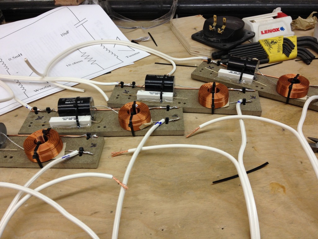

2π update:
Crossover assembly under way:
index.php?t=getfile&id=1193&private=0

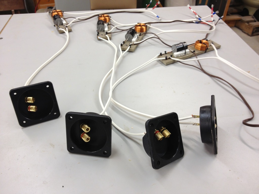

Crossovers done - I sized the boards to fit through the terminal cup holes in the cabinets. I wanted to get everything completely assembled and tested on the bench prior to buttoning up the cabinets.
index.php?t=getfile&id=1194&private=0

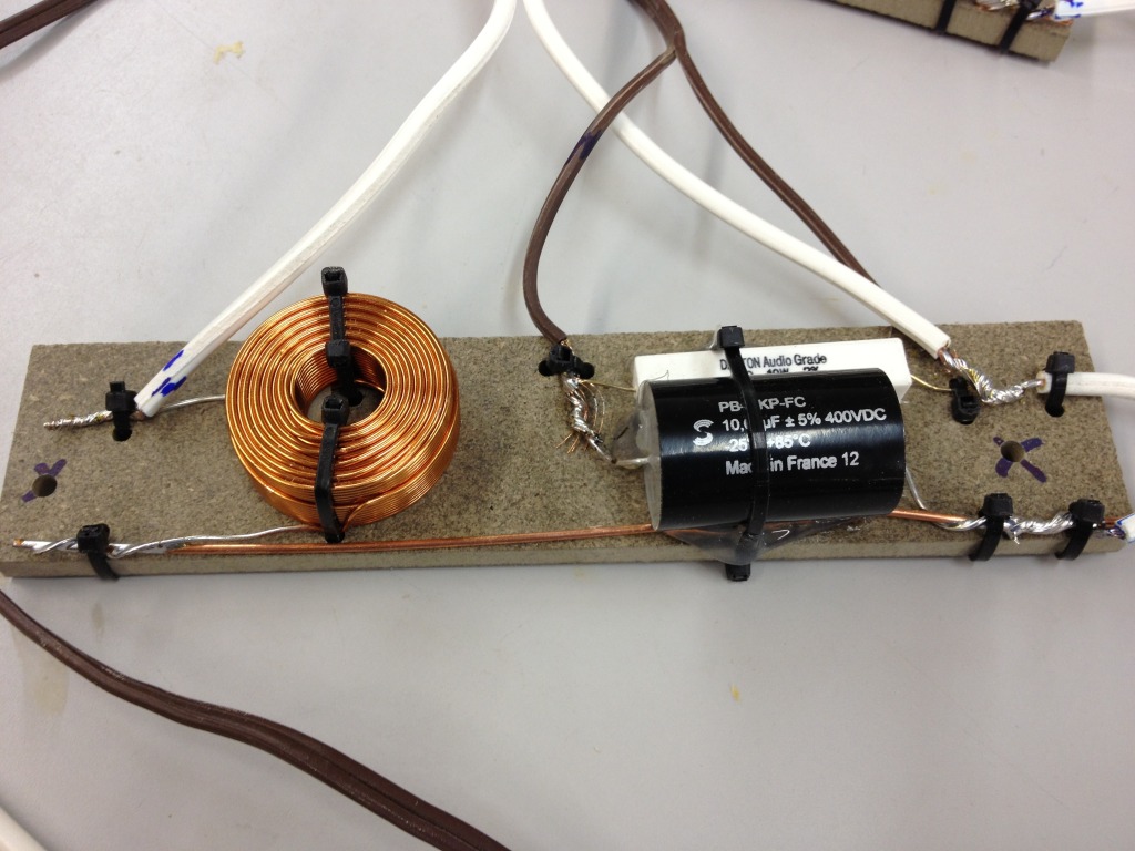

Crossover closeup.
index.php?t=getfile&id=1195&private=0

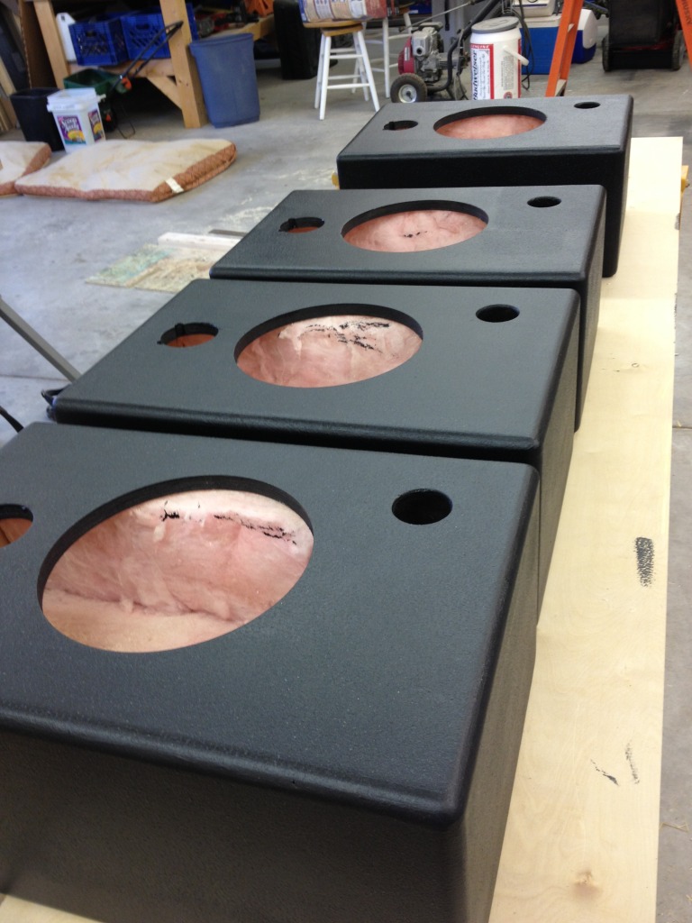

Final coat of Duratex on the boxes.
index.php?t=getfile&id=1196&private=0

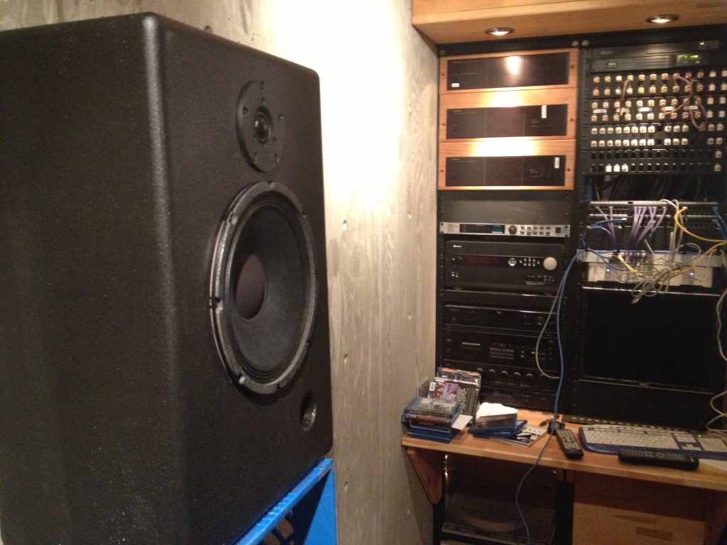

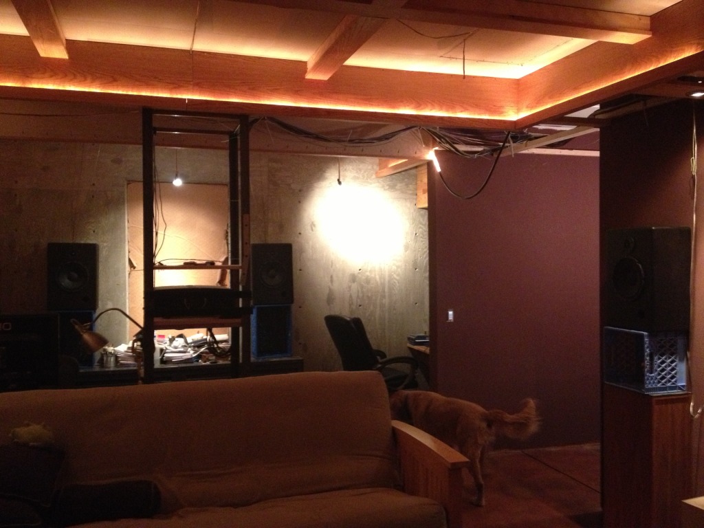

We got these completed and lit them up today. The 2 pi exceed my expectations by miles. The whole system just opens up and fills the room.
index.php?t=getfile&id=1197&private=0
index.php?t=getfile&id=1198&private=0

Re: Pete's Home Theater Build [message #77043 is a reply to message #77041] Tue, 18 June 2013 18:47 Go to previous messageGo to next message
Messages: 76
Registered: June 2011
Location: Albuquerque, NM USA
I'm going to haul a pair upstairs to compare to my little B&W CM1 stand mounted monitors. Should be interesting.
I have a multichannel DTS CD of Eric Clapton 461 Ocean Boulevard. The organ track is mixed into the surrounds and sounded great on the 2 pi.
Re: Pete's Home Theater Build [message #77050 is a reply to message #68358] Wed, 19 June 2013 14:37 Go to previous messageGo to next message
Messages: 76
I did some pretty extensive two channel listening to one pair last night in my living room (not the theater). At first listen, the highs were a bit harsh and mid bass seemed "thick". Once I backed away from the speakers - further than my normal listening position - they sounded much more balanced and smooth. Normal couch to TV distance is about 7'. They sounded much better at 10' or more. My little B&W stand mount speakers work well nearfield, but I think the 2pi needs more room and distance to get into the sweet spot. My living room is irregular, hard and reflective. Room treatments would do wonders for the two Pi's.
I think five of the two pi's would make a great home theater on a budget. They have good dynamics that you need for HT. Musical performance is good. Like any speaker, placement and room treatments will contribute a lot.
I'll let Nube give them a listen in the living room and hear his opinion. I'll try some two channel listening in my theater too, since it's a much better space, acoustically, than the living room.
Re: Pete's Home Theater Build [message #77052 is a reply to message #77050] Wed, 19 June 2013 15:08 Go to previous messageGo to next message
Messages: 19101
Thanks for the update.
You mentioned the listening room is irregular, hard and reflective. That no doubt contributes to the forward presentation. But honestly, I think the biggest thing is the little one π and two π speakers need a little more foundation, something to give them more bottom end. If they are used as mains, they really need subs. They're perfect for surrounds, but don't have enough output below 60Hz, so they sound thin by themselves.
They also sound great in a tiny space, like a car. No need for subs there! But in their native environemnt - in a home - they're best as surrounds or if used as mains, with subwoofers added.
