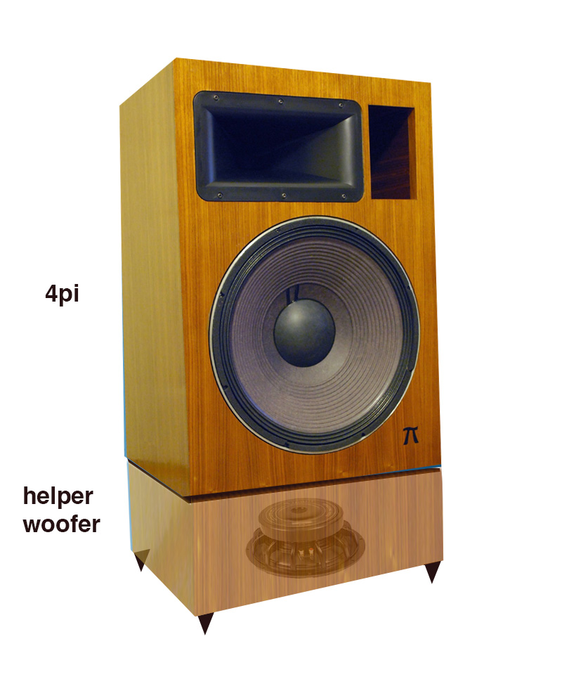

Re: Amp for 4pi speakers [message #89303 is a reply to message #89301] Wed, 05 December 2018 13:44 Go to previous messageGo to next message
Messages: 18
Registered: January 2013
/forum/index.php?t=getfile&id=2282&private=0
So this is not a good idea, I guess (apart from the questionable photoshop skills)?
The helper woofer acts as a stand at the same time Very Happy
Re: Amp for 4pi speakers [message #89306 is a reply to message #89303] Thu, 06 December 2018 08:36 Go to previous messageGo to next message
Messages: 19101
That won't provide all the benefits of a flanking sub, no.
