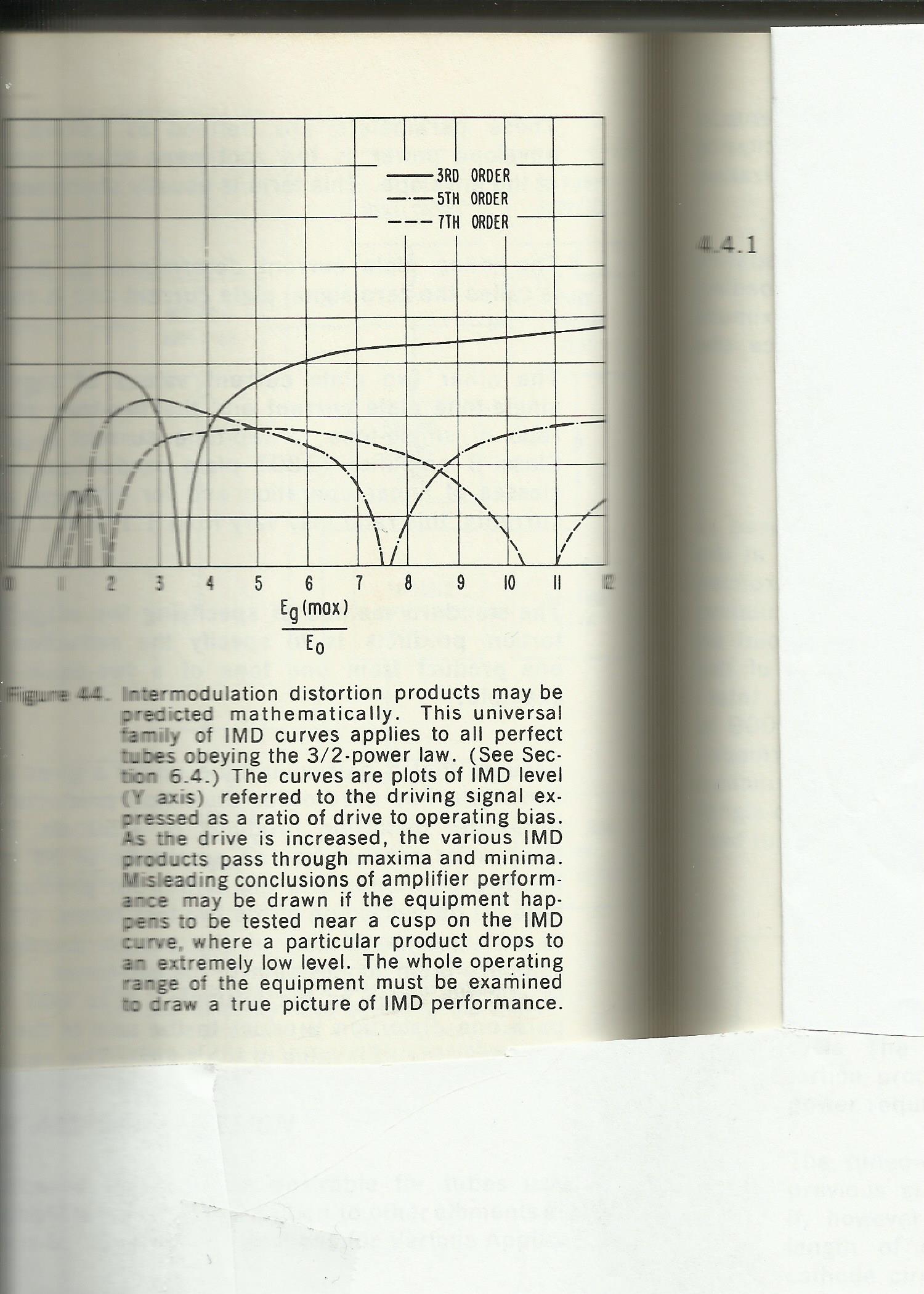

Below for general consumption. I do not wish to step on anyone's feet, but with so much confusion on other forums, I wish only to present the facts. I do not wish to change anyone's mind.
So much mis information exists concerning a variety of audio subjects. For instance, the intermodulation distortion (IMD) is roughly 3 times the harmonic distortion measurement. Attached below are data from Eimac of any tube following the 3/2 power law, and 300b distortion figures under varying condition.
One must also consider previous stages as the distortion products combine with other stages, including the output stage, to produce higher orders of distortion. For instance, 2nd of one stage will combine with 3rd of another stage to produce 6th order, 3rd will combine with 3rd to product 9th order etc etc.
The higher the order, the easier to perceive. (RCA Radiotron Designers Handbook, 26 engineers, 1960, Olson's work.)
As mentioned above, I try to present honest and factual information. Knowledge is power and helps in one's decision making.
(Caveat: I retired some 9 years ago and do not manufacture any electronic components, except the "V" interconnect cable.)
cheers
pos
/forum/index.php?t=getfile&id=2805&private=0
/forum/index.php?t=getfile&id=2804&private=0
