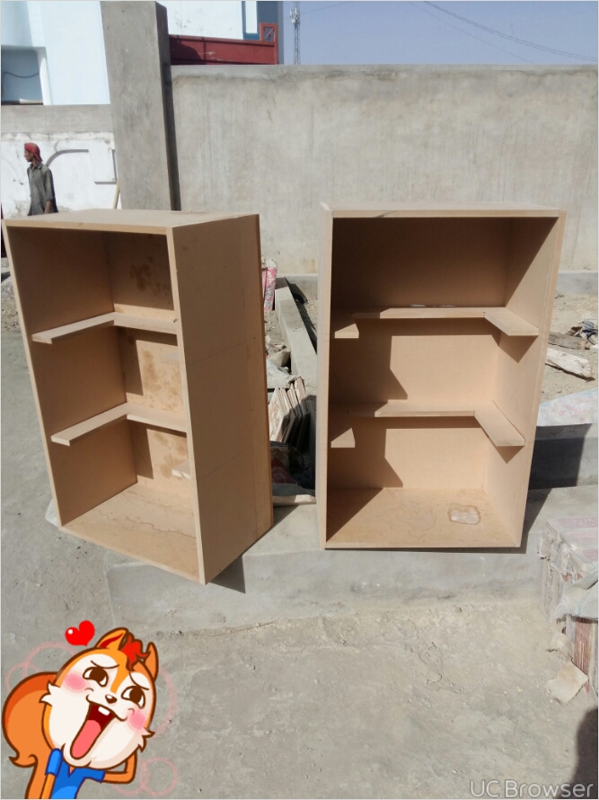

Re: Jbl 2226h pair for subwoofer [message #85963 is a reply to message #85913] Sat, 26 August 2017 05:53 Go to previous messageGo to next message
leimahmood is currently offline  leimahmood
Messages: 21
Registered: August 2017
Well boxex are under working
W8ing for ports
Tell me in square shape so its easy we will make here
Or pvc pipe 3.1/2" is also laying around
index.php?t=getfile&id=2002&private=0
Re: Jbl 2226h pair for subwoofer [message #85966 is a reply to message #85963] Sat, 26 August 2017 11:08 Go to previous message
You can make two ports, each that are 3-1/2" square and 5-1/2" long. Dimensions are internal. Length is from the front of the baffle panel to the termination inside.
