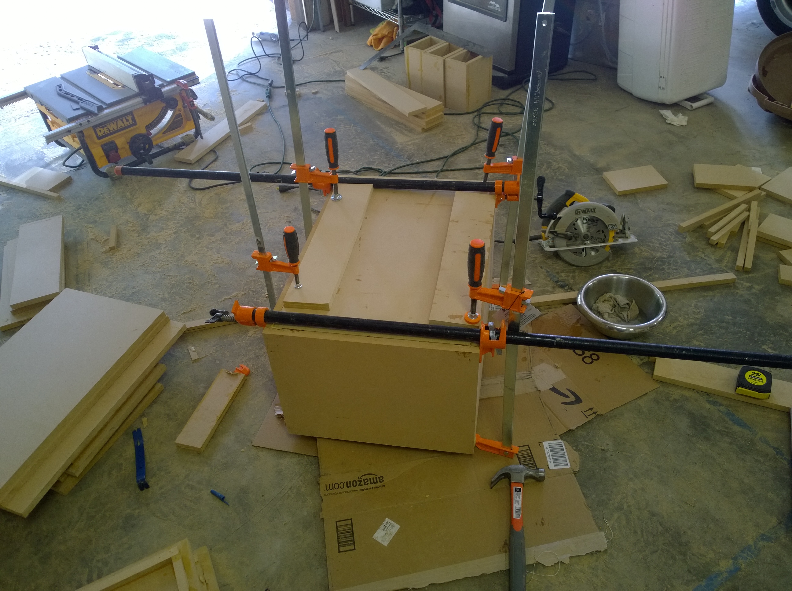

Gluing and clamping is a slow process, I'm hoping to have the sides and back on all the boxes this weekend, but we'll see.
Since I only have 6 clamps I can only do 1 box at a time here the fist one tops and sides:
index.php?t=getfile&id=1771&private=0
index.php?t=getfile&id=1772&private=0

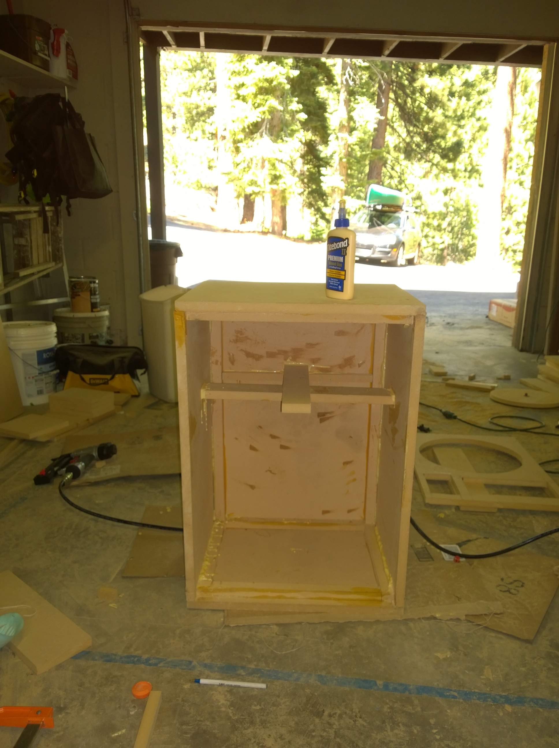

This morning before work managed to get the back on it fits! It's far from perfect but nothing some bondo cant fix.
index.php?t=getfile&id=1773&private=0

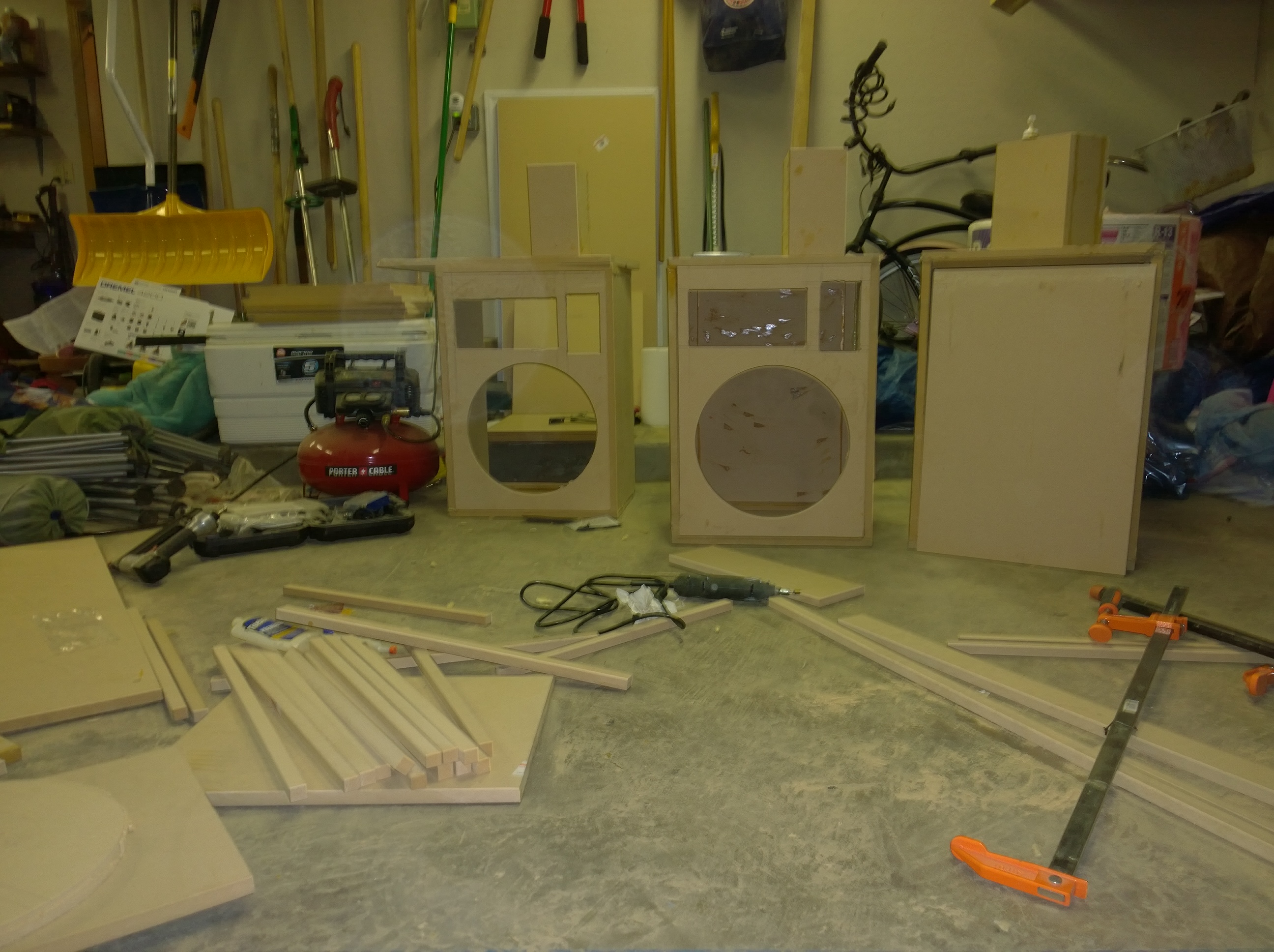

Made some progress today, My first baffle on the left is fairly messed up and will need to be re done, but the other one is pretty spot on according to the plans.
One questions, if I wanted to flush mount the waveguide, how deep and how much wider, from what I can tell it's something like 1/4" wider by 1/4" deep?

Re: 4 Pi Build Progress [message #81489 is a reply to message #81488] Sun, 26 July 2015 08:32 Go to previous messageGo to next message
Messages: 358
Registered: June 2015
Location: NJ
I'm looking to do the same thing in preparation of my waveguides.
I have found that the supposed depth of the waveguide flange is said to be 1/4".
I have also found that the supposed dimensions for the outer flare of the face of the waveguide is said to be 11-5/8" wide x 6-9/16" tall.
Whats wrong with the baffle on the left?
It looks good in the pics Razz .
