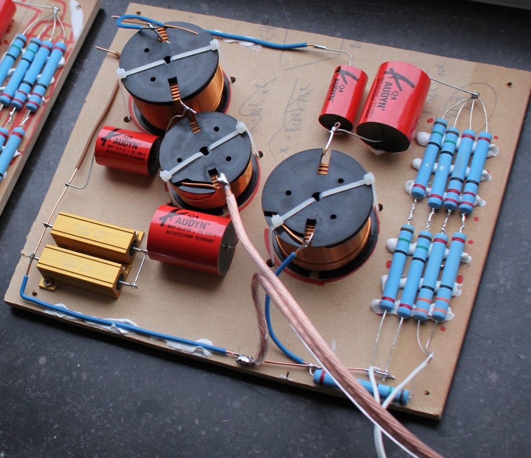

Hello Wayne,
Both compression drivers are B&C DE250 drivers with H290C horns bought on the 4PI-webshop. Both drivers show the same unusual roll-off.
According to your previous post, I understand that the DE250/H290C combination doesn't need extra CD compensation (with an extra C1) because the crossover-design on its own already compensates enough for this CD/horn combination?
This is a picture of the crossover:
index.php?t=getfile&id=1729&private=0
1. No C1 is installed
2. An extra resistor (over the tweeter) is installed (to reduce the possible peak at 1.6khz with the H290C horn).
3. R3 (the Zobel) isn't a large silver block (as seen often in the 4pi crossover pictures), but two 15ohm/50W resistors connected parallel.
Nothing of this should cause problems, should it? Or do I overlook something?
Maybe it is an incredible coincidence that both mics show the same roll-off?

The waveguide is ours, I knew that. We're the only ones that make it. But I wasn't sure about the driver or crossover. Now that I know the driver is the DE250, in my mind, that leaves only crossover and measurement system. And I doubt the crossover is doing it. It looks like you have it right. You can always double-check it, but I'm sure you've already done that.

In his crossover, the coils are not positioned on the board in the recommended way. Would this be the cause of his issue?
Tom
Re: 4 pi speakers + 3 pi subwoofers, pics & measurements [message #81374 is a reply to message #81371] Thu, 04 June 2015 10:19 Go to previous messageGo to next message
You're right, there's more mutual inductance when they're positioned that way, close together and in the same plane. They are coupled together, and act sort of like a transformer. This causes the HF crossover to shift some, and even causes some of the energy from the woofer circuit to bleed into the tweeter circuit, and vice versa. But this woud be most evident in the crossover range, and even worset case, it's a fairly small effect. I wouldn't say it's trivial, but the coupling isn't so strong that it could create a 10dB boost or drop.

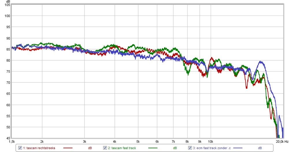

To test the measurement system, I measured the HF signal 3 times: with and without USB audio card + using 2 different mics (ECM8000 and TASCAM DR-1 (TASCAM is not great but no garbage either)). The following overlap gives an idea:
index.php?t=getfile&id=1734&private=0
Red line = TASCAM mic directly connected with laptop (mic-in)
Green line = TASCAM mic connected to the USB audio card (M-audio Fast Track)
Blue line = EMC8000 mic connected to the USB audio card (M-audio Fast Track) WITHOUT .cal-file
Red and Green line are approximately the same. The Fast track isn't the weak link. Confused
The ECM8000 measurement without .cal file gives approximately the same result. So the .cal file is corrupted IMHO.

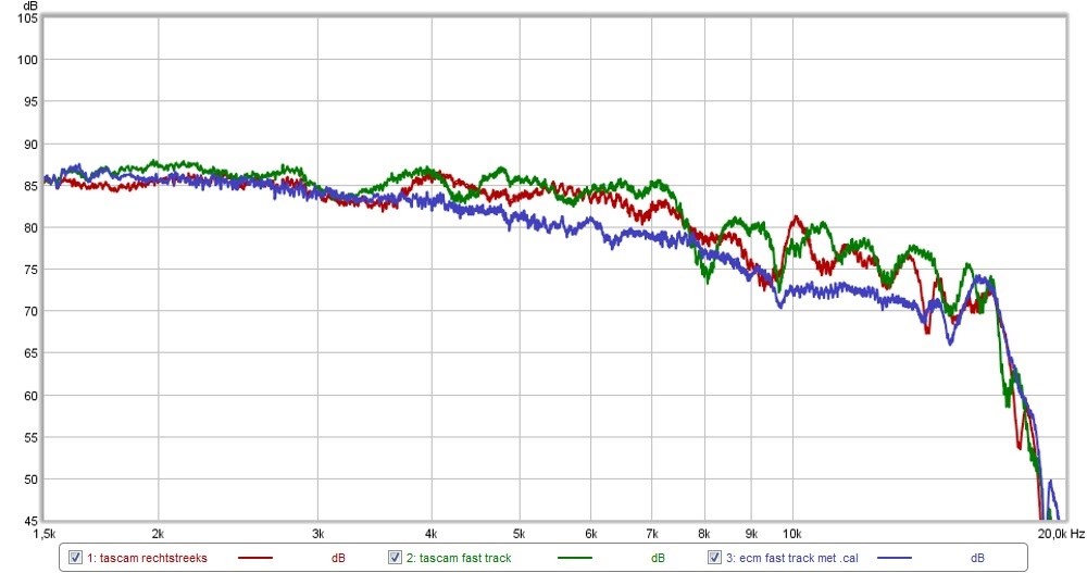

Just to give an idea, these are the same measurements, WITH .cal file applied for the ECM8000 mic
index.php?t=getfile&id=1735&private=0
Looking at the first overlap, I see a 5db to 10db roll-off. But this might be normal? Aaaargh, it's driving me a little crazy, honestly. Shocked
Would it be the amp?

I see the rolloff is consistent, so it has to be something common to all measurements. The thing is, a 10dB drop above 10kHz is pretty noticeable, and sounds like a 1970s tape deck that's totally missing the top octave. So if the rolloff is real, the sound you'll hear is pretty dull. If you were around in the 1970s, think under-dash 8-track tape player.
