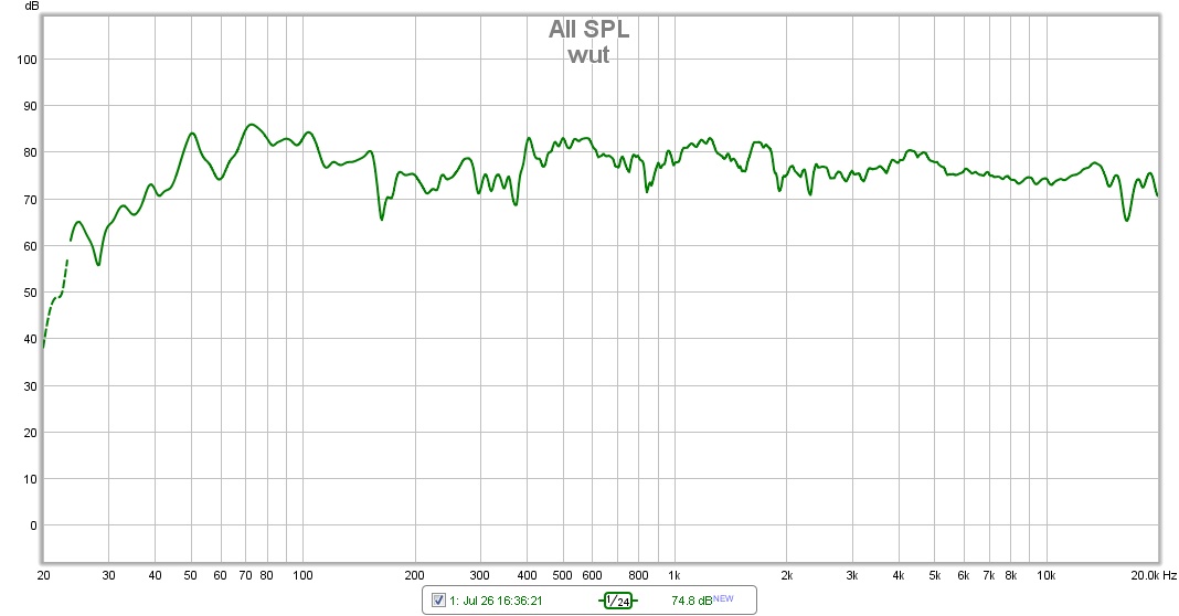

Re: 4Pi crossover study [message #77296 is a reply to message #77284] Fri, 26 July 2013 15:46 Go to previous messageGo to next message
Joe Sever is currently offline  Joe Sever
Messages: 11
Tried the other CD I had on hand, and the results floored me:
index.php?t=getfile&id=1223&private=0
While I have some work to do on the cabinets (bracing, damping of standing waves, etc.) and perhaps more traps in the room, I think we're done here. That said, I'm always open to suggestions...
Thanks, Wayne, for your guidance and support.
  • Attachment: hf10ak.jpg
    (Size: 106.35KB, Downloaded 4280 times)
Re: 4Pi crossover study [message #77302 is a reply to message #77296] Sat, 27 July 2013 10:01 Go to previous message
Yes, that looks good. The other driver must be messed up.
Can you send it back for a warranty replacement? If not, you might want to take it apart and see if there is debris in the phase plug. Make sure it is clear and free of dust. Sometimes just taking it apart and putting it back together recenters the voice coil and fixes problems like these too.
