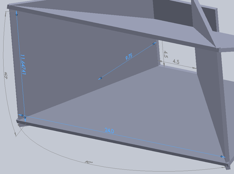

I made a 3D model of the midrange horn in SolidWorks:
index.php?t=getfile&id=1474&private=0
I settled the angles at 90x40deg and the horn mouth width to 24".
That makes the mouth around 11.65" high not 12" and the inside depth is 9.75".
Good enough? Razz
