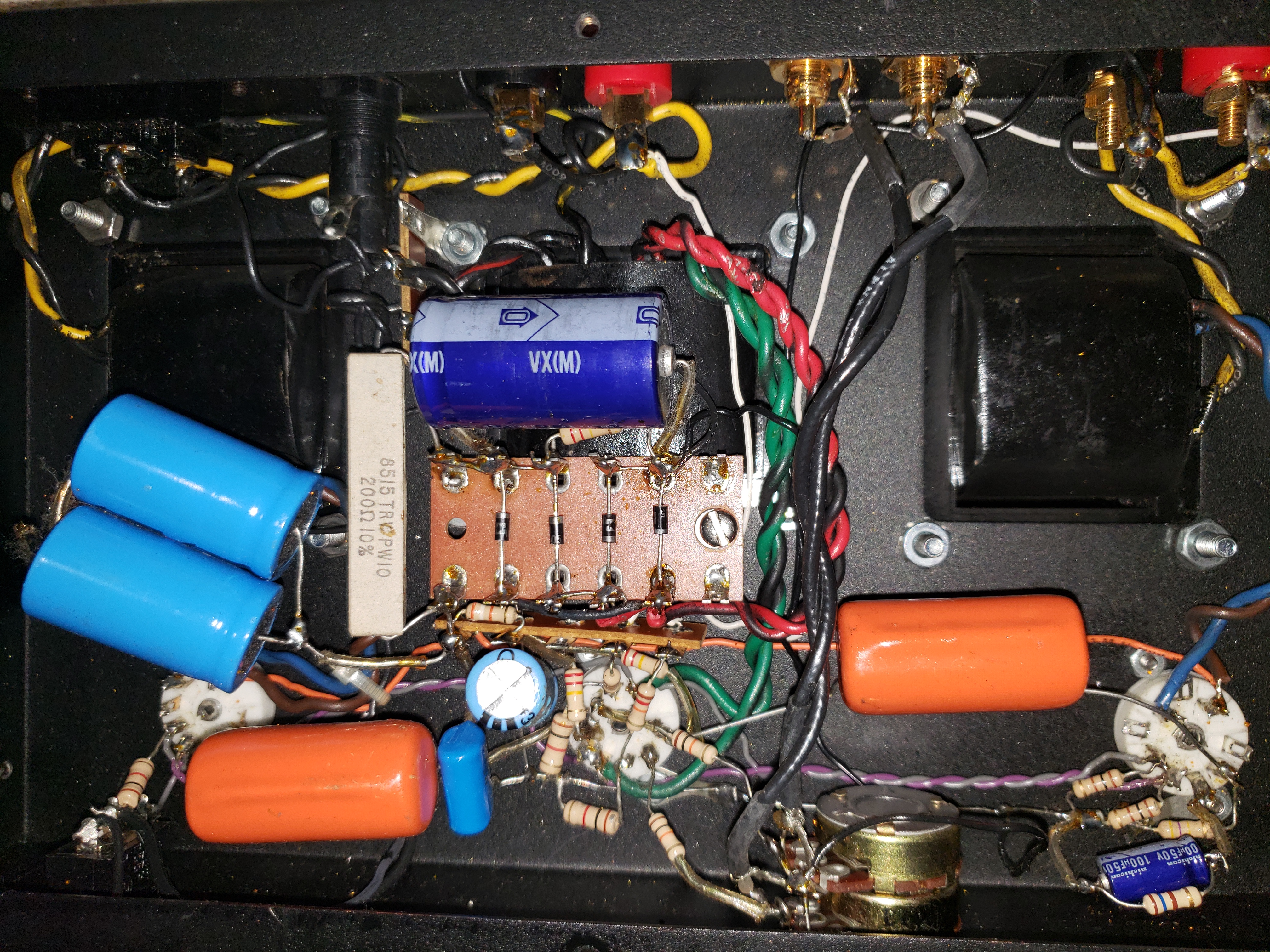

Hello, I have an ASUSA K2003 amplifier from the early 2000's. I'm not the original owner, and never obtained the documents or schematic.
There were some posts here about 20 years ago regarding this little amp. I'm hoping someone hanging out here might have some information to share.
It sounds great, but the tube sockets are getting loose and intermittent, I'd like to replace them and give it a general health check, but I have nothing to go by. I'm an amateur enthusiast, but I can solder just fine.
Thanks for any help
/forum/index.php?t=getfile&id=3359&private=0
/forum/index.php?t=getfile&id=3360&private=0

Thanks for the responses. I've found suitable socket replacements, I just wanted the schematic to double check the previous work, since these came in kit form. The really loose right channel is distorted and does clean up a bit when the tube is manipulated for better connectivity.
I've tried the things on your socket list already. Nothing has helped so far, the socket is really worn out. I have tube savers coming tomorrow to try, that'll be my last ditch effort. Tubes pins are clean/ brand new. Sockets cleaned with contact cleaner and look brand new on the surface. They're just way too loose, I can't get them tight enough with any pin, pick, or object, unfortunately.
