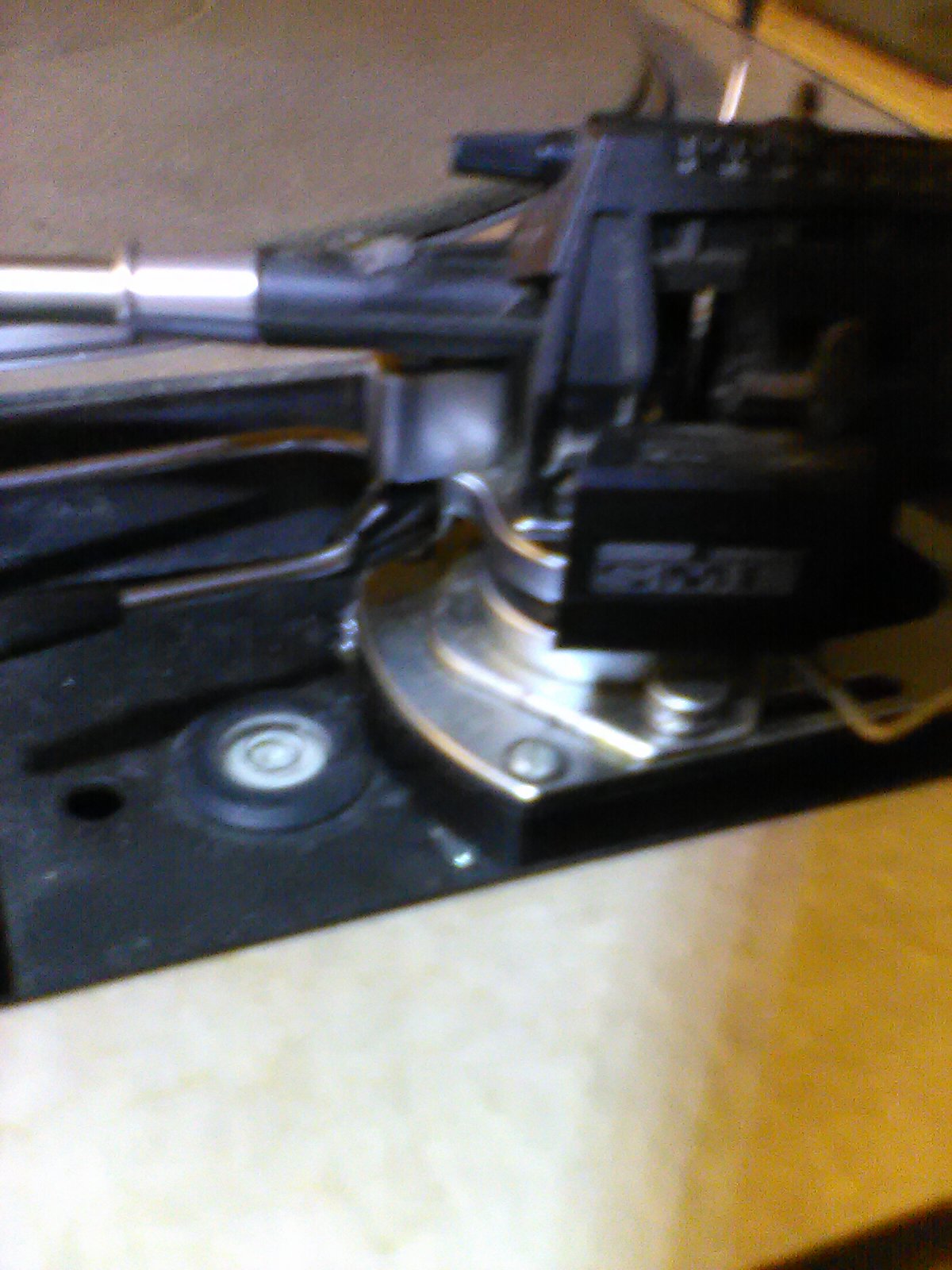

Attached are photos of the SME Protractor I purchased, Top view of base,
and bottom view of base.
What I found was that the sme arm base is maximum forward, the gears also
have the arm as forward as possible and the cartridge looks perpendicular
to the LP. Maybe 1 or 2 degrees off.
More thoughts appreciated. pos
